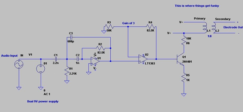

Ok thanks, makes sense. Referring to sticky https://www.electro-tech-online.com/threads/basic-opamp-circuits.35258/, I am trying to build a single supply inverting circuit to coincide with the second stage of attached schematic. The first stage is inverting hi pass, while second stage is non-inverting signal amplification. In trying to build single power supply, am I correct using inverting rail of 2nd stage?

I see several problems. The signal from the first stage swings symmetrically both above and below ground. Your second stage and the transistor is referenced to ground, so will turn on only for the positive half cycles of the filtered signal. Is that what you are trying to do?
What is B1 supposed to be?
Why are both sides to the transformer primary shorted to V+?
Missing power supply connections on both opamps?
The negative swing of the opamp exceeds the max allowed emitter-base voltage of 6V causing the emitter-base to have avalanche breakdown with slow damage occuring.

Ok, here's a more updated schematic. The first stage atenuates anything below 12KHz from input audio, so I'm not sure what is meant by 'swings symmetrically' - this is in fact what I anticipated. The second stage is a non inverted amplification of filtered signal. Because the current was not strong enough, I added a LM386 Audio Amp directly after 2nd stage. Measuring the signal on output of 386 yields a very narrow width inverted pulse, which is exactly what is needed, and that is fed into left primary of transformer. Now with the right primary, through sheer trial and error, I was able to get the desired dc bias(not 100%) with a capacitor connected to 2N collector.
That being said, I thought I could hook a single power supply to non-inverted input of 2nd op amp(basically the feed from stage one). Is this possible, or should I use one of the remaining two op amps to create single power supply?

The opamps are not powered.
The "bipolar" power supply connects both negative terminals to the audio input source and one positive terminal connects to the LM386.
The power supply does not connect to ground so the LM386 also is not powered.
The negative power supply is shown backwards and connects to nothing.
The positive and negative power supplies have no voltage so they are useless.

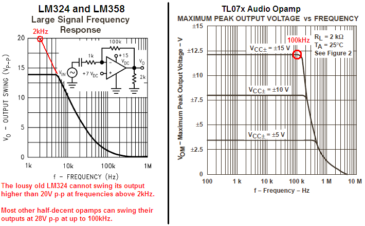

The lousy old LM324 opamp has trouble above only 2kHz.
The transistor does nothing.
The diode shorts half the signal from the LM386.

The highpass filter has a cutoff at 12kHz so it needs an opamp that works well up to 100kHz. But the lousy old LM324 has trouble above 2kHz as shown on its datasheet.

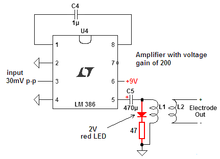

Trying to hook an LED in this circuit and find it saps output current noticeably. The circuit that I'm trying to mimic has one side of LED getting signal from pulse signal from transistor collector, while other side receives V+ signal from source. There is also a forward threshold diode directly after V+ connection. Is this something I can leverage to make the LED work without losing current?
The collector of the transistor has a capacitor to ground so it does not have a signal.
The base and emitter of the transistor connect to nothing so the transistor does nothing.
The diode short circuits the output of the LM386 amplifier.
Make the circuit like this:
Amazing audioguru- this design you suggested is producing the intended DC/AC configuration on transformer. I only added a jumper from voltage source to left primary and this somehow maintains a DC 5V on left side.The LED, with its forward threshold characteristics must be acting as some sort of buffer in this instance.

The output impedance of the LM386 amplifier is extremely low like all modern amplifiers, maybe 0.04 ohms so the LED has no effect on its output.
