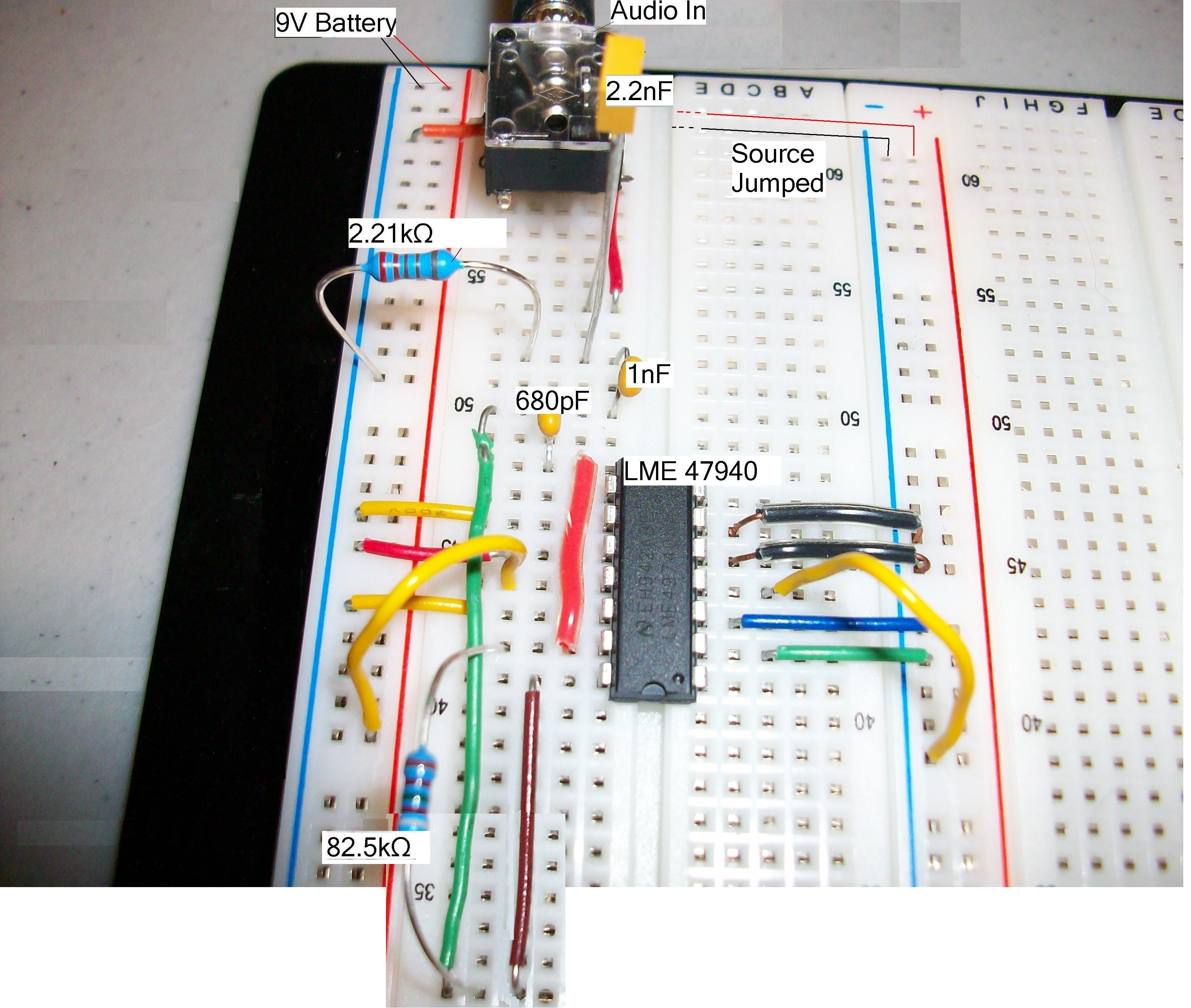

Well, I'm in a bit of a quandry: I tried my best to follow the 2pole MFB High Pass design, but was getting a low signal. The 9V single source I was using measured 6.7V with multimeter. Before trying to add a second power source, as suggested, I tried a fresh(9.4V) and the OpAmp heated up tremendously within seconds(my olfactory has become well acustomed to the scent of fried semicondutors). Strangely, the 6.7V was not producing any heat in the OpAmp. I thought it best to stop and upload a photo of the circuit, that I thought I correctly configured according to Chebychev design.

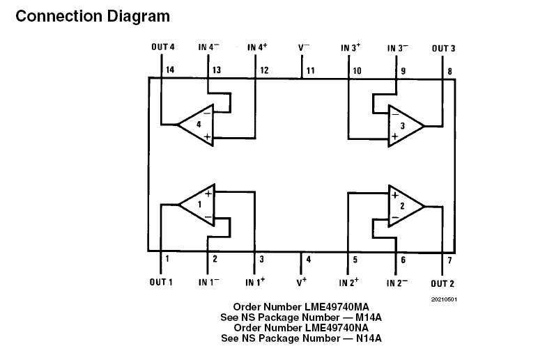

Pin 4 of the opamp should be connected to the positive pole of the first 9V battery, while pin 11 should be connected to the negative pole of the second 9V battery.
Connect the negative pole of the first battery to audio ground, connect the positive pole of the second battery to audio ground.
You probably cooked the opamp, as you appear to have the single battery connected backwards.

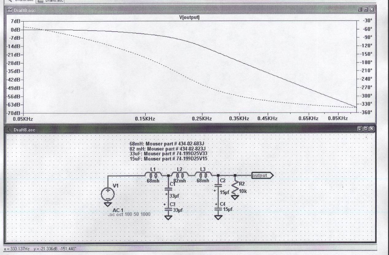

In the meantime, I'd like to build a passive hi pass filter using the utility on Butterworth Tee LC High Pass Filter Calculator -which calculates cap/inductor ratings for given frequency. Incidentally, why does every text book example of high/low pass show Resistor/Cap configuration, when in reality inductor/cap combinations are the only thing I've gotten to work? The RC combinations I've tried simply attenuate entire audio signal. That being stated, the above reference site has a field 'number or components'. This seems arbitrary; what would be the optimal number of components for a 17KHz hi pass? When I built the passive low pass filter(https://www.electro-tech-online.com/attachments/200_hz_lowpass-jpg.3678/), the schematic called for 4 caps and 3 inductors. Given the proper values, could I simply reverse the order for hi pass?

Passive RC combinations work, they just don't work as well as an LC or Active RC filters.(Passive RCs have slower rolloff)
The number of components is not arbitrary, it determines the steepness of the rolloff outside the passband. Every LC pair will increase the rolloff by 12dB/octave in a properly designed filter. So the "optimal number" depends upon how rapid a rolloff you want.
You could reverse the L and Cs to get a high pass, but I'm not sure how well that works.

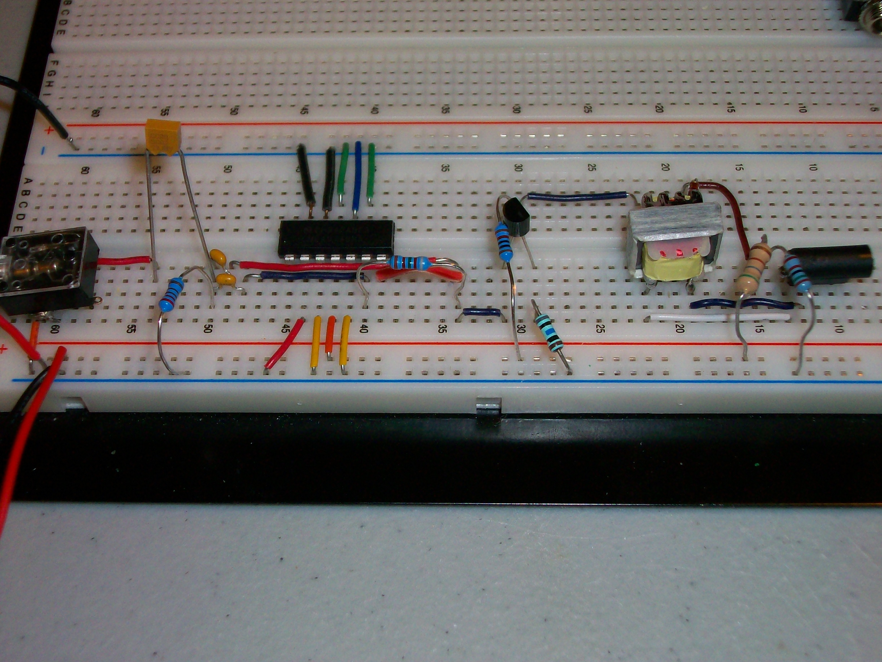

MikeML-am trying to boost op amp output by 1 V(PP). In current design, the output voltage sometimes dips below .6V threshold and not every pulse is being picked up by transistor. Using the filter pro software, I cannot replicate component specs in Chevychase:) design you provided-most are within ballpark but 82.5Kohm resistor is significantly higher than anything filter pro suggests. What is the PSpice version/name-I think I should acquire it?

You never answered to my satisfaction what the filter is driving. I dont have the time or patience to try to trace out the schematic from your photo. Post a schematic.
If you need to raise the gain, then leave the filter alone, and use one of the unused opamp sections to create the extra gain. I'm still puzzled why you need a transfromer; you never explained that, you never explained how it is connected to the output of the opamp.

Outputting from op amp is an AC signal apx 18KHz ranging .5V-1.2V into transistor which inverts and ups the voltage to 7V. It then goes into left primary of transformer(right primary is DC 6V). The transformer is used to step up voltage to electrodes which will be connected to skin. Sort of like feeling the music. Without transformer the voltage is too low. I will draft a schematic this afternoon.

Why are you putting DC into a transformer winding? A transformer is used with AC, never with DC. DC might cause the core to saturate then it is not a transformer anymore, it is just a piece of wire.
Well, I'll put in appropriate resistance such that it outputs 40mA tops. AND it's only for my use, I'm not strapping this up to folks. An experimental idea that's all. But from o-scope readings, it shows a commercial unit as having DC current of 5V on one side of transformer and AC 6V on other. I cannot replicate this functionality; the DC simply creeps onto both sides of transformer. Any idea as to how the commercial unit's transformer holds each signal independently?

You can have DC on one side of a transformer primary if the other side of the primary is periodically switched to ground, which forms a flyback type inverter circuit. That type of inverter is typically used to achieve high secondary voltages.
Without a schematic then we are just guessing but it sounds like one winding has DC all the time which is not proper.
Then a second winding has AC audio.
