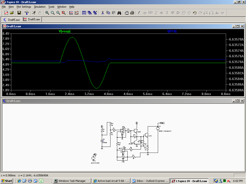

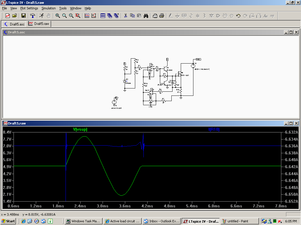

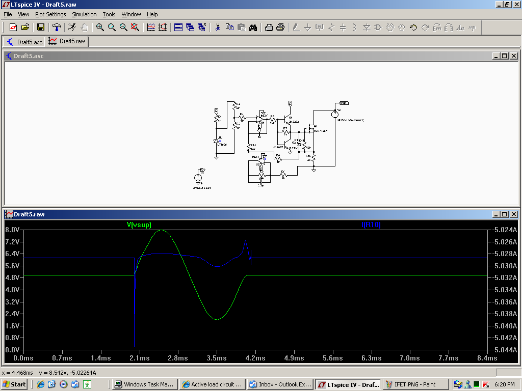

I think what he was talking about was bypassing IC2A as shown in my igain picture. When you do this you also need to change the adjustment pot because the gain of the circuit is different. (See pot settings between i gain and IFET pictures) When I simulate it it "acts" better with a transistor (2N3055) in place of the FET, but if you do this the BC550 that you would like to use is to small. See picture ITX.
The schematic did not say the size of the 5 watt resistor. I used .5 ohms (which is probably to big) so you can measure voltage at the top of that resistor but it will be very small. If you keep IC2A you can measure pin 1 and it will be higher voltage because of the gain. If your supply has high voltage or high current you will need big heatsinks for either the FET or transistor. Lets say 5 volt supply at 5 amps.. 25 watts.
If you use a higher voltage for the reference or if you remove IC2A you might want to limit the maximum current by adding a resistor to the top of the adjustment pot so the current can't be adjusted to high.

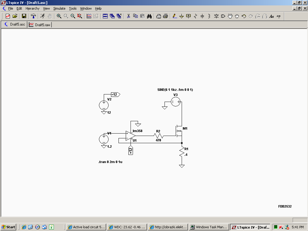

I was talking with the author of this project again and here's what we managed to do:
It's quite simple but I think it will work. I've done some simulations and it looks promising.
I want to use IRFP260 because I've got some of those from ATX PSU.
The other thing is that I have everything from this schematic.
What do You think about it?

Actually I think you can simplify it even one more step by taking out the transistors. They just follow the op amp. Maybe the circuit was a transistor before so it needed more current from the transistors.
The .4 ohm determines the current. .4 volts per amp across it. So with a maximum reference voltage of 1.2 volts the maximum load is 3 amps. So to adjust you can set the positive input to the op amp using .4 volts = 1 amp.
I think the circuit will work ok.
What is it you want the project to do? It will provide a constant dc load to a power supply while you vary the supply voltage.
