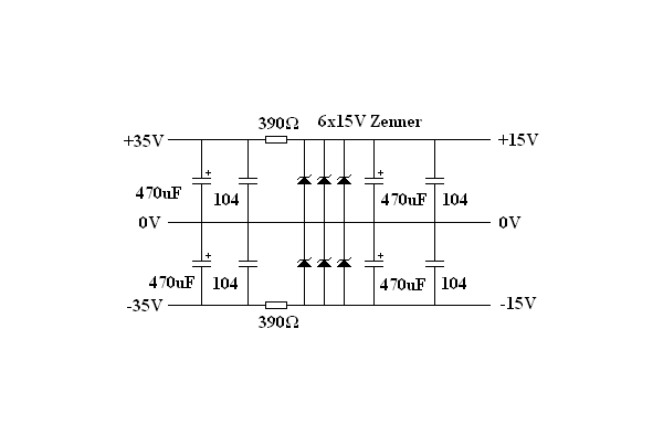

Power supply for transistors preamps must be much cleaner (free hum and noise) than for opamp, so I need to use voltage regulators. IC regulator make the circuit bigger and more expensive, and each preamp will not consume over 10mA current so I decide to use zenner diode. Will the circuit below work well??? (for 3 preamps)
Hi Nikolai,
Nice decoupling, but not sure what the 6 x 15V Zeners will do (have I misunderstood your schematic). Go for voltage regulators, which would be much much better. You can get 100mA regulators which are small and cheap- sorry. :facepalm:
