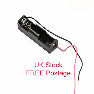

Are they NiCd or NIMH? - NiCd suffered from 'memory effect', NiMH supposedly don't.
However, people seem to have exaggerated ideas of battery life, a core part of our business is replacing NiMh (and Li-Ion) batteries in various professional equipment, in all case where the charging is controlled by specialist charging IC's.
As long as it's a proper "intelligent" charger, you do not need to discharge before recharging.
However, lightly used nickel based batteries do suffer from memory effect - including some NiMH types, in my experience.
The "fix" is to totally discharge them in something that does not shut down - eg. a small torch/flashlight that uses a filament bulb (not LED).
It must be done to each cell separately, to avoid damage to other cells.

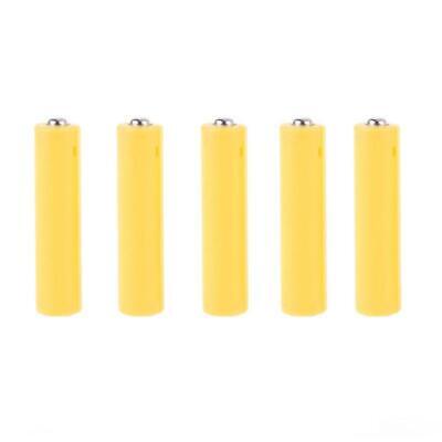

If you cannot find a single cell torch, use a two cell with a single rechargeable and a dummy cell.
Leave it turned on for several days or even a week, for each cell. Then recharge them all and the capacity should have improved.
Example dummy cells; plastic spacers with contacts to complete the circuit through them:
Or you can use AA cell holders with a ten ohm half watt resistor connected directly across each holder.

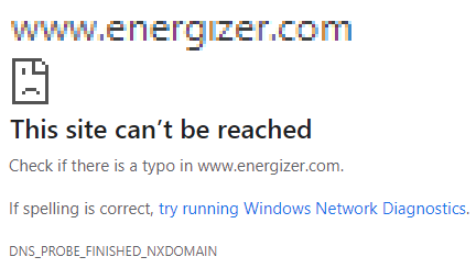

I cannot reach energizer.com on Microsoft Bing, Google Chrome and Opera browsers. The problem is listed on Google and I tried Reset Dns and Renew Dns steps then Restart which did not fix it.

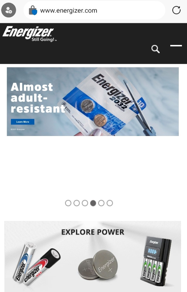

It pops up a fraction of a second after I click return here in the US.
Maybe assuming Energizer was out of business wasn't a reasonable first thought?
It's fine from the UK as well.

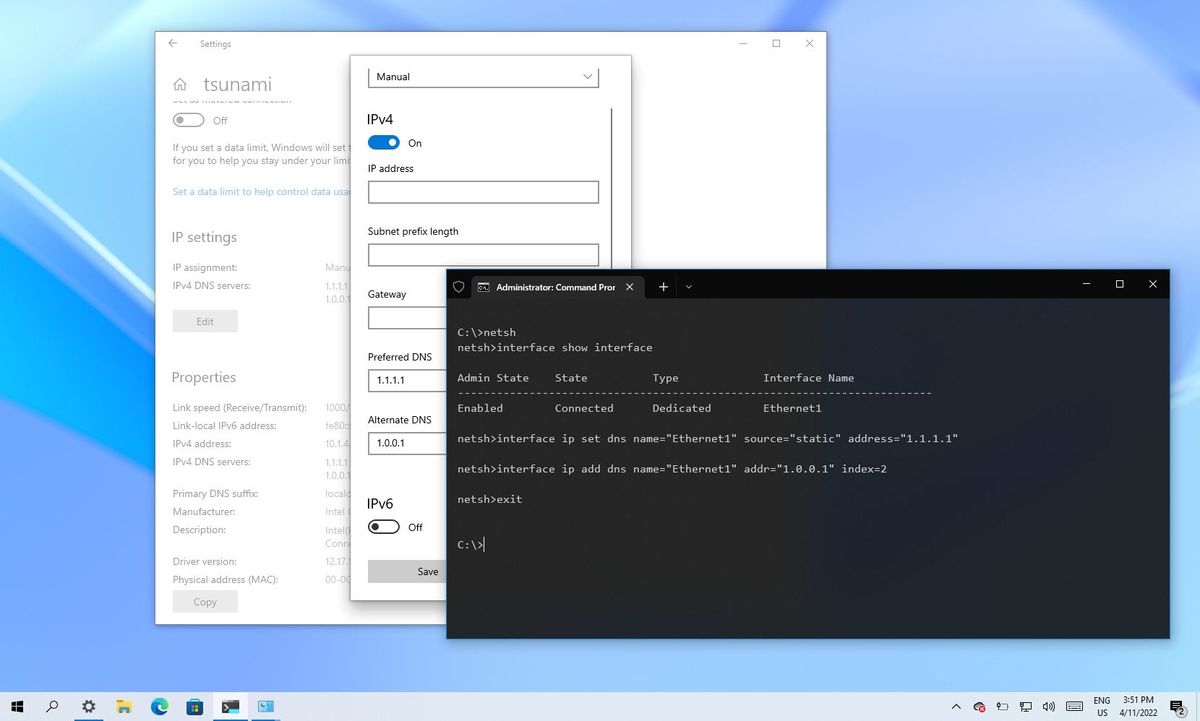

Change your DNS to manual and use 8.8.8.8 & 8.8.4.4
That will probably get things working properly.
A lot of ISPs have been having erratic DNS problems for the last few years, with parts of the internet vanishing and reappearing from DNS lookups.
I think this is may be down to a gradual changeover to secure / encrypted DNS protocols & things getting messed up in the process?
There are several different system standards.
and others.
Where is and how do I change DNS settings?

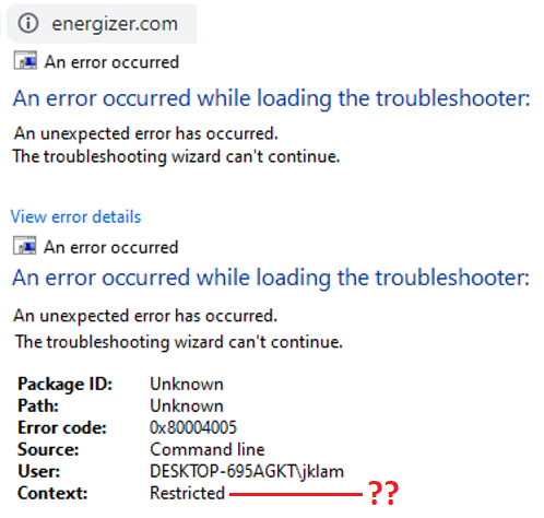

www.energizer.com and www.energizer.ca are the only websites that I cannot reach using a few different browsers.
Looking at the problem in Google, Microsoft says to "check for the latest updates". I did and my Microsoft updates are up-to-date. Maybe the latest Microsoft update causes my problem?
Here is what happens:

I cleared "browsing data" from Bing and Chrome browsers. I still cannot reach Energizer on Bing and Chrome.
YEA! I switched my Opera Browser from DNS to HTTPS and now it and Bing can go to Energizer's website.
When I click on Google Chrome browser I get Bing browser instead but it does not matter since it works.
