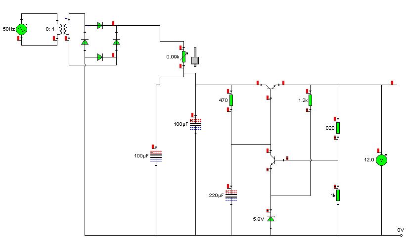

Here is the circuit that I want to build it has to an input of 240vac from the mains and the output must be around 12 volts, criticism welcome.
well i dont think that you can get such great current due tu the 89 ohm resistor.....
and....why did you put the 220u capcitor and the resistor in series with it...i dont think that will give you more regulation.....

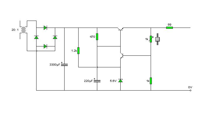

POWER-U:
Glad to see you got it posted ok.
i hope my poem helped.
I'm still not too happy with this circuit yet.
I'm thinking it over.
You say you want an output of 'around 12 volts'
Well this LOOKS like someone has tried to do a circuit thats
a very tightly regulated supply, but it doesn't look right.
Having a reference voltage on the 108 base,
doesn't look to me like it would regulate the BFY51.
Do you want a regulated supply?
Or do you want 'around 12 volts'
The variable 1k would vary the output,
but it doesn't look like a very good way.
If its a regulated supply that you want to build yourself,
then the bridge rectifier looks right, the 3300 cap is ok,
the BFY51 is a medium power transistor, max 1 amp, 30 to
40 volt working, gain about 25 to 30.
A poor choice for a supply regulator.
I would recommend a 3055, or similar.
Maybe this is for a special job....
Why is the 89 ohm in there?
if its to sense current then the 1k might be for that?
Can you get different components?
Could you explain what you want from this?
Regards, John

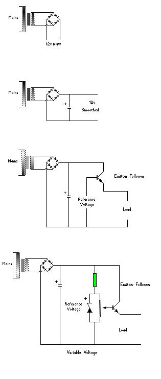

Hi power-u,
Here's the basic layouts.
Most refinements are based on these skeletons.
Regards, John

I reckon your second circuit diagram (power2.JPG) will work OK.
I reckon you can adjust its output from about 6v to a shade over 12v as the 1k variable is adjusted from min to max resistance.
The 89 Ohm resistor on the output is a strange device - what is it supposed to do?
If it is current limiting I think you should move it to immediately after the rectifier so the regulator's work isn't undone by it. (it's still weird though !).
For the mains transformer I don't understand why you are trying to design one when an "off-the-shelf" unit will do the job quicker, cheaper and probably safer.
I think the 20:1 ratio is wrong given that you will be wasting excess voltage across the series-pass transistor, you HAVE to allow some volts-drop here, that's how they work.
You need 14v (ish) or more from the transformer, the other oversight (which contadicts what I just said) is that the transformer's output will be rms voltage, after the rectifier and smoothing cap it will be nearer peak voltage (rms * 1.4) dedepending on current loading and transformer impedance. This will define how much the smoothing cap will 'droop' between mains peaks recharging it, the lowest voltage produced here is the most likely point of you losing regulation.

Thanks again John1. I just sorted the circuit out and found that the 89 ohms resistor should be connected between the output lines.
This is my 3rd diagram I know but I have had to make mad improvments Espically to the regulation. So comments on this one please. The VR is there because C1 usually blows up after connecting the 240v.
Have You measured the secondary AC voltage? The condenser nominal voltage is 2 x AC voltage.
