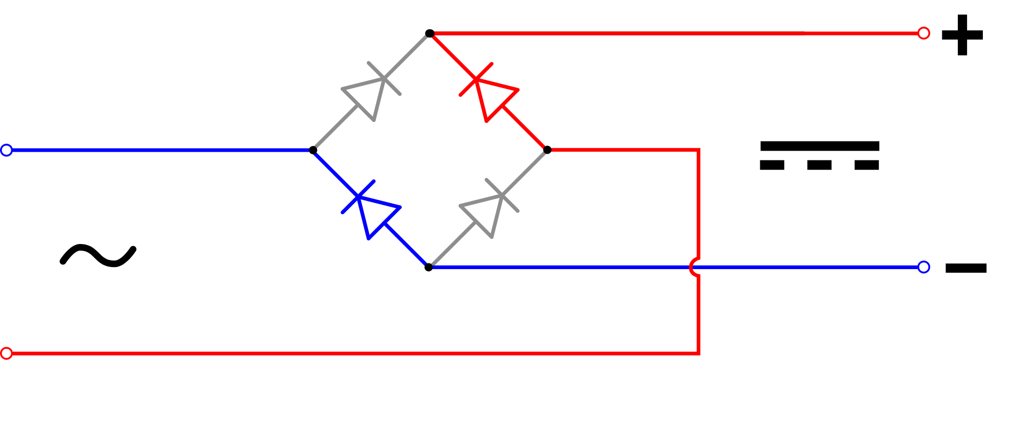

The motor is from a treadmill. I wanted to use it to make a tumbler for brass cleaning. The information above is all I have on it. Not sure of the age, probably no more than 8-10 years. Is this what I'm looking for?
You can't connect it to an AC supply as it says DC on the label. I suspect that it is a permanent magnet motor. If so and you connect it to AC yoy will probably demagnetise the magnets. This link to "KBLC" may help as they make speed controllers for DC motors.
That is a bridge but connecting that directly to your 120v AC mains will give you 170 volts DC if you filter the output to make DC. Without filters, you will get a rectified AC signal (a series of camel humps with 170 v leaks. See above: don't connect your mains power to a bridge rectifier. Use a transformer, or, better, buy a pre-built power supply.
The motor will not survive the 170 V from rectified mains.
You don't know what the motor will survive, or have you seen the data sheet? 170V camel humps as you call it is 120V RMS which is not that far from 90V DC. If you look at other data sheets for similar motors on the Johnson site you will see that the motors have quite a wide input voltage range. By the way, by the time you have taken into account the VF of the bridge the peak voltage of the humps will be 168V.
It is quite common to use a DC motor with camel humps.

Wouldn't the DC motor vibrate like crazy when running on low frequency camel humps? The motor will probably also smell as bad and make as much noise as a camel.
Quite possibly- we do not know. On the other hand, the inductance of the motor may just integrate the whole thing out. A capacitor might also help. The scientific approach would have been to get the data sheet for the motor and to contact Johnson to find out what can be done. That would also include the safety aspects. This thread is now closed anyway because the OP has, very wisely, decided to investigate an alternative approach.

Just a couple of points. It is quite common for speed controllers for permanent magnet motors to use raw rectified AC. (I.E. No reservoir capacitor.) The speed control is achieved using phase angle control or PWM. the phase angle control is normaly done using two diodes and two SCRs in a bridge. The 90 volt motor is about right for use with a speed controller running from 120 volt mains. The motor on my Seig x3 milling machine is rated at 180 volts and has a speed controller running from 240 volt mains. This is the schematic of the speed controller on my X3. The other point is that I think a tumbler would be a machine that is left running for many hours so a brushed motor would require the brushes changing often. I think a three phase induction motor in conjunction with a VFD (Variable frequency drive.) would be a better solution. I agree with the warning about someone that does not know what they are doing playing round with high voltage.

Just a couple of points a DC motor has AC in its coils- that is what a commutator is for. The original motor was 90V DC which is a dangerous voltage anyway so I can't understand all these so called worries about rectified 120V are all about. I am not suggesting that the OP have any live wires exposed anyway.
Yes, that is my point. I am concerned because you do not understand the benefit that comes with isolation from a transformer when dealing with mains power.
As for the commutation, listen to Audioguru - you will have lots of vibration if you commutation does not match the frequency of your 120Hz rectified AC.
A large flywheel can smoothen the vibration, but half-wave rectification of 120Vac is around 90Vdc avg.
An SCR can give variable speed with current handling for start surge.
Pulley speed reduction will be necessary to reduce the 5700 RPM down to desired tumble rate.
