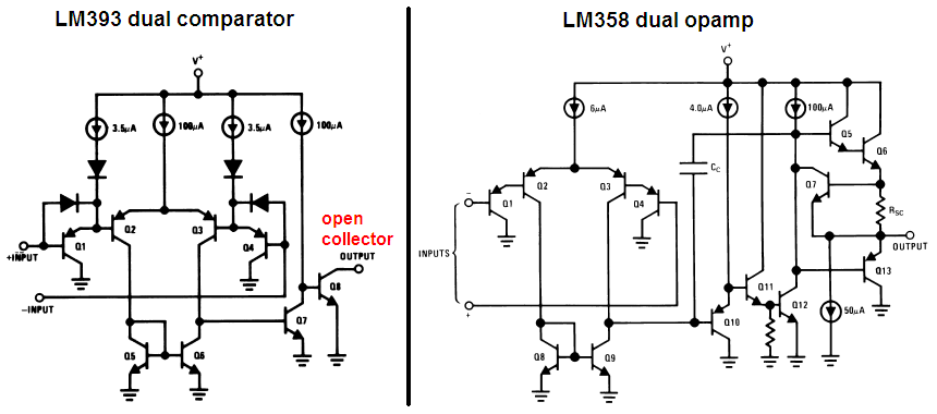

audioguru said:
Of course an opamp can be used for a slow comparator, but its output isn't an open collector.
Hi
Need to clarify with you, what do you mean by the output isn't an open collector. :confused:
fstspec said:
A comparator has the collector of an NPN transistor for its output so that other comparator outputs can be joined together to make a NOR gate.
An opamp has an entire push-pull output stage that cannot be joined with another.
