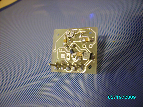

I have now ordered 1206 resistors.
on the photo you see one 0805 turned by 90 degree's-
but it's a perfect electrical connecition.
what is really messy are the half-size SMD diodes.
now the next revision will again use conventional parts, maybe retain pads for 100nF SMD capacitors, but trimmer resistor will be conventional.
the SMD parts requires a bit of exact size.
well uhm the PCB is not self-made, i got them for 23 cents each.
