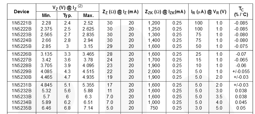

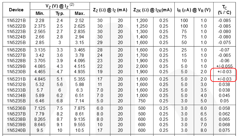

I like the 5.1 and 4.7 Zener. +/- 0.03%/C

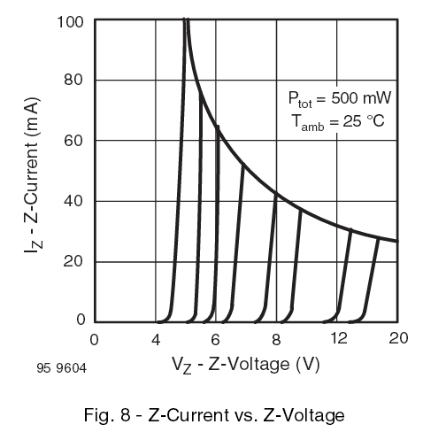

I must not understand what Mr. Rogers said. I can not see how a small change in the resistor will effect the voltage (much). The left hand two curves are for the 4.7 and 5.1 Zener. A 1% change in resistor will cause a 1% change in current and maybe a 0.1% in voltage.
It is hard to find a data sheet on a old 5% resistor (through home). The first one I found has 500ppm/C.
I went back and found a data sheet from 1950 showing a CC resistor with 0.2%/C temp. A Carbon Comp resistor should never be used where you care about temperature. LOL So a resistor change of 0.2% could cause a voltage change of about 0.02%.
