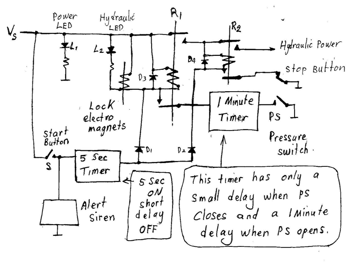

I'm looking for some kind of circuit that will alert a user that there is Hydraulic power being supplied around a system and prevent the opening of any guarding to a machine. Once the Hydaulic power has been stopped a safety time-out will only allow access after 1 minute.

Basically what I need is:
LED to indicate overall system power
LED to indicate Hydraulic pressure/flow is present (therefore electronically locking the mechanical door interlocks)
Once Hydraulic power has been terminated, timer starts and after 1 minute releases the locks on the guard interlocks allowing access to the machine.
Hydraulic power cannot start backup until all interlocks are closed.
On restarting Hydraulic power, switch has to be held for 5 seconds (at the same time sounding an alert siren to alert the potential danger) before the Hydraulic system powers back up.
My situation is this - I am a Modern Apprentice who has been given a project by my boss in conjunction with my college to come up with this. I am mainly mechanical but do have an ONC in Electronics so I have a basic understanding. I am a bit out of my depth on this one though but really want to put the effort in on this to produce the goods and pass my HNC. If someone is able to produce/point me in the direction of something like this I would be eternally grateful.
The circuit doesn't have to have massive detail and an LED placed in the circuit to indicate that the Hydraulic pump is pumping oil around the system will more than suffice in this situation.
This circuit does not have to be uilt, only simulated. All I need to prove is functionality not practicality.
All circuit states ie interlocks locked/unlocked can therefore be represented by different colour LED's etc.
Please can someone help me. I'm desperate for help on this :(

Here is the basic idea for you.
When power is applied, L1 glows. When S is pressed, the siren sounds, R1 operates after 5 sec, the Lock electromagnets are energised and L2 glows.
R1 operates R2 which holds to the Stop Switch via its lower contact. R1 & R2 apply power to the hydraulic system. When the hydraulic pressure has built up, PS closes and provides a hold path for R1 via the 1 minute timer.
S can now be released.
When the stop switch is pressed, R2 releases and when the pressure drops, PS goes open, starts the 1 min timer.
After 1 min, R1 is released and the electromagnets are de-energised.
Edit. I accidentally drew D1 & D2 the wrong way around. They should point downwards.

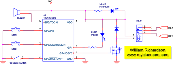

I would use a uC for it. Block diagram the microcontroller (inputs and outputs) and flow chart the software.
Tie it into ljcox's diagram..
Russlk said:
Very nice, Bill. I am sure you realize by now that LED2 should be connected to pin 2 of the relay!
We've all been there :lol:
It's actually a bad choice of location, a better place would have been between the other LED and the diode across the relay - where it would have automatically been easy to connect properly.
I suspect that LED was added afterwards, which is why it went wrong?.
