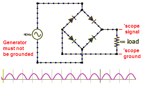

Diode rectifier on scope questions...
I have been playing with this java based circuit sim and was studying the "full wave diode rectifier"
So I made this diode rectifier from a 9V AC wallwart.
The scopes in the program show a nice AC sine wave and a nice full rectified wave on DC.
I really wanted make my scope of use and test it out. I just cant get it to act the same.
The first thing I did was set the scope to 2 channels. I put channel 1 as AC and hooked it to the top junction. Then I put channel 2 as DC and put it on the right hand junction (DC+). Where do I put ground?

Hey Bruce, it looke like u're workin pretty good on this. ur circuit is right. First of all u need to connect a resistive load just like in the program's picture around 1Kohm load or watever. connect one probe across on the right terminal of the load and the ground across the left terminal, i belive u'll get a full rectified signal. the position of the ground is very important in an oscilliscope because it measures the voltage between the probe and the ground and in this experiement u need the voltage acorss a load.

Why did you start this new thread and duplicate your other thread?
Connect the 'scope like this to view the full-wave rectified waveform.
The 'scope must be connected differently to view the AC waveform.

Well I hooked it up the way you said. Looks like you were right. So I see the full wave rectified wave on channel 1!!! Thanks so much....but
A new question arose, the AC sine wave is acting weird?!?
look at the pics.
Half of the bottom wave (Ch.2) is disappearing. And, if I hook the ground (on channel 2) it sparks... and messes up the other wave also (the last pic). So I left the ground out of the Ch2 Probe. I can hook them in the same spot (both grounds) but nothing changes.

You may think the scope as being a pair of voltmeters, but with both black leads joined together (tose black leads are the scope's ground).
A bridge rectifier has no "common ground" between the AC and the DC sides.
So you can't look at both the AC and DC waves at the same time with the same scope, unless you have a 4 channel scope or a differential probe.
With a 4 channel scope you use channel 1 and channel 2 to measure the AC sides (just both sides, no ground) and adjust the scope to display the difference between them (1-2). Then channel 3 is free to meassure the DC side, putting the scope's ground at the DC ground (minus).
A differential probe accesory (rather pricey and so not a common thing) has two input probes and one output that connects to a single scope's channel, displaying the diference between both inputs.

Thank you audioguru that was exactly the issue :)
