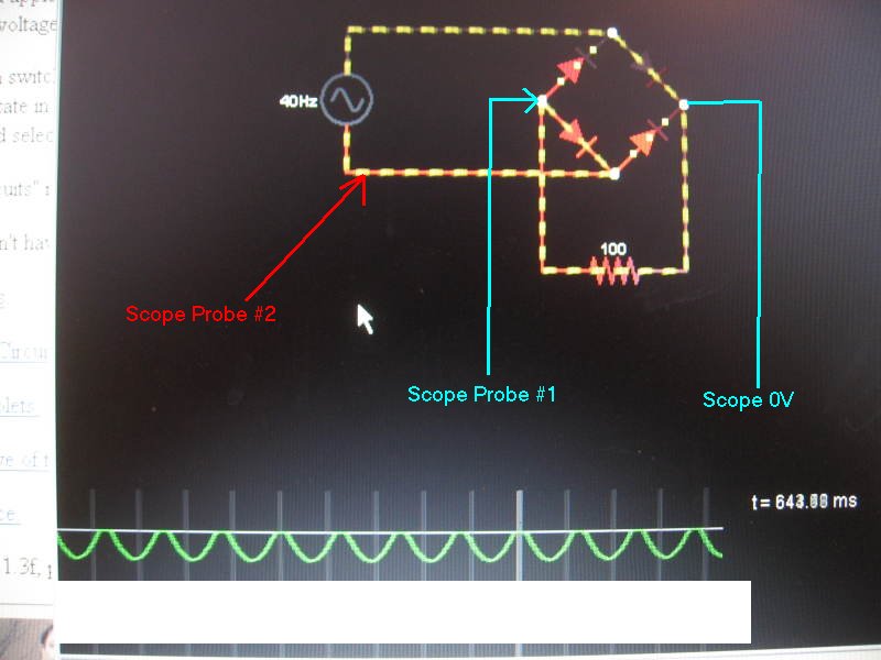

This is what I am trying to emulate...

I also uploaded a new picture of this awsome free program that is helping me understand electronics. And I am trying to emulate the scope on the program.
This is how would expect the connections.
You should get the neg going fullwave on #1 and a sine wave on #2

I have relooked at all your pictures, its puzzling?
I assume the probes are set to divide by 10.
Disconnect the scope and use your DMM to measure the ac into the bridge and the fullwave rectified voltage on the output of the bridge.??
