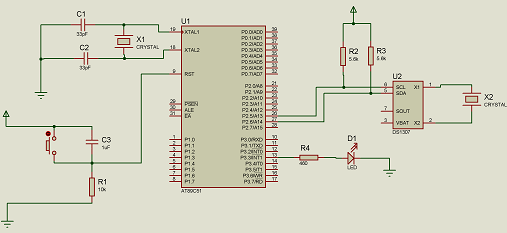

hello,
I am making design on proteus software. I am interfacing RTC with 8051 and LED
my task
turn on LED for 30 second
turn off lED for 1 minute
turn off LED for 1 Hours
turn off LED for 1 day
How to write c code for minute , day and also check circuit ?
can someone explain with small example
First! Do not use the "RES" model for the SDA and SCL pullups!! The I2C won't work properly... Use the "PULLUP" resistor primitive.... You'll find it in the library.... I have posted ALL the low level C routines... They are for the SDCC compiler so you will have to change the defines to suit your compiler..
You will need a BCD to Binary routine and one to swap back..
BCD to binary
Binary = BCD >> 4 * 10..
Binary += BCD & 0xF..
Binary to BCD
BCD = Binary / 10 << 4..
BCD += Binary % 10..
Or if you are just using the values and not displaying them then just use BCD....

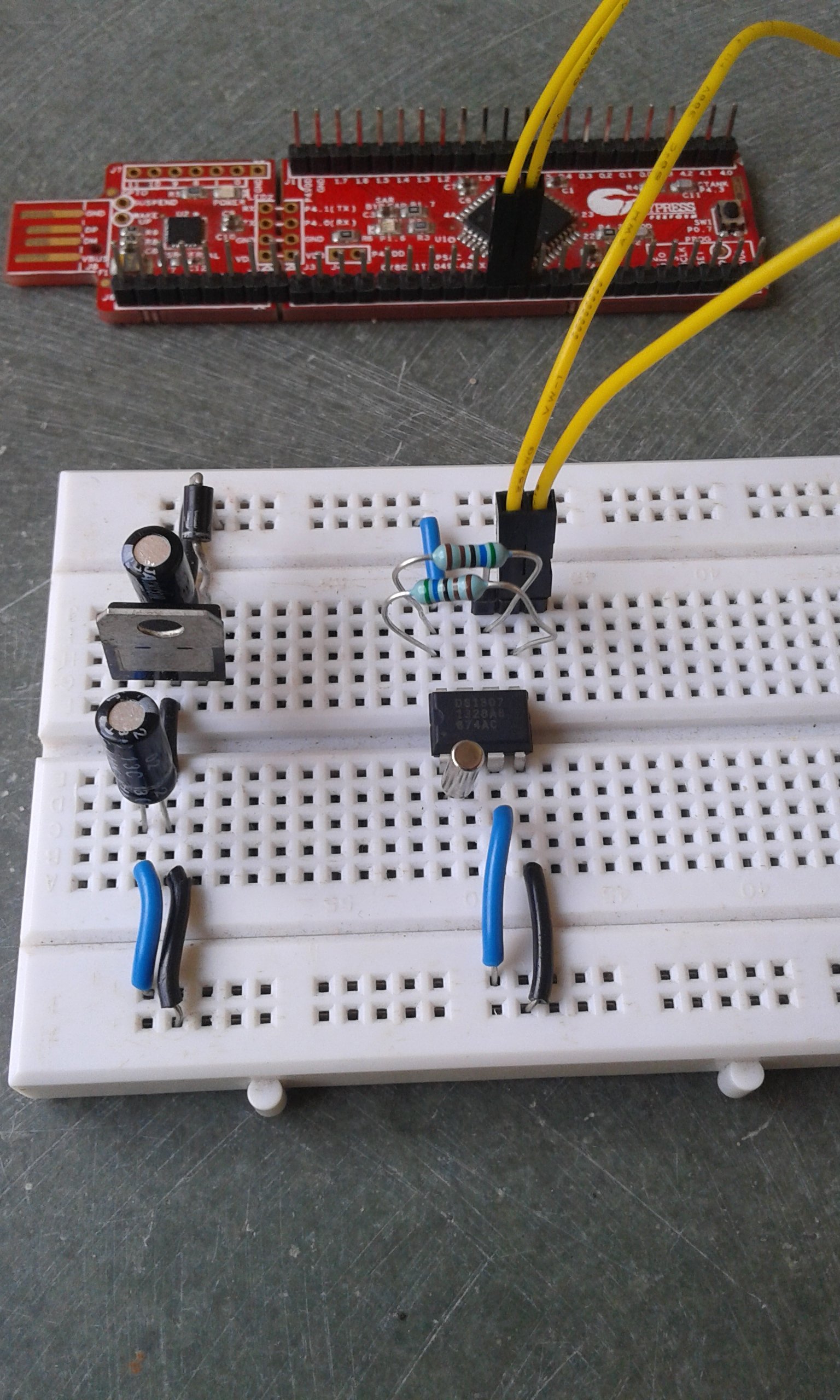

actually I made post #1 just for learning c program
actually I have cy8ckit -049-42xx Psoc 4 prototyping KIt (cortex m0). I only need c code. I did google search, I found all about LCD display. but I need code for LED. I am attaching two pictures
pin 1, 2 connected with crystal
pin 3 connected with 3.3 v battery
pin 4 connected with ground
p3.0 SCL connected with pin 5
p3.1 SDA connected with pin 6
pin 8 connected with vcc

I just create an array called TIME
unsigned char TIME[7];
Then I use the I2C to load the array every cycle. I created two functions to Write to the RTC and Read the RTC
C:
#include <project.h>
#include "i2c.h"
void Readtime(unsigned char* array)
    unsigned int idx, tmp;
   for(idx=0;idx<7;idx++)
      tmp = RtcRead(idx );                   // read RTC
      array[idx] = tmp>>4 *10 + tmp;   // convert to decimal...
void main(void)  //<--- always a void in embedded systems
    while(1)
      Readtime(&TIME[0]);    // Reads the time... &TIME[0] is the address of the array
/*END OF FILE */
Once you have the array
TIME[0] = Seconds
TIME[1] = Minutes
TIME[2] = Hours
TIME[3] = Weekday
TIME[4] = Day
TIME[5] = Month
TIME[6] = Year
TIME[7] = Control
bit 7 of seconds is the on / off
bit 6/7 of the hours is the AM / PM
Control has the square ware output settings ( you can use this as the 1 second interrupt.)
The Ds1307 has the address of 0xD0... Everything on an I2C bus has an address... EEproms are usually 0xA0
