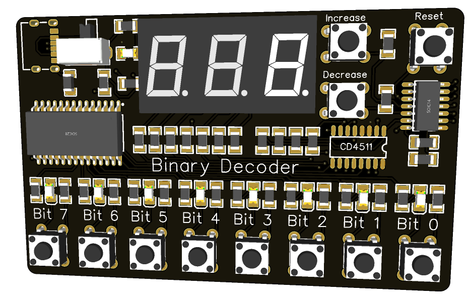

There are these..

There are these..
Thank you for your reply. The bord looks great except that it has so much more than what I need. I was hoping for a board like that where it would simply take the 8 bits binary to display it.
