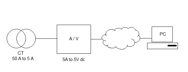

As a matter of fact, this is my workmate project, he is dealing with electrical side of our firm. He thought of a type of Data Logger for the power variations in substations, so that he put a simple block diagram and distribute each task to the concern department ( see attachment ).
My part is to receive the 5vdc output and deliver it to the PC only. He suggested using ADC IC, but as you know, parallel port is not famous for today’s LapTops, and even the RS232, which made USB is the preferred connection.
Know you suggested to use serial/USB converter lead , the PIC as ADC and Nigel’s RS232 board to connect them, which makes it much easier and approachable.
Thanks for all.

Actually I agree as to the use of the old parallel port and RS232 ports. They are going away unless one specifically hunts down a system designed with them included. I have also used USB to RS232 converters but actually think today's new systems being developed should be USB based or similar (like the wireless systems and ethernet). Anyway, looking at what you have before you. There are plenty of inexpensive hardware USB solutions out there.
I have used these very inexpensive devices (actually earlier versions) and looked at several of these devices. The DATAQ DI 145 starter kit at about $29 USD for example gives you 4 differential analog input channels of +/- 10 volts. That being with 10 bit aquisition. They were also offering 12 bit units? Don't know where those went. The nice thing is the basic included software which allows easy data recording and storage for later review. They are also very easy to write your own software for.
So looking at your drawing. I see a 50/5 CT so we get 0 to 50 amps is equal to 0 to 5 amps. I would then run that CT output in a loop through something like this. You now have 0 to 50 amps is equal to 0 to 10 volts, 0 to 5 volts. 4 to 20 mA or just about anything you want for scaling.
The products I mention are just examples and for the better part are pretty common items globally available. I believe I have some pictures on my home computer of some of those items that are set up and configured. In addition to line current(s) it also becomes easy to measure line voltages and plot them with current.
In conclusion I obviously lean towards USB interfaced devices and for the reasons I mentioned.
Ron

Since this is work related, one must consider the cost of design your own vs. buy off the shelf.
Let's break it down.
  • Off the shelf ~ $100.00
Design your own.
  • Research parts: Hours spent x your salary
  • Schematic design: ~40-80 hrs x your salary

I agree and linked to a data acquisition simple 4 channel device with isolated differential channels that runs about $30 US. That includes some really nice logging software and additionally like Mike's suggestion is very easy to roll your own software for. However, it is an off the shelf solution that is also USB.
When I present something I have to do exactly what Mike mentions and unless there is a considerable savings with DIY we buy off the shelf. My billing rate for engineering time exceeds $200 USD an hour.
