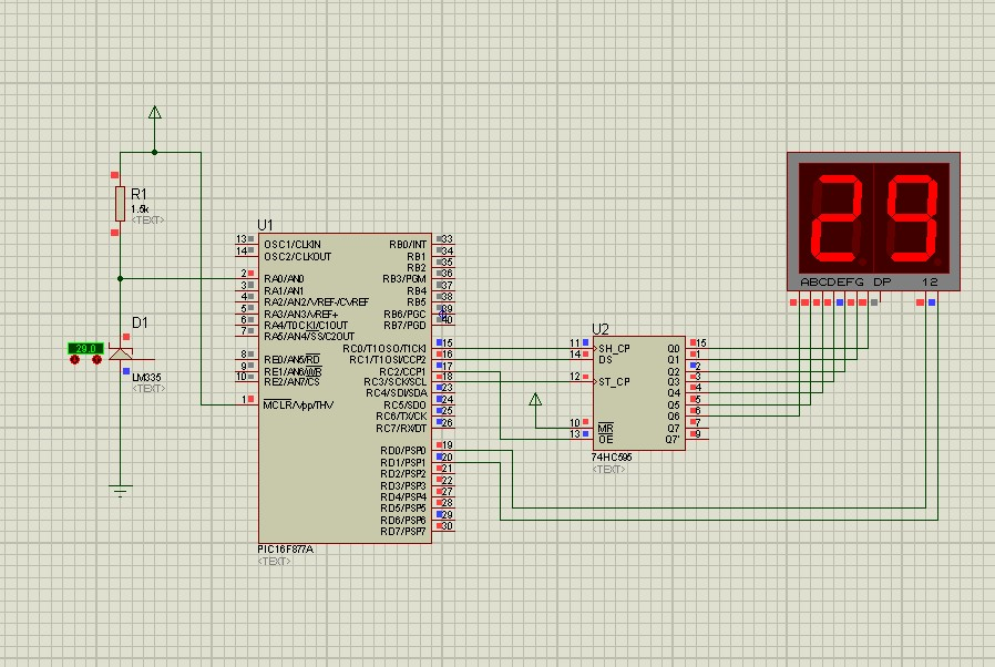

Hi all, I'm Thien, it's my homework but my code is wrong, please check it out :(
Thank you !
Requirement: 7 seg MPX2 CC temperature display using XC8 , PIC 16F877A, LM 335, IC 74HC595
Here is my code, built successful but on LED was not a number o_O
http://pastebin.com/YW911mJp
Proteus simulation
Like I said in your OTHER thread!! ADCvalue must be a long...
voltage = ADCvalue *5000 /1023; If ADCvalue was 512 ( half way ) then 512 * 5000 = 2,560,000 an int can only be up to 65,535 this means you number will be negative before you start processing!!!
The other issue is the display has two "select" pins you can only select one at a time 1 or 2 not both!
I'm sorry, I missed it
My fixed code here: https://pastebin.com/GuHkwaqe
I did change ADCvalue and f to "long" value and change the select pins code

And the circuit!!
Thank you so much , much appreciated
It works but there is an error
LM335 -----LED
51 ------------ 51
52 ------------ 52
53 ------------ 53
54 ------------ 53
55 ------------ 54
Its fine.... Its just tolerance ( rounding up / down ) 54.9 will display as 54 not 55... To fix this you will need to use floats and then check id the decimal is higher or lower than 0.5 then display the correct value!!
