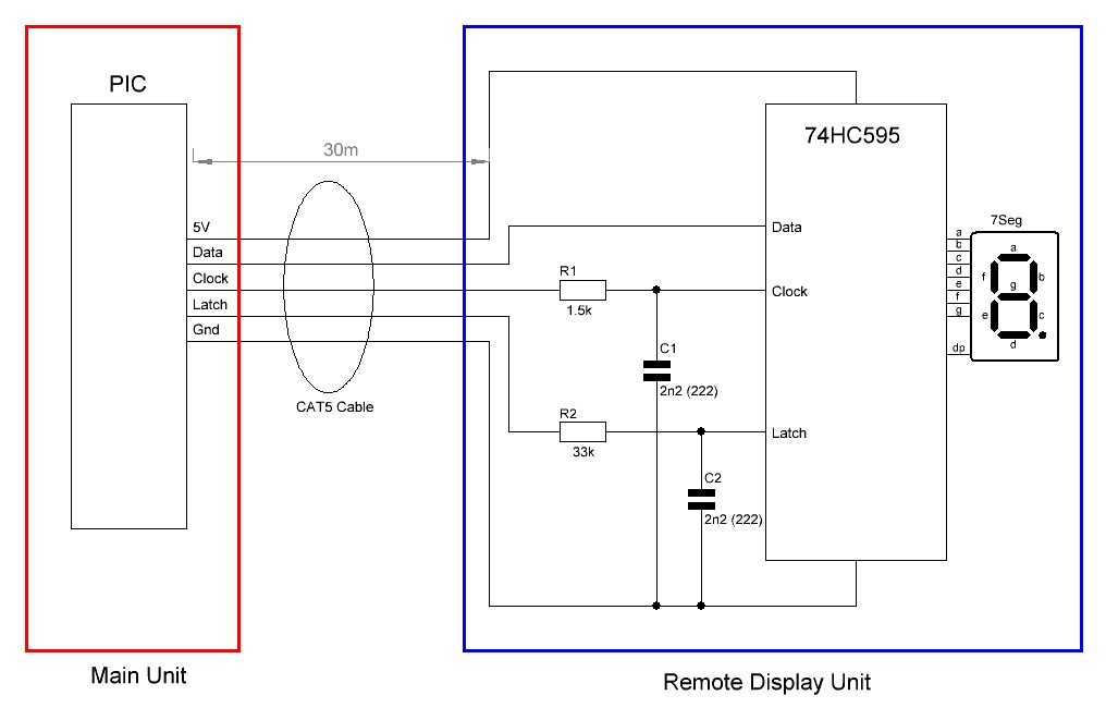

Simply I need to show a number on the segment display.So I just send 8 bits & make a latch pulse thats it.No UART involved.
Every 1 second I send this packet.
To make a low impedance line what modifications do I have to use...!!!

Hi it worked nicely on workbench & never tested on industrial situation.
Be sure to add some delay when triggering clock & latch signal on 74HC595.

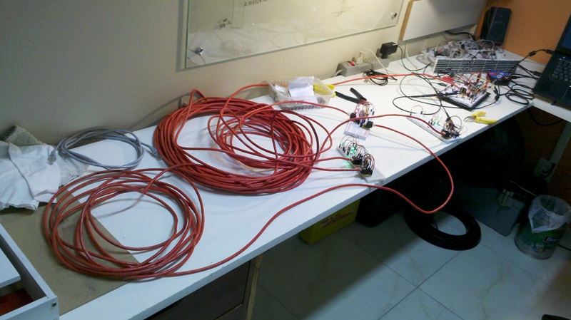

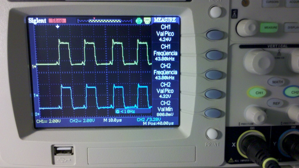

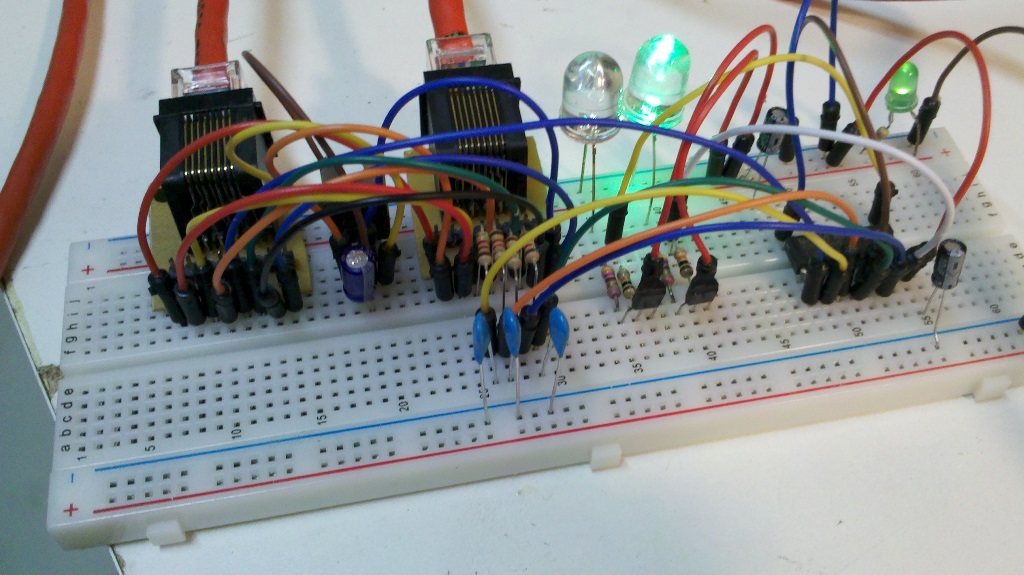

I'm getting good results with the transistors BC557 and BD137. Here is my test circuit:
RC Filter (1k2 resistor and 220pf capacitor):
Wave compare (Blue = After the BD137 on sender board, Yellow= At the third and last receiver board):
Aprox. 10 - 15 meters of RJ-45 cable.
Att;
Daniel
Hi are you using the same 74HC595 for receivers end?
For PIC transmitting side you using transistors instead of direct PIC pin?
Each receiver board has a 74hc595.
Yes, that is right. But in this test, i put the BC557 and BD137 only in the Register Clock pin. Other pins are direct connected on PIC.
I will post the schematic (i don't have yet) to clarify the ideia.
Ok thanks but you don't need transistors to that "Serial Clock" pins as well.A series 100R resister will be fine on all pins.
