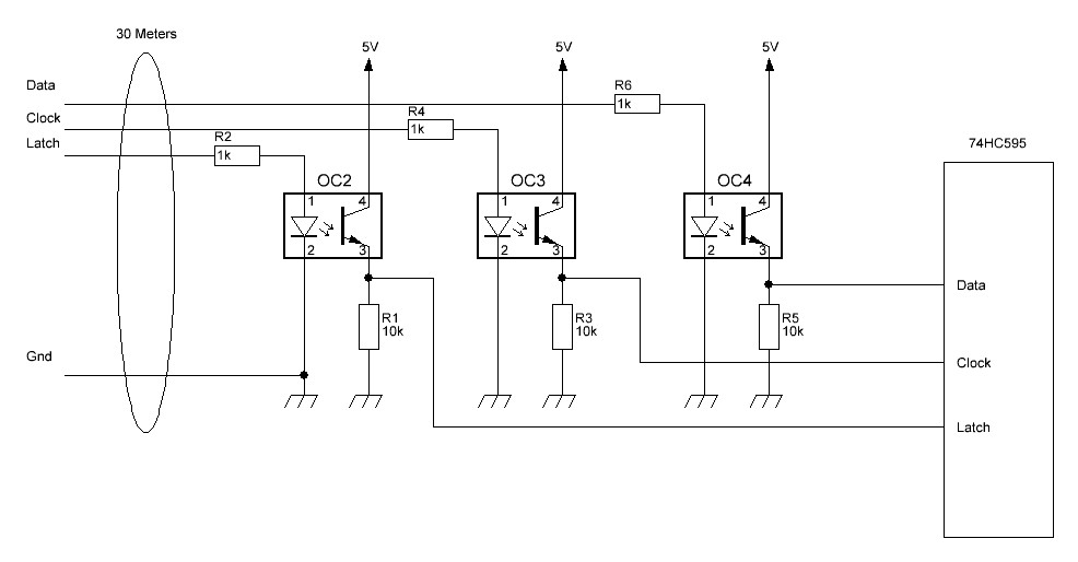

Hi guys I need to control 74HC595 from a long distance like 30m length.
I have drawn my method is that ok?
Depending upon the signal frequency that should work. But if you use the same ground for the input and output of the opto isolators as you show, then you have no isolation and don't need the isolators.
If you really need isolation, then the output of the isolators must use the power and ground from the 74HC595 power, not the drive circuit power.
Hi thanks for your points.
Actually I don't need isolation,just for false triggering & low voltage inputs I used opto couplers.
The controlling voltage is 5V logic signals directly coming from PIC pins over 30 meters distance.
The frequency is very low.I just to show a single digit number on a seven segment display.After sending data to the shift register it will latches the signal.
Is it ok 5V signals sending data to optos...!!!

is the optocoupler a necessity? if not, try to use the basic transistor.. for switching the 595.
You could put around a 2k2 resistor to ground on the '595 input to reduce noise sensitivity, also diodes from the input to both supply rails connected reversed would protect the chip from inductive swings you might get on the long lines.
Yes, without the opto's.
The cable resistance would have to be significantly less than this, but a 30 meter length of even bell wire would be.
I cant remember the numbers but I think holtek do a couple of chips designed to transmit data over 2 core cable, there are parallel input/output bits at both ends, seen one in a slot car.
You can also get a lot of noise immunity by using an RC filter and some Schmidt trigger buffers at the receive end.
As for using the optocouplers, unless you need galvanic isolation or level shifting, they probably make the noise problem worse. Ideally, you want to drive the line with as low an impedance as practical. That way any induced noise gets shunted back to the source. I would recommend a 100 ohm resistor on each line, but otherwise run them direct to the remote display.

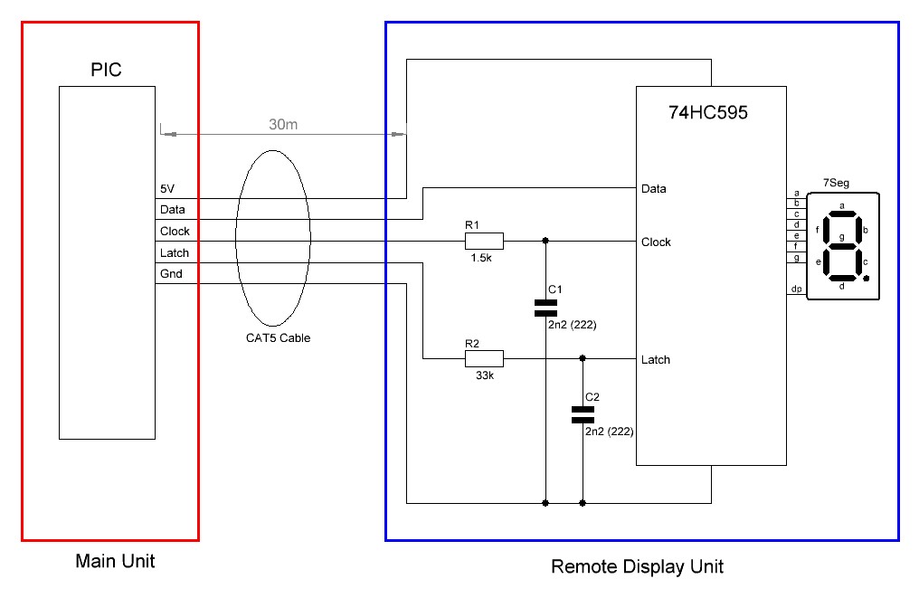

Not really. If you RC filter before sending, the signals have slowly ramping voltages on the / and \ edges, and you will get zero inductive effects caused by the line. A distance of 30 feet is nothing much!
Or if you RC filter at the receiving end, any high speed edge transients etc won't get through the filter.
Hi Mr RB thanks for your idea & I'm going to do as you suggest.
Here how I going to do.Note that DATA line doesn't have any RC or protection thing.
PIC is driving directly CAT5 cable wires.
The main idea is to show a number in a remote location.
Is this correct?

Wouldn't 30m of wire act like a "long wire" antenna?
Have you considered using a pair of RS485 drivers or transceivers instead? They're designed to be relatively noise immune over long distances. Then use a PIC, like 3V0 suggested, to decode an incoming serial byte and drive the display.

You don't need a 33k resistor! If you make both resistors 1k or 1k5 that will be fine.
Just allow enough "settling time" between setting the DAT line and making the CLK pulse, and enough time again before makign the LAT pulse.
How are you getting a 5 core cable?
8 core cables are quite common too, and did you realise with an 8 core cable you can run 7 segments and ground, and just drive the display digit directly with no other ICs needed?
Hi guys I made the circuit & its working nicely.
But I have a doubt on the PIC side (TX side),because it doesn't have anything to protect back EMF produce by the long wire :(
Will I burn the PIC pins Data,clock,Latch lines by back EMF?
I always put about 100 ohms in series with all digital lines that I let go on or off a board. That usually provides enough current limiting so that the on chip protection diodes can handle the energy from any transients.
That's a nice point, ok I'll use resisters on PIC side board even 1K will be ok. But onchip clamp diodes will active when the PIC pin is in input mode.So that means after sending data do I need to make PIC ports as inputs?
