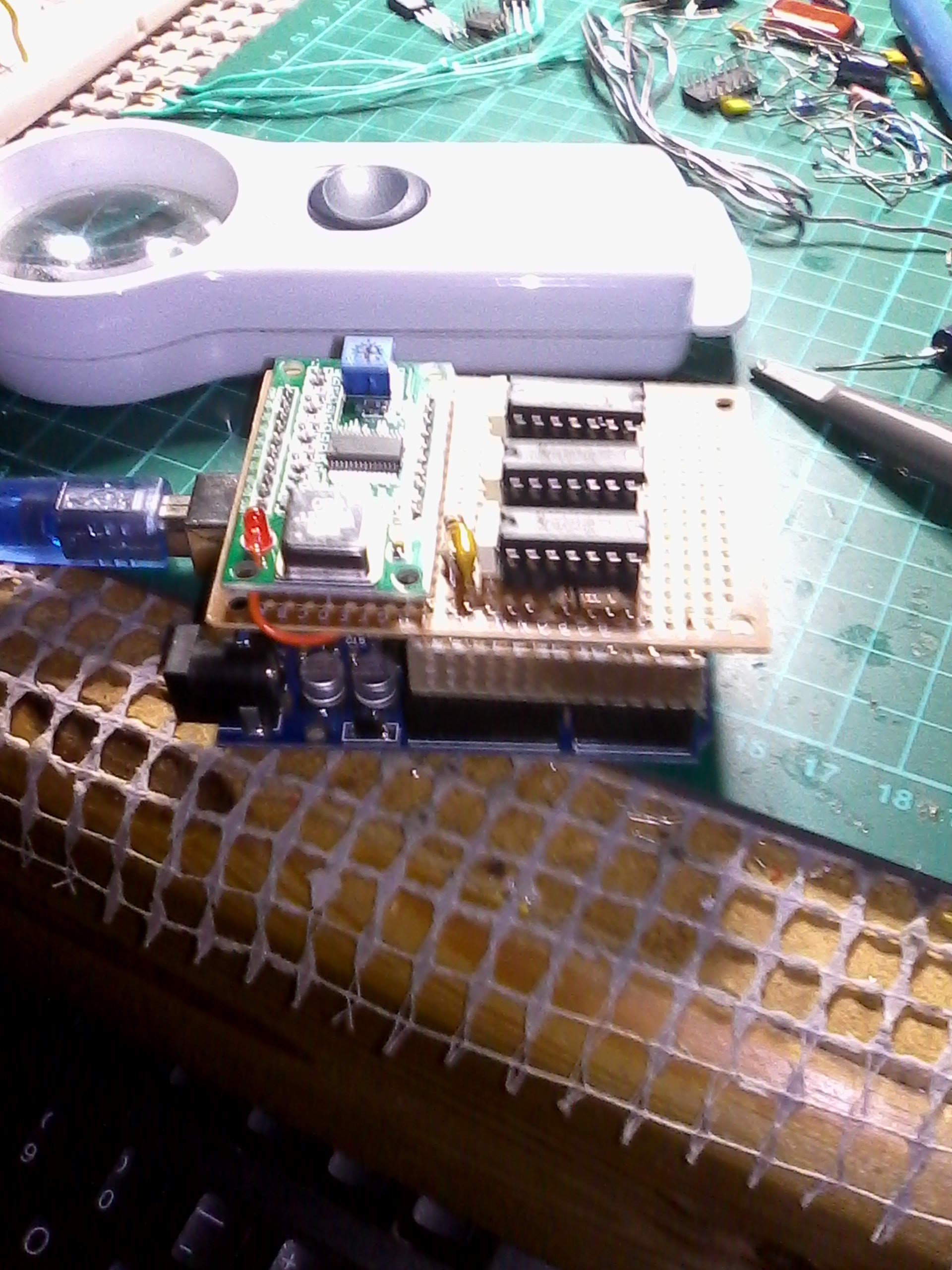

I havent used AC logic a lot.
However I need to divide 125Mc down so I have a couple of these chips.
I prototyped the circuit on breadboard with 100n's accross each chip and it worked.
Just built the circuit onto a vero type board also with 100n's across the chips and it doesnt work, at all.
So I held a 10u cap across one of the flip flops and then it works ok.
There is about 0,5v sinewave at the clock freq across the chips power lines without the 10u, not much with it.
The chips power goes to a bus made from 1mm copper wire with 0.2mm wire wrap (soldered) about 1"away.
Thinking just solder a electro accross each flip flop chip.

Not having read your post and messing further I got the thing to work, it seems the problem was the sockets, the chips are in cheap pressed sockets, thats obviously a no no, so as a temporary measure which might well end up permanent I soldered the power pins in to the socket, I get a reasonably nice o/p waveform,, if I had some 'HC ones I'd put those in the latter stages.
I'll look at the LVC range next time I try something wacky like this.
Your right about the edges and harmonics, I have a gps receiver that gets wiped out by it, 5 feet away, I had to put ferrites on the cable to get it to work, but it shouldnt be bad if I build the divider into a old IF can.

I think I'll also use turned pin sockets on anything fast, these were cheapo's:
I'll be surprized if changing the type of socket construction has any real effect. Usually, ground-bounce problems come down to inductance, and while one socket construction's inductance obviously will be slightly different from a different construction's inductance, the minor variation in value will be swamped by the overall value. As a quickie way to test this, tack a small ceramic capacitor across the device power and GND pins *on the chip* with the shortest possible leads. In this way, the decoupling cap is "inside" the lead and socket inductances.

The circuit now works well with the power pins soldered in, I probably should have put the ic's direct in the board.
To be honest I'm amazed it works at all, the osc is a 125mhz sine wave, I just biased the 74ac74 with 2 resistors to 1/2 supply and stuffed the i/p to that through a 100n cap.
It might have worked better if I'd used some turned pin sockets with built in power supply bypass caps.
