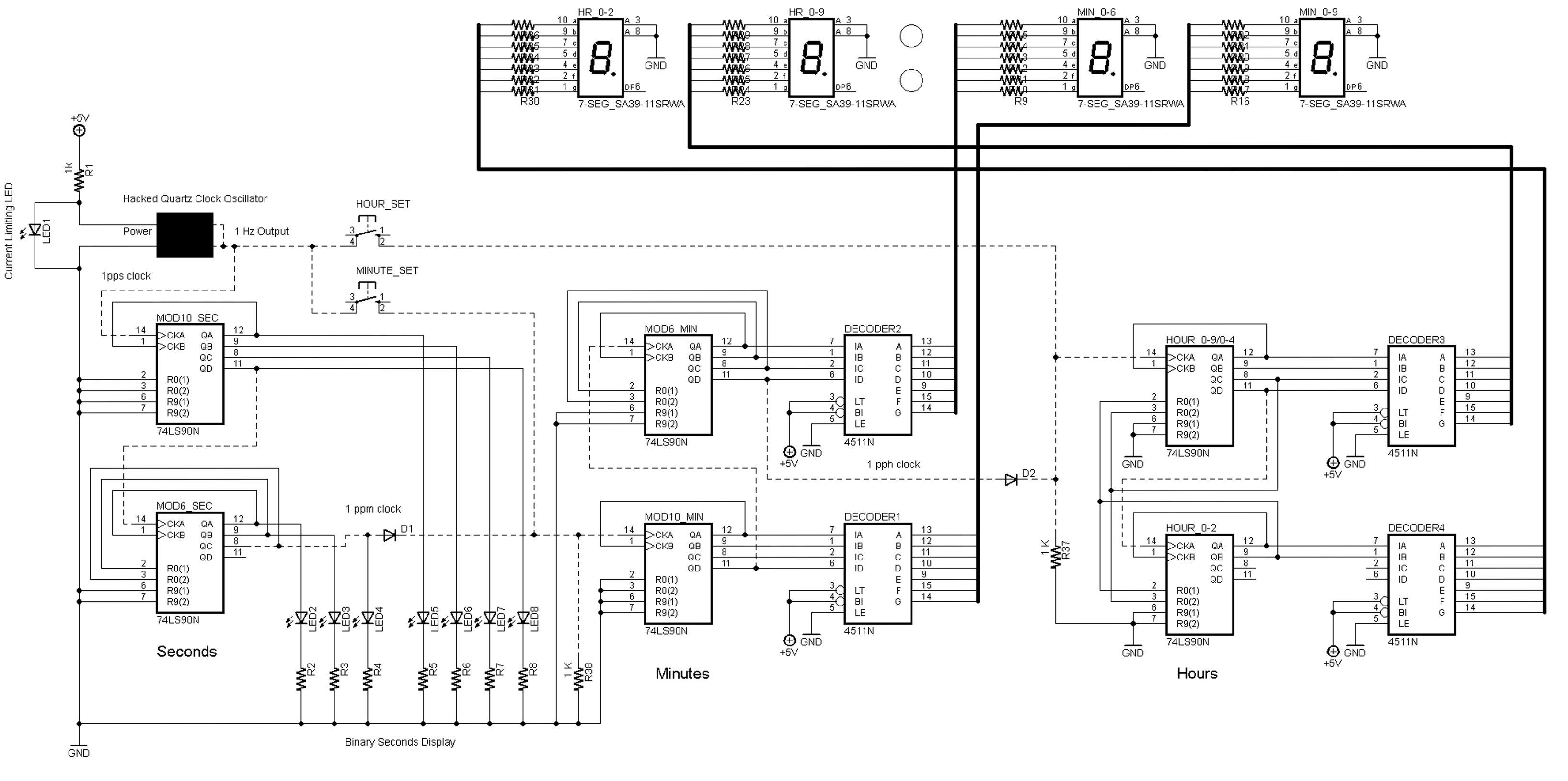

ic 4093 is a schmitt trigger nand and its ttl variant is 74132 ic ...........why is the diode logic not working with the butttons................
schematic
hey i hav made a schematic with diode logic apart from switch debouce portion plz see ....................can this logic be implemented with buttons ........ plz correct if required in this schematic...............
Pressing either button will probably place too great a load on the clock oscillator and prevent it working.
The osc output pin is being driven by both the internal osc circuit and by QC, so there is conflict.
If QC is at logic 1 the button can not change the Ck input to logic 0 without shorting QC via D1.
