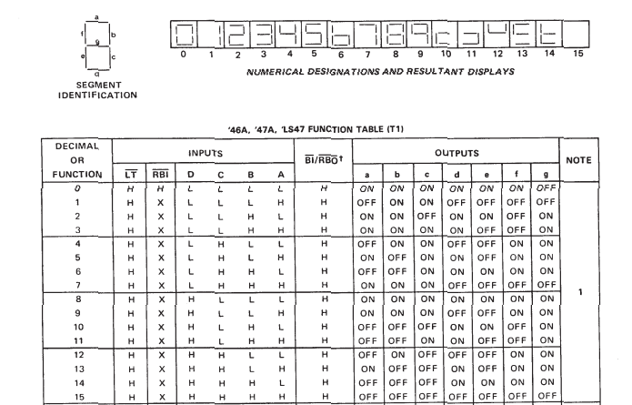

I see that you have 1 & 2 linked also 6 & 7 , this means the inputs are HIGH, so as its TTL , the decoded output is BLANK.
connect these 4 pins to 0V to get "0" displayed.

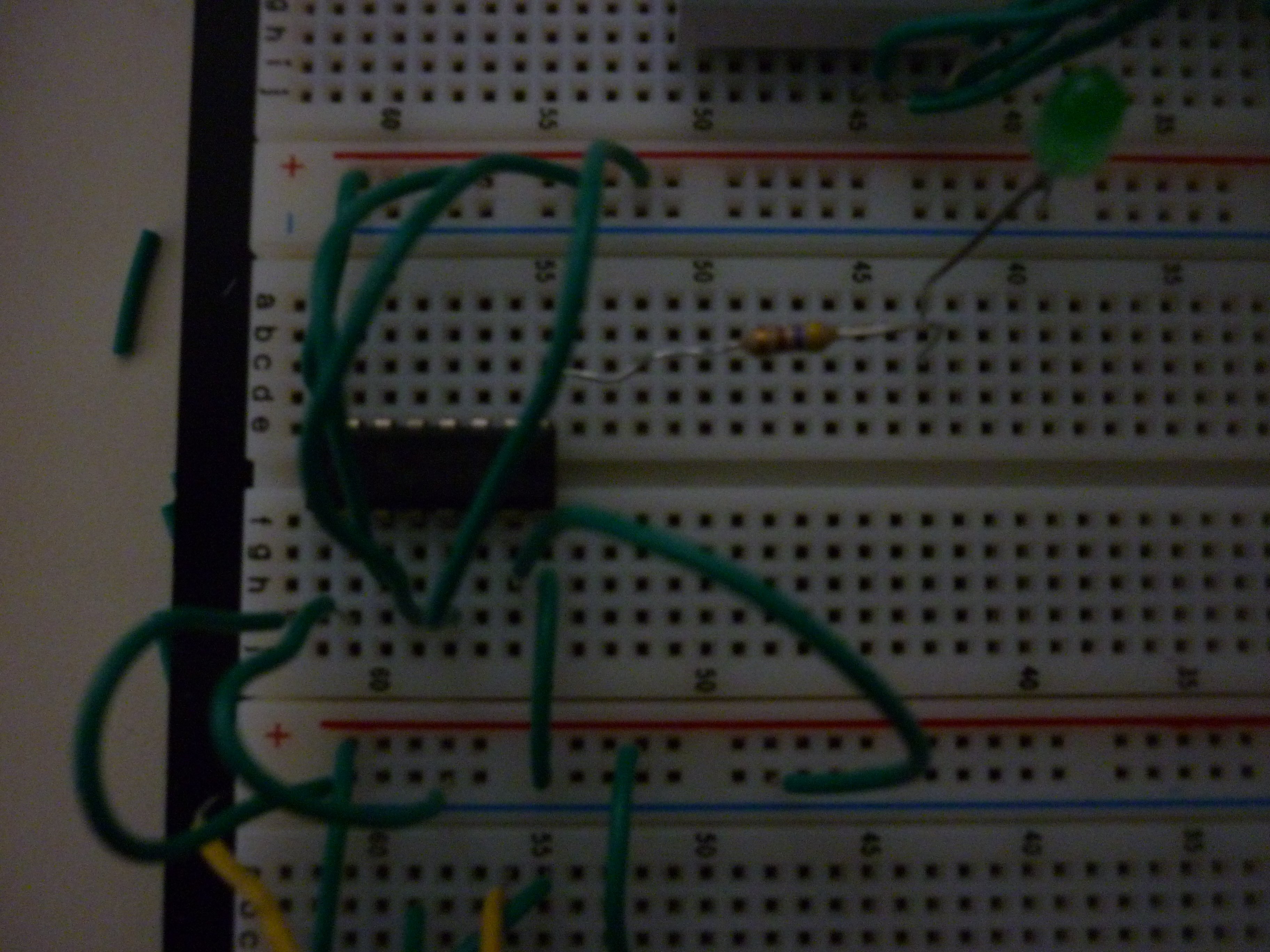

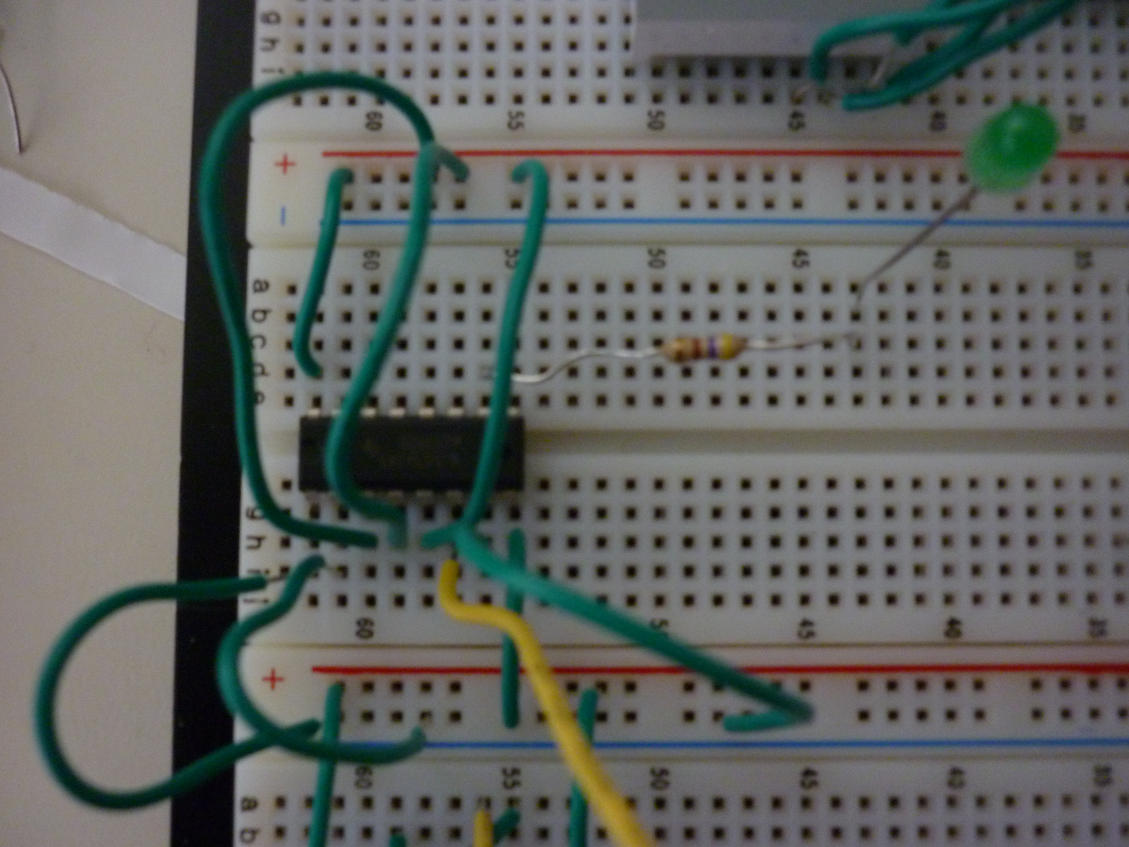

Eric,
i think that my connections are wrong or something. i am using a SN74LS47, but your suggestions don't seem to work.
The breadboard is fine. I have tried up to 3 different chips, but something is going on inside these chips that is not translating to the output I need to see. The LED is still not lit!!
Please help.
The diagram is below.

Sorry,
This is the actual schematic of what you suggested, and the LED is not ON at all

What about pins 3 ( LT), 4 ( BI/ RBO) and 5 ( RBI)? Are they connected?
If pin 3 is low, all outputs are low ( on). You should get the LED lit when fed from the power row.
If pin 4 is low, all outputs are high ( off). The LED should be dark.
If pin 5 is high and ABCD = 0000, you should get a blank display ( no LED lit).
This should also be true for the 7448 IC, which uses pull-up resistors to VCC on its outputs.

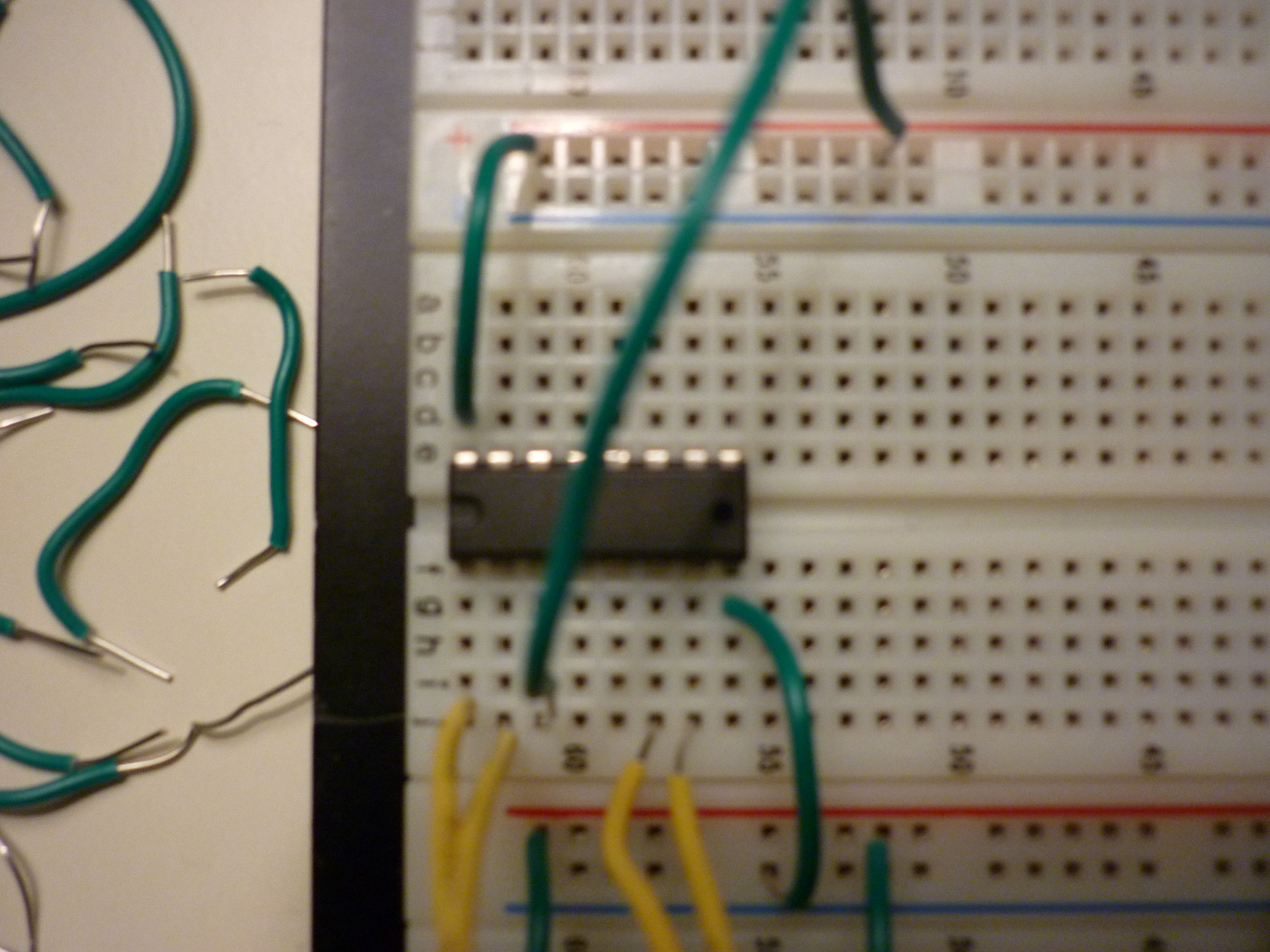

Looking at his image shows that 3,4,5 are connected high,, A,B,C low and D floating pull up, so that decimal "8".
I suspect either the 7447 is faulty or he has a bread board problem.
