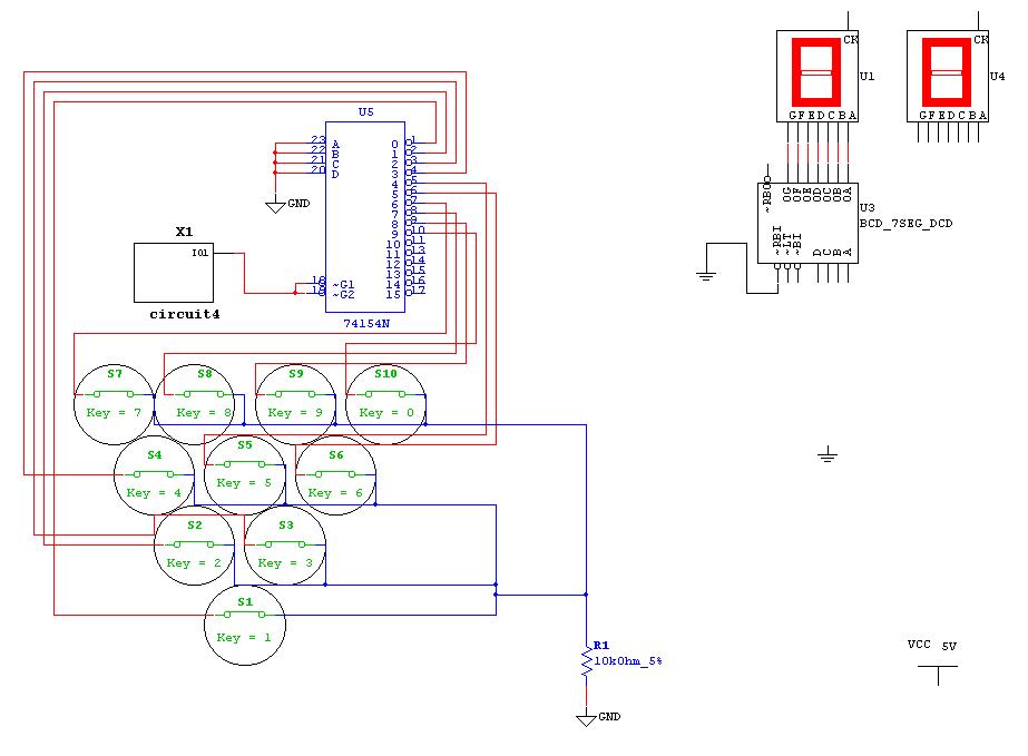

Bowling Pin Counter-------Issues still
Len and the rest of you Electronic Gurus....I am still having difficulty trying to figure out how to complete the circuit. Len I appreciate the help...but am still somewhat confused as how to complete the hookup. Attached is the pic of where I am right now.....I did have a Decade counter installed......no luck...perhaps my circuit is not correctly hooked up. Thanks to all in advance

Carmine,
You must connect the A, B, C & D inputs to the 74HC154 to the respective outputs of the binary counter.
I am in a libray and don't have access to drawing software, so I hope you can make sense of this.
Counter A----A 74HC154
B----B
C----C
D----D
Also, you will need diodes in series with the switches to prevent the output that in low being affected by any that are high via the switch common.

Carmine,
I've just noticed another issue with your posted circuit. R1 should be connected the Vcc, not the gnd as shown. The decoder has active low outputs so the "pull up" resistor must be connected to Vcc to pull the clock line high when all switches are open. You also need diodes in series with each switch pointing towards the 74154.
Incidentally, key 0 should be the first, not the last. Zero is the first digit of all numbering systems, not the tenth.
