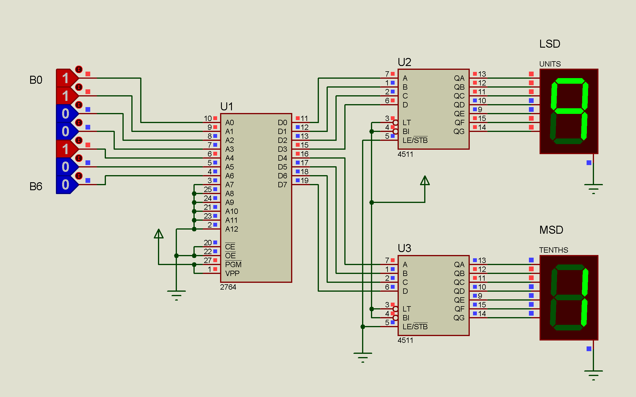

7 Bit binary to Decimal on two 7-segment display.
Hello Dragon, My teacher gave me same homework but i realy dont understand electronic design. I'm an computer programming student and i find this. I have no idea how to make this. My teacher ask me this on proteus. Maybe you laugh but, could you help me about this? If you still have your design could you send me? Thank you.
Yeah i see. I want to try my chance. :) Because there is nothing on the internet about this.
I really doubt that.... Nigel and myself have done examples here on this site... ASM and C varieties...
Did you take a look at the circuits in post#19 and post#20?
Or you want to use an EPROM like 27C64?
So 0010011 binary is decoded to dec 19. But you must have some way to program the eprom....

the code is as below:

you can assemble with any mpu/mcu assembler, I guess.
Here is the object code in .bin

I'm using Proteus for this project. I double click to eprom (edit component) then image file > import the EPROM DATA.bin. Is that true?
PS : Something wrong with 2^3 = 8. When i input 0001000 , the 7 segments light 0-0.
Yes I am having the same problem. I check the file with HEXEDIT and looks like the assembler only assemble the left half of the file and the right halves are all 0s.

Oh, it works! You are really saved me, thank you for everything. You are the man bro!
