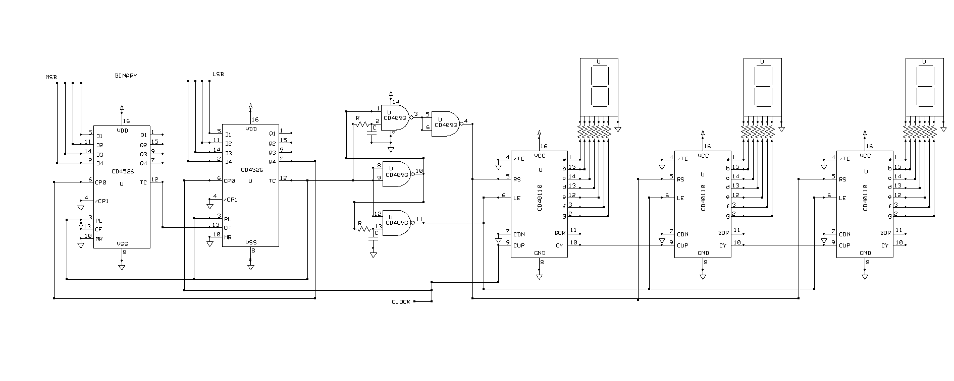

That sounds so much better, the thing is I can't see how to do it, sorry, maybe if someone could be kind enough to put a schematic for it, I would aprreciate it, Thanks again.
Where is the binary number coming from? How frequently can it change? Is there an independent signal (strobe) that occurs when the number changes? What are your power supply voltage options? The design depends on the answers to these questions.
The number comes from an input of 7 logical switches.

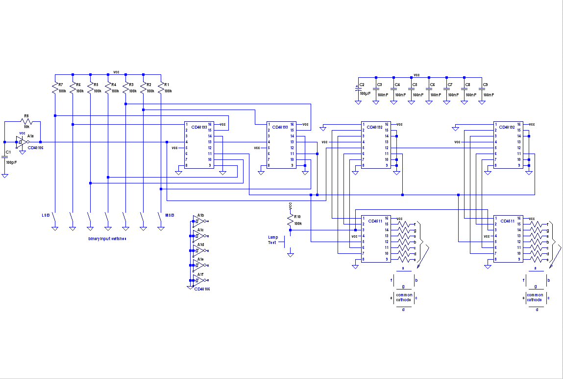

Dagon, here's a converter based on Panic Mode's suggestion. I have not built it or simulated it, so it may not work. You can replace the oscillator with a 555 or whatever. I used what I hope are commonly available parts. You could use TTL parts instead.
Connect one of the 100nF caps across the power pins of each IC.
And another. The 4093 produces a pulse on the leading edge of PL to latch data and on the trailing edge to reset the BCD to avoid race conditions.
Not tested
