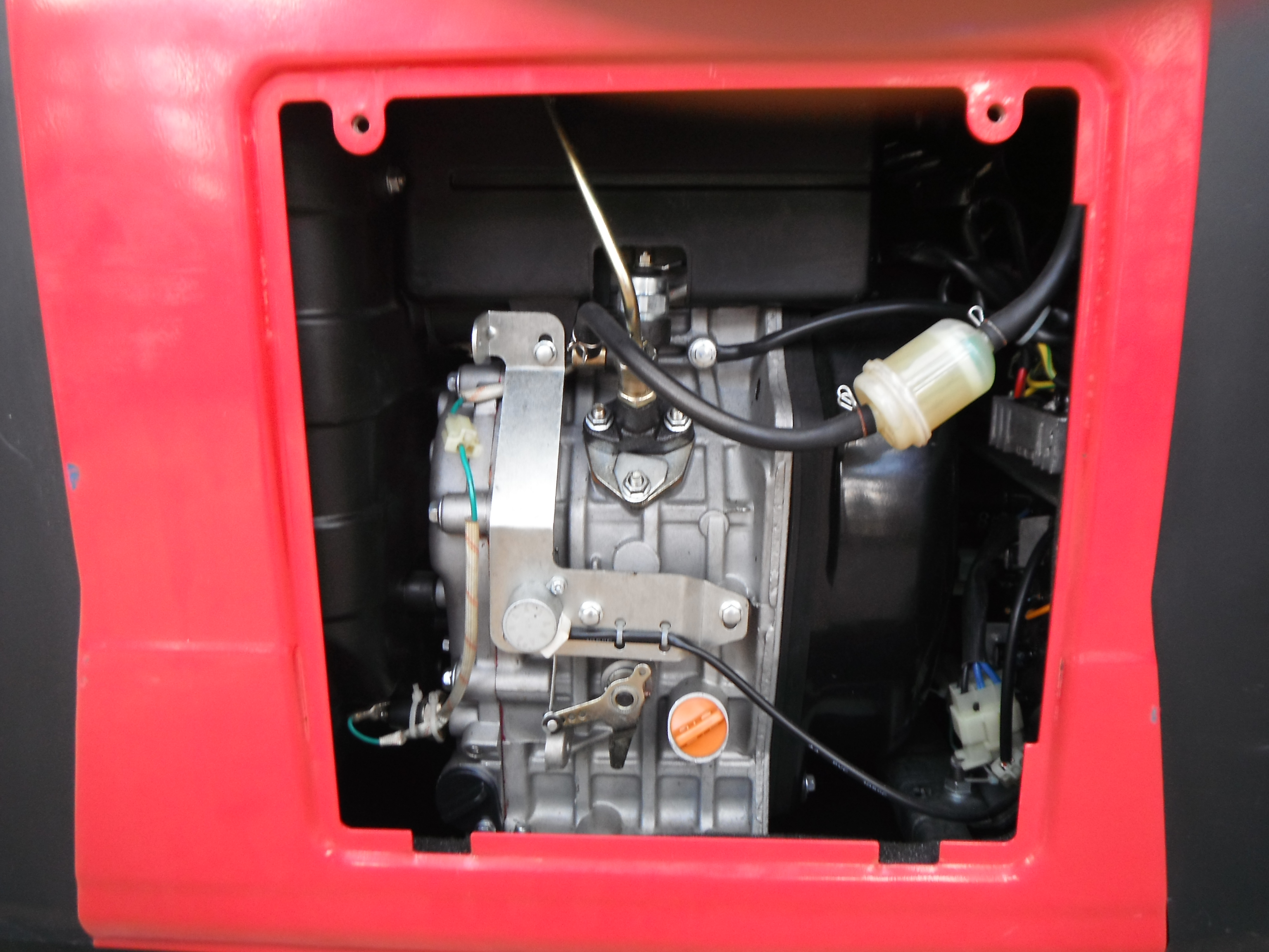

View attachment 82472 Picture of the pump showing the shutoff solenoid on top of the pump. Is the fuel in the filter nice & clean? Diesel does get a black algie grow in it & block filters causing running problems like you described.
Exact same machine but fuel is not the problem . Well versed on that The fuel distributor pump is below the fuel cutoff switch (which has a coil resistance btw). The stepper motor controls the lever on the side which makes the fuel distributor pump more or less fuel.
Thanks for the input however
While I typed this a load more pics came up
Mine starts ,revs to about 3000rpm, display lights up and then it dies in the bum. Fuel OK Oil OK disconnecting either or both wires does not change behaviour. Fuel shutoff is operating fine So still looking

I took a few photos of this in case someone comes in either recognising this fault or looking to fix faults further down the track
Here are some photos a bit smaller and lesser quality that I can refer to with arrows
Image0201.jpg This shows the inspection plate removed so the movement of the fuel lever adjusting the quantity of diesel pumped can be seen. When you pull it out it is easy to not get the control lever in its correct position so check moving the stepper motor is moving the fuel slide inside

Image0205.jpg This is the fuel sensor which makes a circuit when it falls to the bottom and is N/O when there is fuel in the tank. It is therefore easy to test by checking the wires with a multimeter , you don't have to pull it out as I did.
Thanks both -The above is a good point as I hav'nt looked at the oil level as its brand new and was filled before running for an hour and then stopping .The stopping is a clean shutdown and its getting fuel OK up till then
