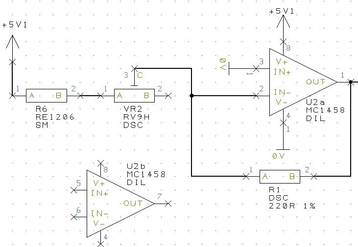

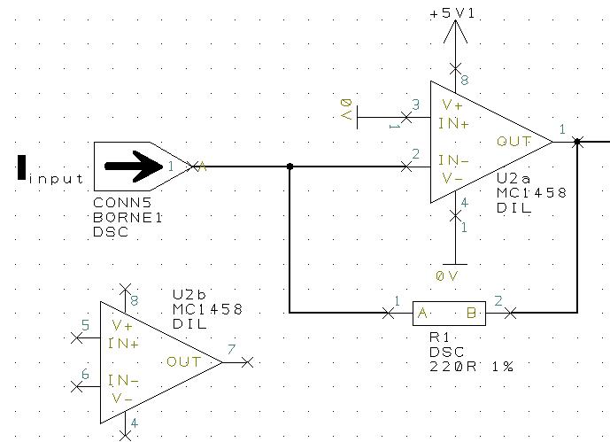

I'm doing the inverting configuration to simulate 4-20mA output pressure sensor and have a voltage output (it's a I-V converter). My ideia it's have a final configuration like the attatched file (fig 2), but i do not have my pressure sensor yet, so with a trimmer i'm simulating an input 4-20mA and measure my output voltage (fig 1). But as i said i do not have correct values in fig 1!!? I'm affraid that when i do my pcb (with the attatched configuration fig2) i do not correct values to measure with my PIC.

2 serious problems:
1) You have the reference input (the opamp's + input) connected to 0V. With a single supply it is supposed to be connected to half the supply voltage. Use a voltage divider with two 10k resistors to make the half-supply voltage divider. Then the reference input will be +2.5V.
2) You used an MC1458 opamp that needs a total supply voltage at least about 10V. With a supply voltage only 5V its output will swing less than 2V.
The LM324 or LM358 operate with a total supply voltage down to 3V. With a 5V supply their output will swing about 4V.
Oh yeah, another problem:
The 220 ohm value of the R1 feedback resistor is so low that an opamp can't supply enough output current to drive it. Most opamps operate poorly with a load and/or feedback resistor of 2k or less.

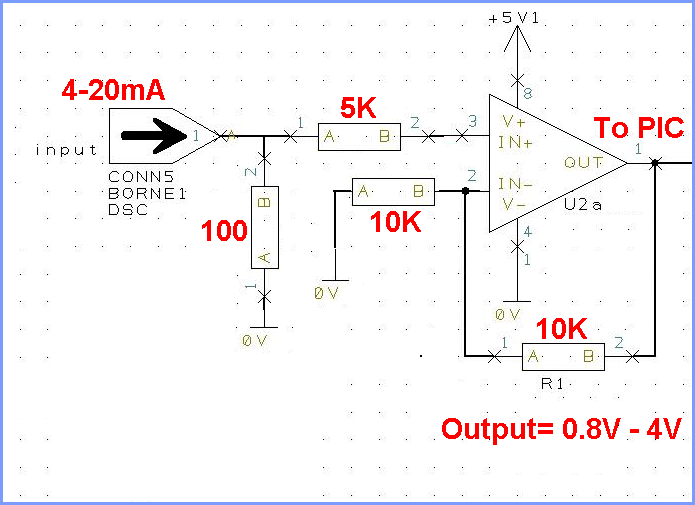

Hi leonel,
Would the following circuit serves your requirement?
yes, it will do!! But i'll have to use LM324 to have the output 0.8-4V. Using MC1458 i do not have correct values (problems that Audioguru pointed)!!?

Yes, problems with MC1458 is the output swing at 5V supply and the common mode input voltage with Vee=0. You need a special type of opamp(LM324/LM358) here which can accept input voltage down to zero volt while its Vee is also zero volt.
Even with LM324/LM358 one is pushing the Vout limit of 4V with 5V supply voltage. It would benefit a lot if you can supply the opamp with a higher supply voltage. There is no need to change any component value in the schematic I posted to do that besides giving it a higher supply voltage.

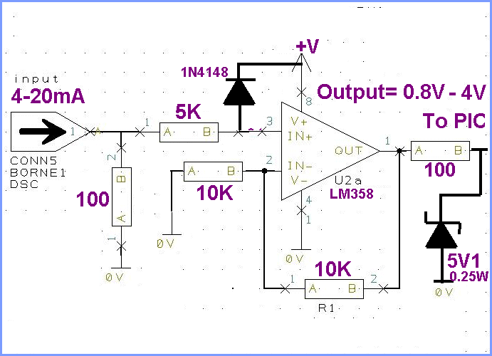

I don't know about the details of the pressure sensor you're going to use but 24V supply, if regulated, would be OK for LM324/LM358 although it is a bit on the high side. Check to see whether the pressure sensor would work with minimum +12V or more(which is highly unlikely). If so, use a 7815 voltage regulator for both the pressure sensor and LM358 supply. Alternatively you can use the 7815 just for the LM358 supply only with the pressure sensor using +24V. You do not have to use a transformer with two secondary windings.
The pressure sensor is designed to output a constant current proportional to the pressure so it is correct to connect the sensor to +V and input. I have added protection diodes to opamp input and output to prevent possible damage to opamp and PIC.

+ 24V is fine to power the opamp. The max allowed for most opamps is +36V and some are rated for +44V.
Is the old LM324 or LM358 fast enough? They were the first opamps designed for low supply power so their outputs are darn slow.
The newer MC33171 single, MC33172 dual or MC33174 quad opamps are also low power but much faster. The MC34071, MC34072 or MC34074 are very fast but use the ordinary power of a couple of mA per opamp. They all have the same wide input and output swings as the old LM324 and LM358. :lol:
