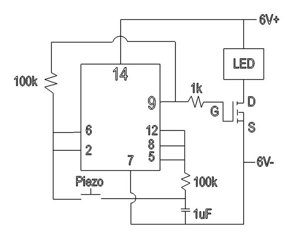

Hi all,
1st time posting and I am hoping I can get some help.
I am trying to build a LED light with a Piezo switch. I am using a single 3.7V Li-ION battery to drive this circuit. However, the toggle circuit (see attached) i can find seems to require a minimum of 6V. Is there a way to modify this circuit so that it runs on a 3.7V Li-ION battery? Or reuse the components for a new circuit.
I am illiterate when it comes to electronics if you could provide a drawing that would be best.
Thank you.
Cliff

555/556s dont run well on voltages less than 5V. Try two CMOS 555s. They usually have a C in the part number, like C555. I dont remember seen a CMOS dual, so just use two chips.
Yep, Mike has pretty much covered this well :) As for part numbers, the CMOS versions are LM555, or TS555 NOT NE555. That said, I have got standard 555's running on 3v.
One possible thing: the schematic shows a MOSFET. Whilst these are great with their low on resistance...many require a relatively large gate voltage differential. That is to say...they tend to only work in circuits with a power supply of >6V. Of course there are MOSFET's with low gate 'on' voltage, usually called 'logic level' or 'low voltage' mosfets.
But if you are just lighting a few LED's, and the current is <100mA total, save yourself the headache and use an NPN transistor. The resistor from the 555's output to the transistors base would deoend on how much current the LED's need and the gain of the transistor. 10K would be a fair starting point for low current.
Also, I don't see a current limiting resistor in series with the LED in that schematic.

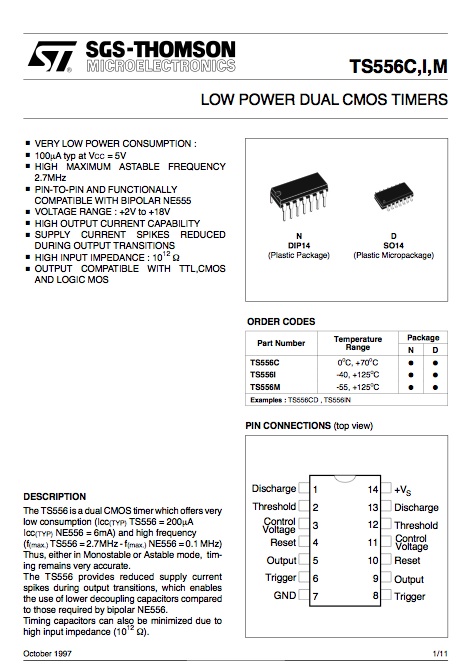

I came across a TS556 and it seems I might be able to do a direct swap. Do I need to change any part of the circuit?

The TS556 looks fine to me. Works down to 2.0v, which gives you some room to work with, using your 3.7v lithium (which will drop in voltage slightly as it discharges).

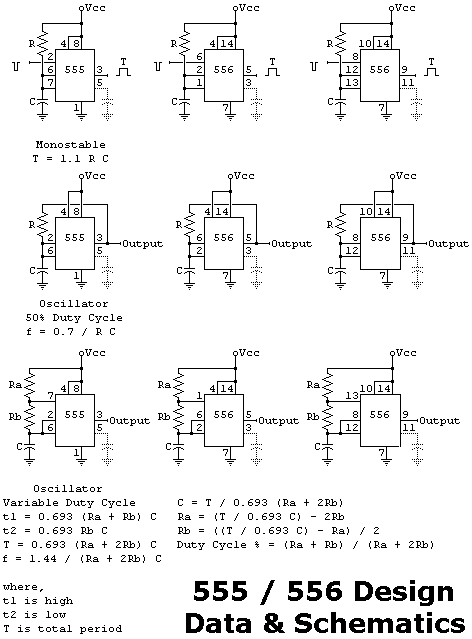

Here is a template I made for most simple 555 circuits you might find handy.
555-cookbook-gif.35311
When I get a chance I'll redraw your schematic for clarity.

OK, each segment of the 556 is an inverter as drawn. The pizeo designation has me puzzled. I assume you want a switch there, do you want to have a sound when the light is light?
temp1-gif.35314
Do you want me to draw corrections?
You mentioned using a 3.6V battery, are you still wanting a ± power supply, or do you want to run it off 3.6VDC only?
Are you using two 555's, or CMOS 555s, or a CMOS 556? Conventional 555/556's minimum voltage spec is 4.5 VDC, CMOS can go down to 2 VDC. I don't think the MOSFET will work that reliably under 5V.

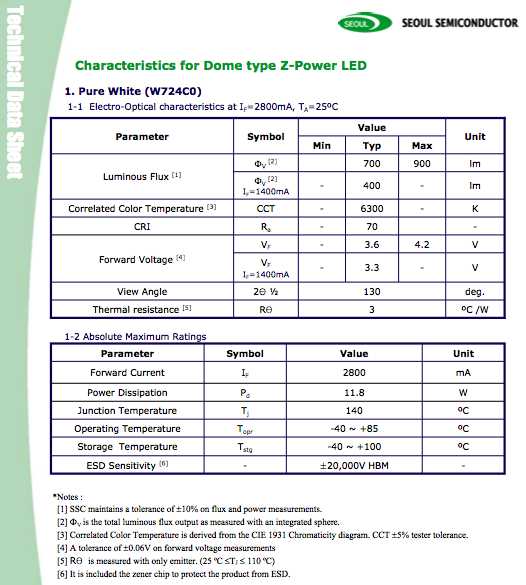

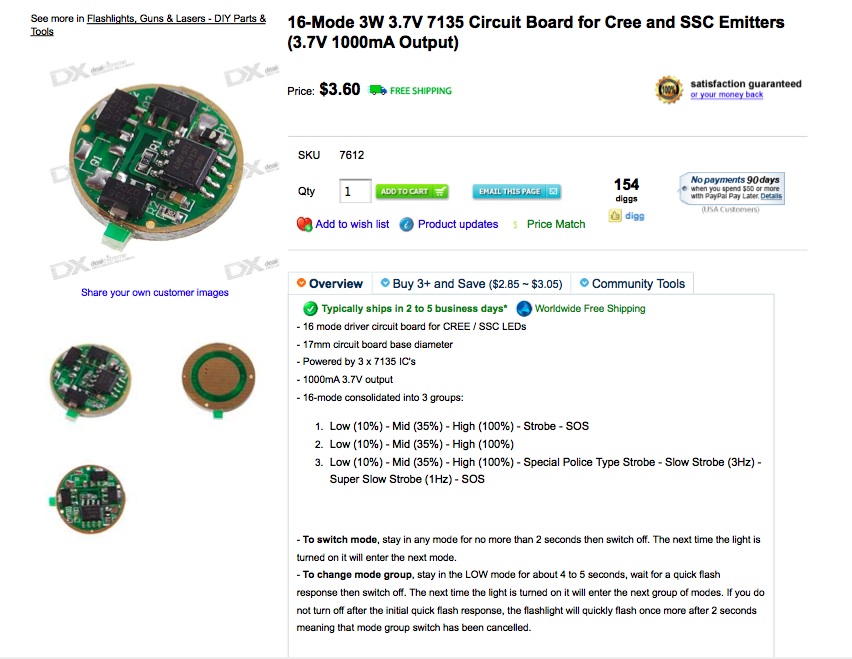

I am using the below (attachments):

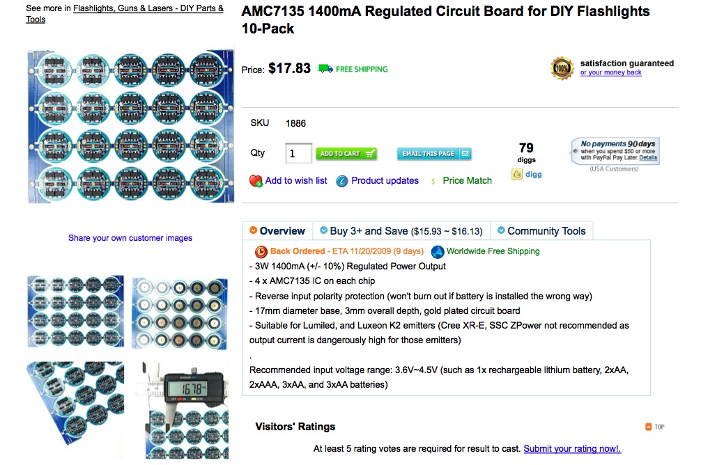

1) 1.4A AMC7135 circuit to limit the current connected to (2)
2) A 1A output Control Circuit
3) I am using a bare LED Emitter (specifications attached)

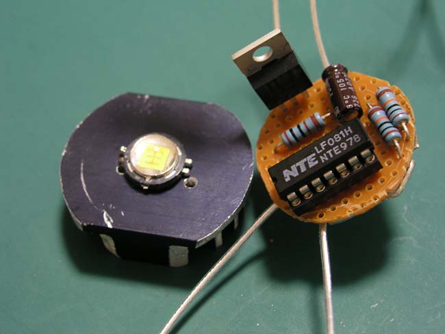

4) Toggle Flip Flop Circuit that I have already assembled with the normal 556 chip + LED emitter on heatsink

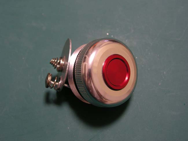

5) Piezo switch on the tailcap of the torch
Honestly, I am not knowledgeable in electronics hence most parts are bought and self-assembled. I had the Toggle flip-flop circuit (with the normal 556 chip) assembled but it failed when i tried with my the Li-ION battery. I know the circuit is working because it works on 6V (4 x Duracell).
The Piezo switch as I understand turns on for a fraction of a second (I think its called a pulse) which why I need this toggle flip flop circuit to hold the signal and have it work like a normal switch. I am using it because it is sealed and robust, probably suitable for underwater use.

Ok so, as for the LED part, using your number system '1', limits the current to the driver board '2', (which is says can take 3.6-4.5V). The '2' board,regulates the current to the LED, effectively doing the same job as a power resistor, but with much better stability (constant current source specifically for LED's.
So, going back to your original schematic, that MOSFET will be fine :D as all it is doing is acting like a relay, and letting the boards '1' and '2' do their job of limiting the current to the LED.
I did google the 'piezo switch' after I posted,I haven't heard of them before but they look pretty cool, and perfect for this application - which of course is why you're using it :D
So, as you said, you jsut need a circuit that takes in the short 20-80ms pulse from the piezo switch, and turns the LED either on or of? like a toggle? once for on, once for off?

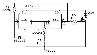

I believe your circuit comes from this page:
Circuits Page 9 (Relay Toggle Circuit Using a 556 Timer ).
Looks like its all set then, as long as you use a CMOS 555 (again, like the one you posted the datasheet for) then I reckon it sohuld all work :) If you like I'll knock up a test circuit tomorrow and do some test....I'm not working right now, so I have nothing better to do lol
Blueteeth
Thanks Blueteeth.
I had just received the Cmos 556 today and everything is working great :D The Mosfet is not as hot as i expected. Other users have feedbacked that the Mosfet was too hot to touch using a normal 556 and 7.2V.

Glad to hear its all working as hoped. I suspect the problem with heating that others are expecting is down to the higher supply voltage used. If the 'modules' you purchased, provided a constant current (which is required for LED's) then they have a particular voltage drop across them. This is the LED voltage (3.7V ish) plus a small voltage used by the current regulator circuit, say 2V. So, because of the 7.2V supply, the module drops 5.7V, leaving....7.2 - 5.7 = 1.5V drop across the MOSFET.
With the LED taking 1A, thats 1 * 1.5V = 1.5 Watts through the MOSFET...which can only be expelled as heat.
With your setup, you're running it right at the lower voltage limit for proper LED operation. This means your battery is providing just enough voltage for it to work, with little overhead that would have to be 'aborbed' by the MOSFET. Thus, itrunns cooler, and is more efficient!
I wouldn't be sirprised if your 3.7V lithium lasts just as long as their 7.2V batteries, with the same capacity. - but you have half the battery size!
