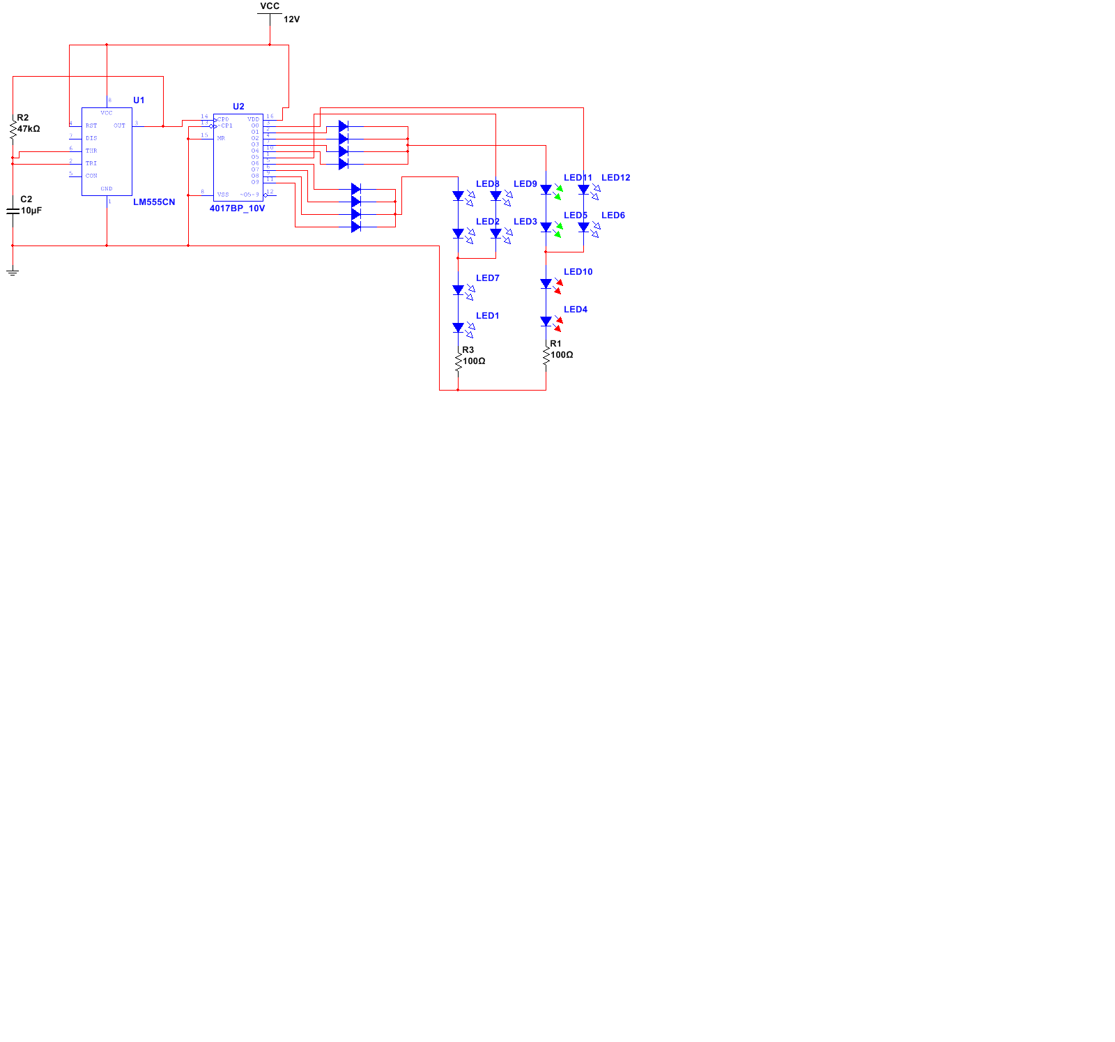

If the other (unlit) LEDs are modelled as white LEDs then 10V won't be enough to drive 4 in series. The forward voltage of a white LED is typically > 3V. BTW using a 12V supply for a 10V-rated IC is not recommended.
See, I wasn't sure which 4017 package I needed to use since there's more than a dozen in multisim, and also the leds are rated at 5 mA.
The LEDs may well be rated at 5mA but it is their forward voltage drop which determines whether or not they will work in your circuit.
So, what would be the best way to optimize this circuit because I'm at a stand still trying to figure this out.
I built the exact circuit in multisim using both the 5V and the 10V 4017 and still no luck, and as well as using OR gates/diodes as well and still nothing.

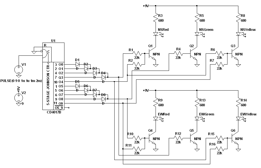

Then there's an error with your sim. The exact circuit in post #7 simulates fine in LTSpice. Note that there are only 2 diodes in series in each circuit branch, so their combined Vf is < 9V.
Ok, so the Yellow N/S and the Red E/W from the circuit on post #7 are constantly blinking. Other than that nothing else lights up.
Run your sim with different LED models (e.g. all red LEDs) and see what happens.
After switching the leds to all red the circuit works; but here's the specs for the green and yellow diodes; green - Vf - 2.13 V @ 20 mA, yellow - Vf = 1.83 V @ 20mA. So what would be the next step? Also, is there is a way to have to have both branches as individual lights instead of having the red lights flipped?

Looks like the models for the green and yellow diodes are buggy then. Next step would be to breadboard the circuit using REAL diodes.

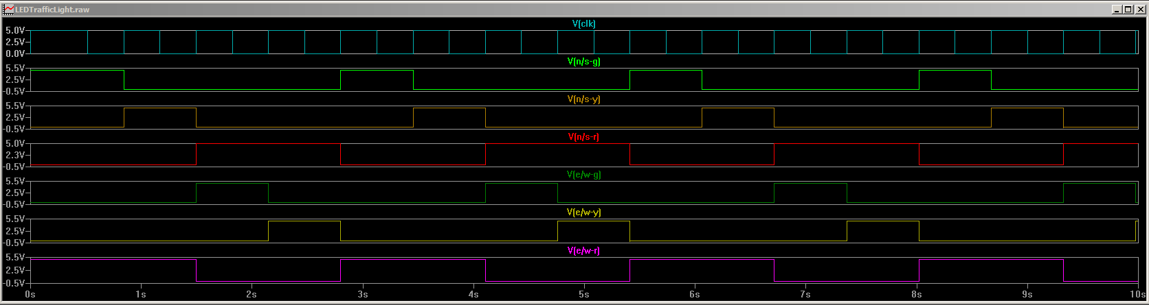

Here you go

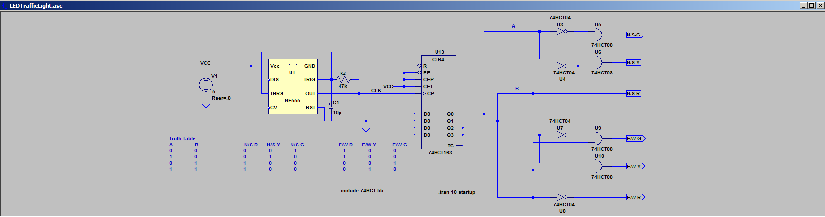

Here's another Traffic lite circuit.
I didn't adjust the RC for the 555 and you can probably reduce the number of components.
But I left it as is for clarity...
eT

As I read the above truth table the lights will switch directly from red to green with no yellow phase. Is that the way they work in your part of the world eTech? In the UK the sequence is R, R+Y, G, Y, R, .......
Hi alec
I thew the circuit together about midnight last nite...didn't relaize the sequence is different in the UK..
But yes..the sequence in the US is R >G>Y>R>G>Y>R....
