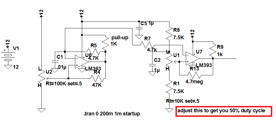

Try this, same foot print (DIP8) but a different oscillator Untitled.png using a LM339
