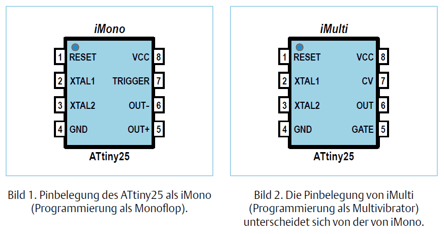

if you have an AVR programmer you could create NE555 circuits using an ATTiny25.
The monostable version is retriggable.
Both versions IMono and IMulti can use an external crystal for optimum accuracy and frequency stability.
You might download the article + free software from https://www.elektor.com.
The title of the article is I555.
Boncuk
