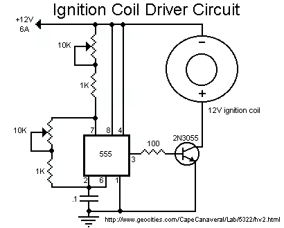

I built an ingition coil driver useing the below schematic, but I wired the coil the other way round.
I made sure that positive voltage went to the positive of the coil.
Is the schematic wrong?
It even works using a small 9volt battery.
The timers that I have been using are ne555.
Is there a way to protect the timer?
Put a diode across the emitter and collector of your transistor in the direction opposite to the current flow through the coil. When the current pulses through the coil the diode won't affect it. When the current stops flowing, the magnetic field around the coil collapses. This creates a large voltage in the opposite direction (which is what is probably destroying the 555). The diode will bypass this to ground, protecting the 555.
Also the 1k resistor is less. It should be above 5k so that min. value of R remains 5k even when pot. is set to zero ohms.
The 2N3055 driven using 555 seems an overkill for this IC. Use 555's output to drive medium power transistor and use this transistor to drive 2N3055.
E = -L(dI/dt)
Both posts make good points, but lavenatti's right, it's the lack of a protection diode that's blowing your parts. It's a common mistake. Are you finding that your 2N3055s are blowing up as well?
When the current through a coil changes with time, an electromotive force is induced in the coil. Faraday's law says that an instantaneous change in current will produce an infinite voltage. Instead of that happening, the silicon junctions in the coils' path break down and provide a path to ground. You can bypass the coil with a diode, zener, or a snubber (RC); power supply rectifiers like the 1N400x are often used. You'll often see the diode wired across the coil in a reverse-biased manner, this basically provides a short circuit for the transient (notice the minus sign in the equation...).

The power darlington wouldn't necessarily get damaged. The coils' transient spike finds the easiest path to ground, and the 555s' output stage is probably "popping" or fusing before any damage occurs to the power transistor. The 555 makes a good "electronic fuse" in this circuit. At least that's my guess.

Yeah, and notice that the diodes are designed to be placed across an inductive load, NOT from collector to emitter. If the freewheeling diode is in place and not defective, there should never be a negative spike at the collector of an NPN common-emitter stage driving an inductive load, so a diode from collector to emitter serves no purpose.
One more thing, put the diode across the coil terminals if possible, to minimize the current loop when the transient occurs. ie, if the coil is located an appreciable distance away from the driver circuit, put the diode across the coil, as opposed to back on the board where the driver is located.
But this defeats the purpose of the coil. The whole point of the coil is to get a large reverse voltage, which creates a spark at the spark plug. If you suppress this voltage with a flywheel diode, then you get no spark. :(
Exactly Phaser, so like i said earlier put the 555 on its own separate power supply connected via a common ground to the power transistor , problem solved.
catch-22
phasor is right, the diode will protect your 555 but kill the spark. Overlooked the obvious :oops: . For most other coil driver scenarios, (relays, solenoids, motors) the protection diode would be a good fix, and the previous advice applies. Nettron has a good solution here.

The current through the coil builds up with a time constant tau=L/R, where L is the primary inductance and R is the series resistance in the coil/transistor circuit. If you turn the transistor on long enough to reach I=V/R (about 5*tau), the current will be limited only by the series resistance in the circuit. If that is only the primary resistance of the coil, your transistor may indeed get hot. You may need to either use a series resistor, a shorter ON time, a heat sink, higher base drive, or a bigger transistor.

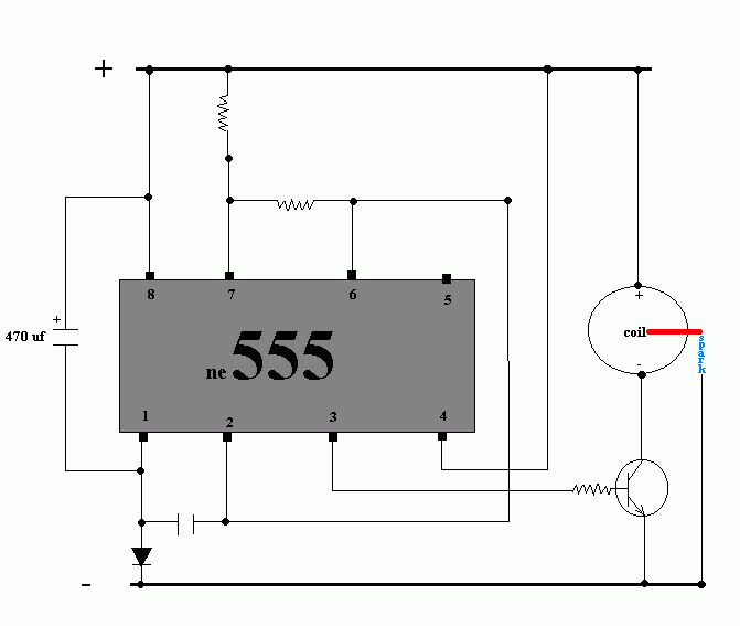

add a diode and a 470 uf cap.
The circuit works excellent now.
pic attached:
Not sure about the frequency.
Cant remember the resitor values, but under 10 k.
The circuit does not have to have a precise frequency for a big sparks.
The spark size is also dependent on the supply voltage.
I'm getting over 2 inch sparks on 12 volts.
