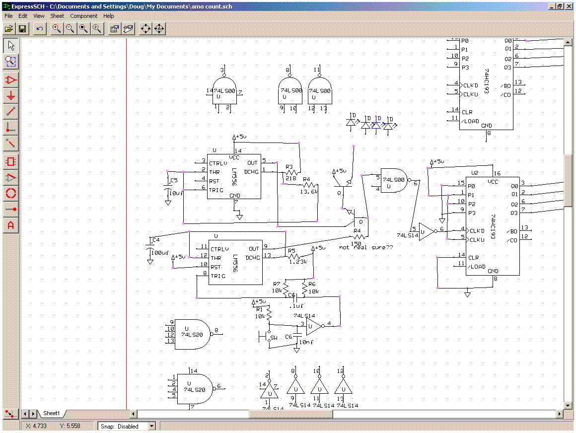

OK, well I've posted about this a few times, and I've gotten it working, but I'm having a problem with two things.
1. Accuracy of the pulses.
2. Random counting.
Here's the circuit.
The monostable side of the 555 should trigger for 435ms, allowing 3 pulses from the astable side to activate the counter. I've having a few problems though.
I know the 555 formulas to figure out the parts to use to achieve 435ms, but it's not accurate enough. Some times it lets 2 pulses through, sometimes as many as 5 make it through. I need this to be 3, every time. SO, could someone possibly recommend some high accuracy parts to achieve what I need? The average resistors and caps from Mouser have too high tolerances to be accurate enough.
For the second problem, it jumps to random numbers. Pressing the "Reload" button sets the counter to 36. Every time I press the "Trigger", it should count-down by 3. This normally works, though it's sometimes 4. However, if I hold the "Trigger" button just right when I push it, it counts down three then jumps again or all the way to 99. I assume this has something to do with micro-arching in the switch causing ripples in the circuit. Any ideas to fix this?
Also, it seems to get dramatically more errors when the four LEDs are plugged in. Any ways to fix this?
It would help if you provided part numbers for IC1, IC2, IC3, etc. It would also help if there was only one IC1 on the diagram. Which button is the reset button? You should debounce the Start Switch for starters. You can make a debouncer out of the redundant gates from IC5 (pins 4,3,12&13) and just tie pins 12 & 13 of IC3 high directly.
Alright, sorry about that. I fixed it, so now it shows my completed schematic.
Anyhow, so how exactly would I debounce the switch? I know how to do it with a simple resistor and cap, but IC5 is an inverter package and I don't know how to do it using inverters.

sure sounds like switch bounce
here is a link that explains and has circuits for debouncing.
the parts may be working just fine, just to much switch noise so circuit is confused.
http://www.ganssle.com/debouncing.pdf

reviewing your circuit
it has several problems
you mentioned that connecting the leds the circuit does strange things

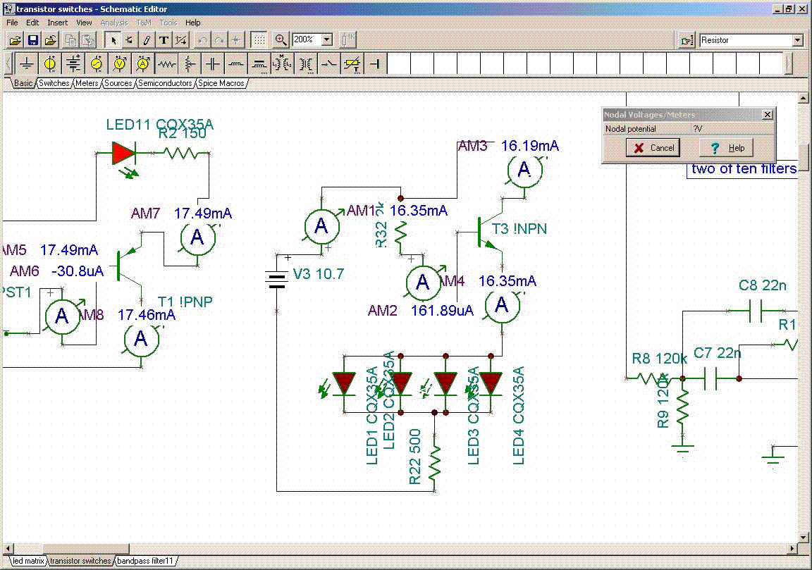

The transistor needs to be biased as the way you have it connected the leds are drawing 2.31 amps(ran a simulation in TINA
WHY is ic5 pins 5 &6 connected to the ic4 (pins 4,5,6)
ic4 is being used as an inverter then you reversed it with ic5.
ic5 would be better IMO using a 74hc14(schmitt trigger) then use to de-bounce the switches.

The thing with IC4 and IC5 is suppose to work like this.
The count comes through the 6,5,4 gate in IC4 as low while it's open. IC2 needs a high count, so IC5 5,6 is there to re-invert it. The whole purpose of IC4 6,5,4 is so that once the counter reaches 00, the gate closes, stopping further counting. So, it's not just being used as an inverter.

Could you explain the transistor biasing a bit? Transistors aren't my strong suit, as I'm sure you can see.

Anyhow, could someone explain the transistor biasing to fix the LED problem? I just updated the circuit to include the switch debouncing, but the LEDs are still causing problems.
TINA simulation
here is a simulation pic for the transistor resistors.
I think this will work, no guarantees
As I stated before without a resistor in series with the leds your drawing upwards of 2 amps!!
I put a resistor on the base and in series with the leds
I have most of the circuit drawn out in expresspcb.
need to add the gates in lower left corner.
subed a 74hc14 for the 74hc04's. then inserted a switch de-bounce circuit

Have revised schematic
I have your circuit drawen out using expresspcb (can download off web for free)
the schematic has couple changes such as pull up resistors, 74hc14 ics.
different led read out.
was thinking about a VCO Oscillator ic instead of the 555 for better accuracy?
If you want the file then email me and I will sent .
