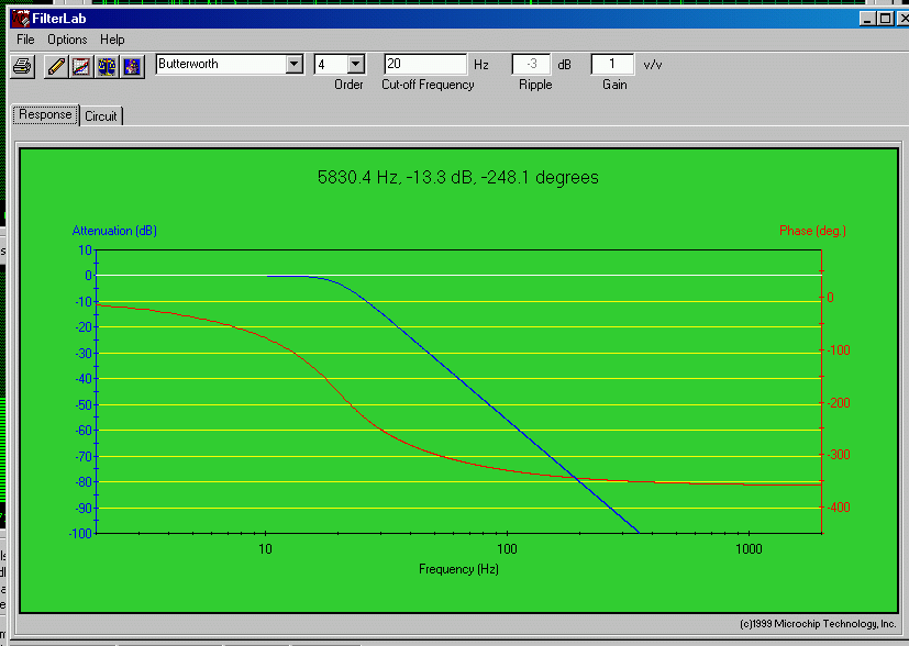

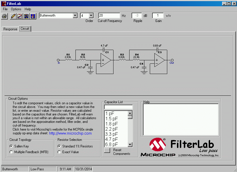

I have filterLab, an opamp based active filter designer. I could cobble up a low-pass filter. How much ripple can you stand? How steep the roll-off?
Example:
You need a low-pass filter as Mike suggested. The question is how much ripple can you tolerate, since the amount of ripple affects the filter-order required, and the response time of the circuit. Is response time critical?

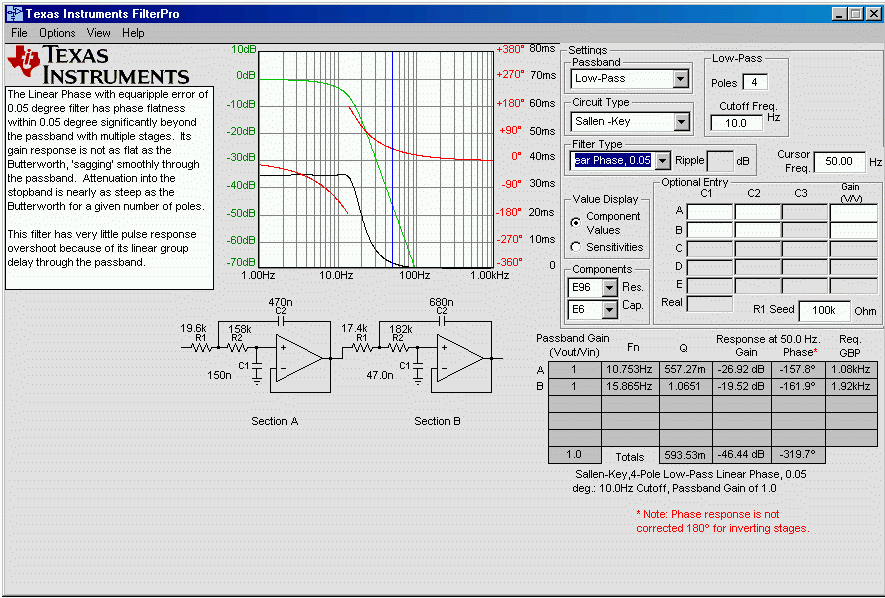

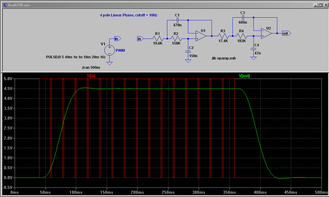

Here is what you could expect with 50Hz PWM and a 4 pole Linear Phase filter with a cutoff of 10Hz. Note that that ripple is minimal, but it takes a while for the output to catch up to a PWM duty cycle change. The sim shows the PWM duty cycle going from 0% to 90% and back to 0%. You could make the response faster at the expense of having more ripple.
Thank you mike, that information will be very helpful modifying the integrator on the i/s/h circuit. I also ordered so ATTiny 85's to do the low freq pwm to higher freq pwm using the microcontroller as well. Will try them both and see how it works.

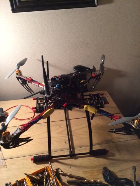

Here is the platform this device will be used on. Just for anyone curious.

If you are using the intrinsic Arduino PWM function, the rate is 500Hz, so the filtering requirements will be greatly relaxed. The simulation above was for 50Hz PWM.
