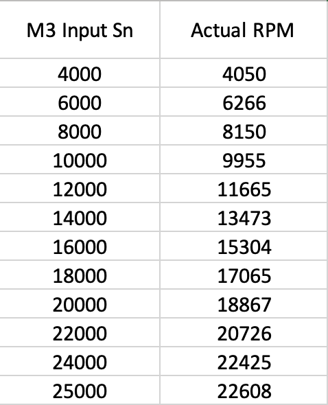

I'm not sure what extra information you need, but here goes...
The control board provides a 5V level signal for a TTL-compatible input for the PWM-Voltage converter, which in turn provides an output to the spindle. The control (input) voltage specification to control the spindle's speed is:
0V = 4,000rpm
2V = 8,200rpm
4V = 12,400rpm
6V = 16,600rpm
8V = 20,800rpm
10V = 25,000rpm
To achieve the required speed, the GCode command required is M3 Sn, where n is a numerical value of the speed required, e.g. M3 S10000 should give a spindle speed of 10,000rpm, and M3S18,000 a speed of 18,000rpm.
The actual speeds with the purchased PWM-Voltage converter deviate from this, where the lower programmed speeds are higher and the higher speeds are lower, The latter is probably due to the limited output voltage from the PWM-Voltage converter of 8.6V
I'm confident the signal from the control board is correct and the correct voltage applied to the spindle will produce the correct voltage. What I'm not confident of is the 'conversion' by the converter, so the actual speed is adrift from the programmed speed.
What I'm actually getting is this, but I've got another converter board that can supply 9.6V, to that might improve things:

To be fair, I normally use the spindle between 10,000-18,000rpm, but I would like to make the actual speed as close as possible to the programmed speed, but maybe I'm expecting too much?

You will need to trim the PWM converter gain to match maximum speed, that's presumably what the blue pot is for on the PWM converter PCB.
For an analog control open-loop spindle, 1 - 2% error is considered good on full size machine tools.
I think the issue was with the supply voltage to the converter board.
It seems a 12VDC supply from the control board isn't adequate, so I've test-wired it to directly to the 24VDC supply from the PSU, and I can now get a 9.6VDC output with the blue pot adjusted to its limit, so that's a bit closer!
Maybe a 30VDC PSU would make the difference but, if the programmed speed tests are closer to actual speeds, then it's as good as it's going to get.
Thanks for your time and efforts, though. It's really appreciated :)
Probably whatever opamp they use for the 10V output is not rail-to-rail and could not get close to the positive voltage. I doubt higher voltage will make any difference, it would probably give the same output from around 14V upwards.
You could adjust the minimum and maximum speed parameter in the M950 line to match whatever the lowest and highest speeds actually are at the spindle, for better overall speed tracking.
That is the actual minimum and maximum speeds of the spindle, when digitally controlled, but I was wondering if changing the Q setting might make a difference.
So, I've been out to the workshed (too small to be a workshop, too big to be a toolshed) and, with the (cheapest) PWM-Voltage converter managed to achieve the following:
