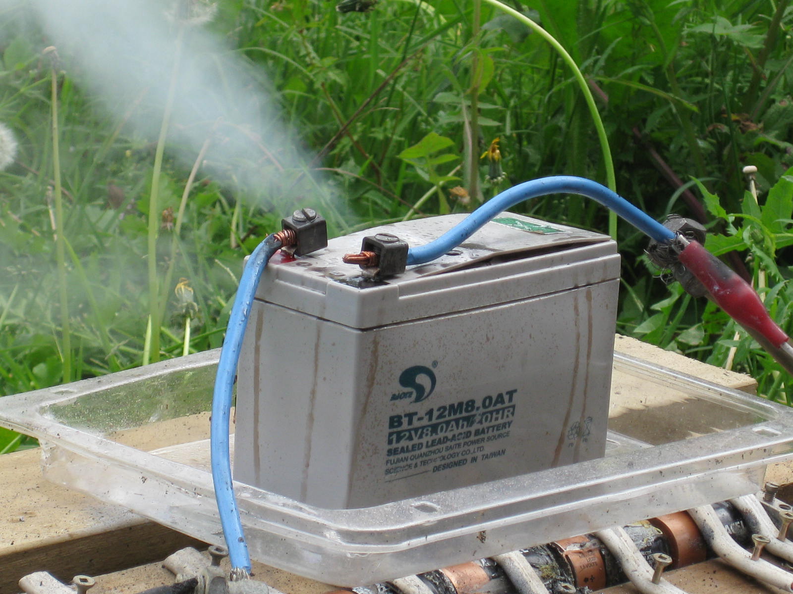

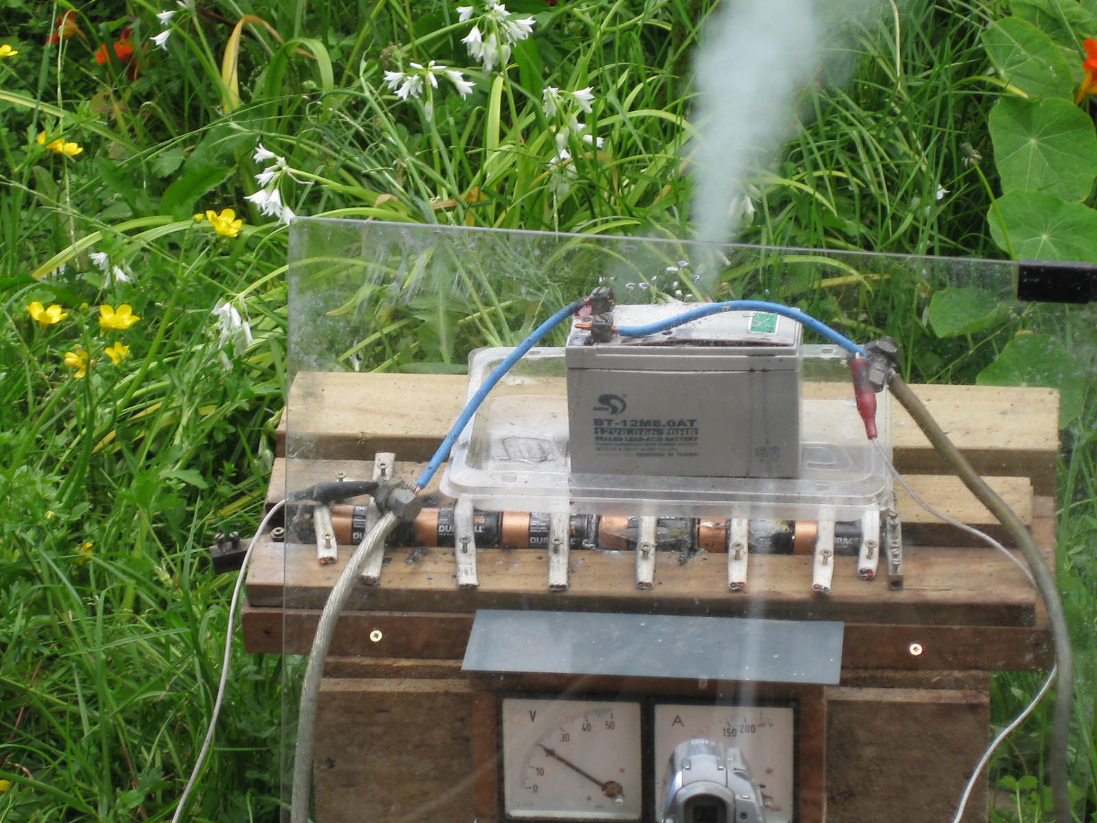

Don't overcharge and monitor its temperature and charging current as these SLA cells will vent when overcharged.
See attached photo when a 12V7Ah cell was put on a 70 Amp charger to prove a point.
Bear in mind that this battery was charged / destroyed at 70 Amp AC current.
I just wanted to see what would happen and did that test outside.
I had heard about these SLA's venting and decided to blow one up.
In your case charging at 100 mA just keep an eye on the charging process.
When the battery starts crackling, that sound like stress and pressure building up in the cell blocks.
Early warning signs are the smell of sulphuric acid ( very nasty ).
You can see that battery venting on my YouTube channel.

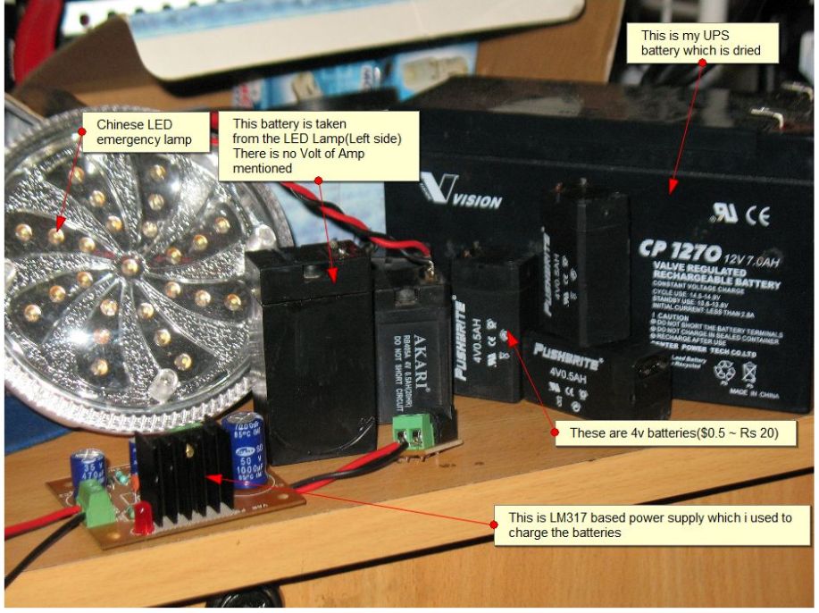

one of my 12v 7.2AH battery is not showing any voltages. Then i tried to recharge with LM317 circuit. After several hours it is charged by some 6.7v, but when i measure the amp there is not Amp there. Is this mean this battery is dead. This battery is from my UPS, it was not working long time, so i want to find it is a battery prob or the UPS.
Two possibilities: (1) chronic overcharging by the UPS (electrolyte dried out). Root cause: charge voltage too high.
(2) chronic undercharging by the UPS (the battery is sulphated). Root cause: charge voltage too low.

Thought to post a pic of those 4v batteries
4vbatteries-jpg.48220
One question i want to charge these 4 batteries at a time. Can i connected it in parallel and increase the current of the power supply? Charging the batteries one by one is a pain

Charge them individually once. After you have proved that they are useable (i.e. no shorted cells, have useful capacity), then you can charge the 4V batteries in parallel with other 4V batteries. Obviously, you cannot parallel a 12V battery with a 4V, and the charger must be modified for 12V batteries.
