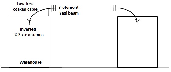

Two external 3-element Yagi beams, facing one another, each coupled with low loss coaxial cable to an indoor inverted ¼ λ ground plane antenna , may help improve the connectivity.
Some educated guess numbers with yagis as shown above:

You need at least -110 dBm to function, so we need to find about 72 dB more gain. Not sure how to do that. Could start by replacing the two yagis with a single run of low loss coax cable connecting the two in-building antennas. This gets the path loss down to -136 dBm. In this case, it might work when the portables are close to the in-building fixed antennas.
Passive repeaters are usually not very efficient, and the idea of cascading two of these will not work. However, if they can stand to run some low loss coax (like LMR400) from one building to the other, and if the buildings are single story, and if they can hang the repeater antennas off the ceiling somewhat central in the building then it might work. My estimate of 80 dB of path loss inside the building may be pessimistic if these are wide open warehouse type structures.
