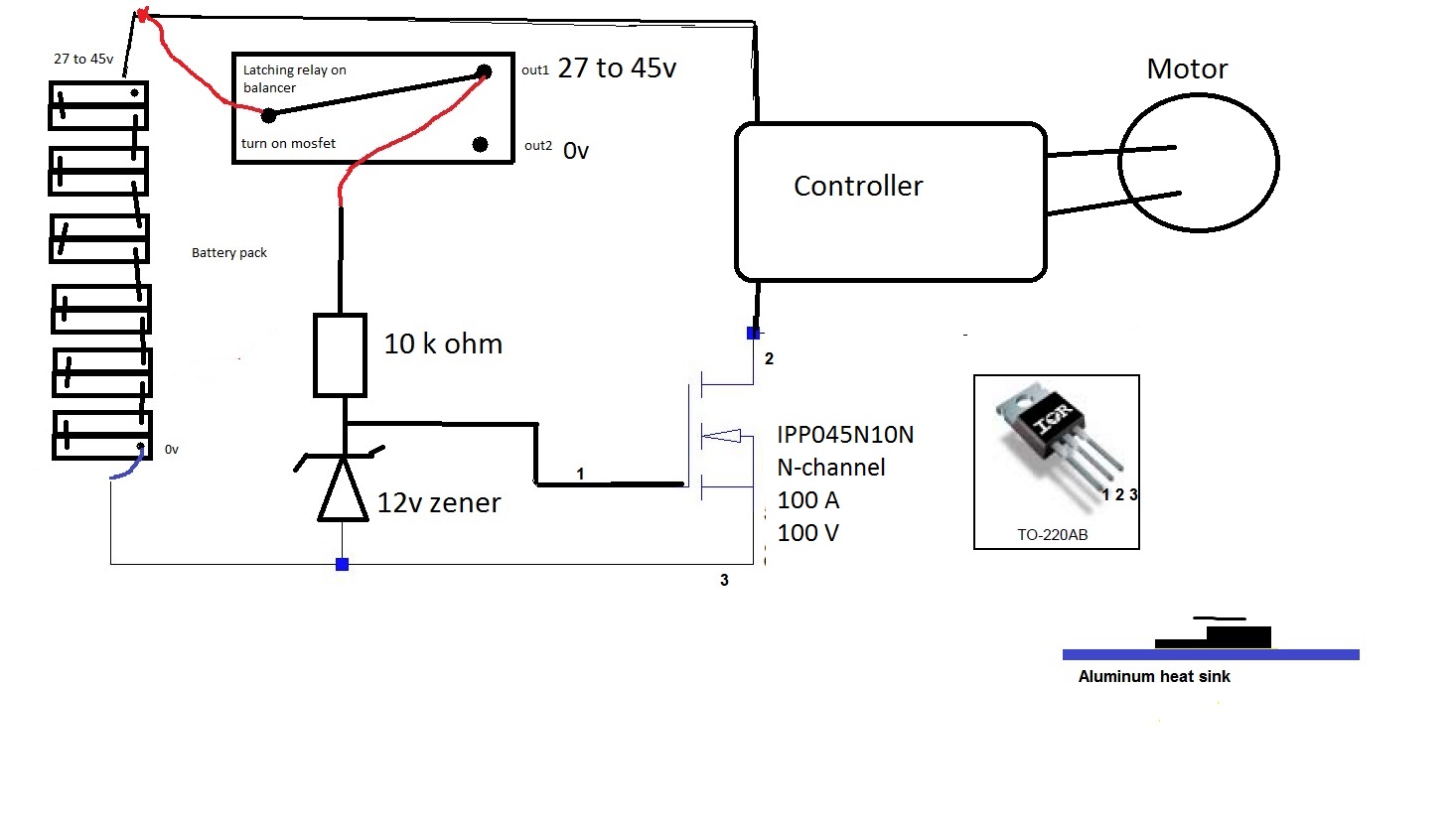

I have drawn a schematic again.
I will be using IPP045N10N: https://www.infineon.com/dgdl/Infin...n.pdf?fileId=db3a30431ce5fb52011d1e8b0cc31586
Max current drawn on my controller= 25 amp.
Voltage from battery pack ranges from 27.5v to 45v. This is also the voltage that has to give a signal to the mosfet, that it should close as a switch (open of for current running through it). It has to be fully closed, so there is a minimum resistance.
Someone said in here, that I should range gate voltage between 12v to 18v, so I tried.
-Can I do it like in this schematic? Using a zener diode?
-Or should I instead be using two resistors? 10k and 5.7k should give me an output voltage on the voltage divider, with the given voltage input (changing on battery pack), between 10v-19v. **broken link removed**
Thank you in advance

Either way will work.
Don't forget that, unless you use an insulation pack to mount the FET on the heatsink, the heatsink is at the same potential as the FET drain.
I gave zener diodes a thought also, but decided it is a bad idea because when you turn the power off, the fet needs to have the capacitance of the gate to source discharged, a zener would not discharge, use a resistor. Do you know how to check a FET? Use the diode check of your volt meter, on the N Fet, hook the black(-) lead to the source, red(+) to the drain, should be open (OL) on my meter, momentarily, just touch the red lead to the gate, then back to the drain, meter should read zero volts, now, with your finger, touch the source and the gate at the same time and the meter reading will go to 0pen. the do it again, but reverse the leads to source and drain and it will still be zero, now touch gate and source and the voltage will read around .7 volt. You need to be careful not to discharge the gate accidentally while doing this test. If you clip the leads to the fet, just leave it charged and watch how long it takes to discharge by itself.

I would suggest the gate voltage be kept to 20 max, the FET will still be turned fully with a gate of 8 volts.
in response to Alec_T, the FET does need to insulated or the heat sink need to be isolated and I must disagree about the zener, it will not turn the FET off.

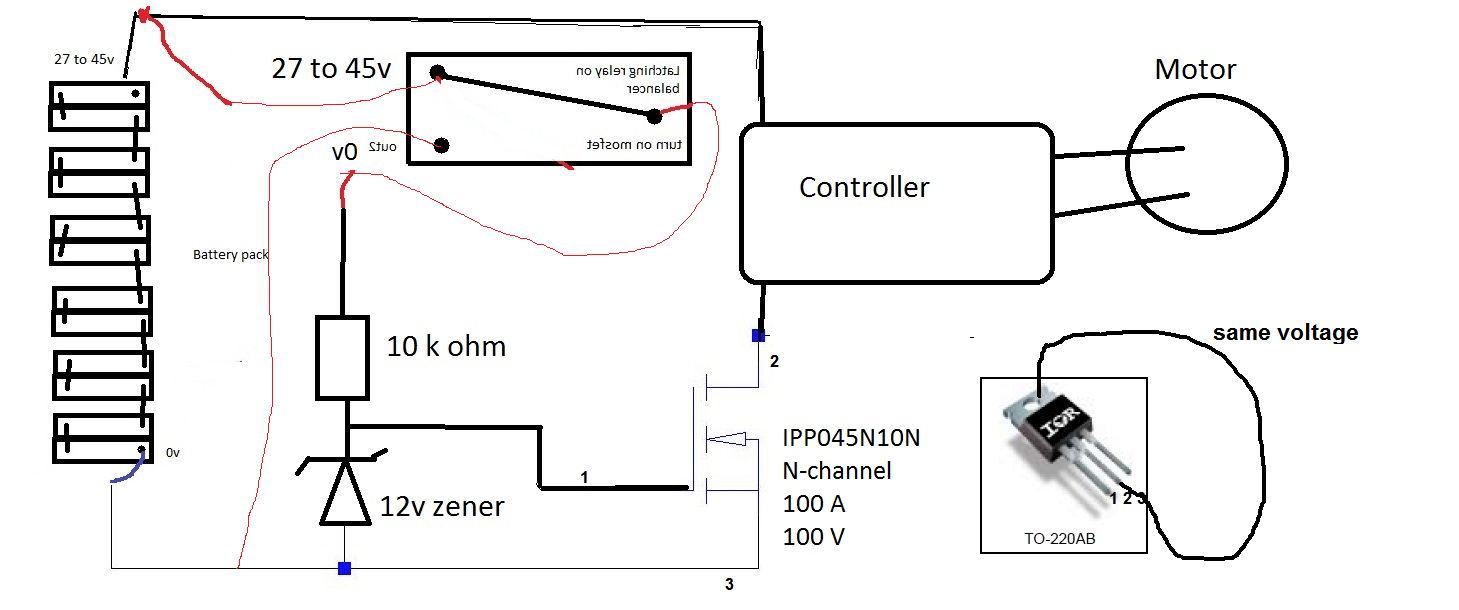

Here's the answer to " the same potential as the fet drain?" see the transistor in the drawing
This schematic would work with a zener
Here's the answer to " the same potential as the fet drain?" see the transistor in the drawingView attachment 101114
Ah ofcourse, pull down through the latch relay, good idea :)
Do you believe it turn off the FET quick enough? Or should I rather go for the resistor solution?

Yes, 10 K will be fine, that is what I use most of the time, and since at max current, the power dissipation will be 105 mW, you should be fine burying every thing in resin. I suggest you build it, try it, then bury it in resin after your sure every thing works, run it and see if the FET gets warm!
Hy kinaffi,
I would advise using two 10K resistors and an 18V Zener diode. That way you will protect the MOSFET gate from over voltage and also provide a path to 0V when the relay goes open circuit. That will ensure that the MOSFET gate is not floating and the MOSFET is not in an undefined state.

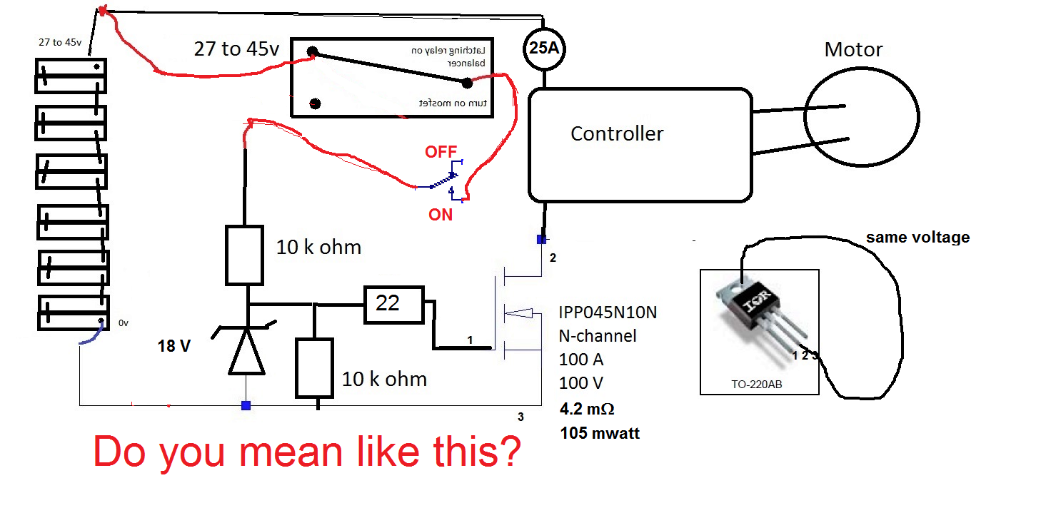

SimonTHK, is there a switch in here some where that turns every thing off for when your done with your ride ?
spec do you mean like this?

Do you always design for the highest gate voltage? I usually design for 10 +-, with this FET, it looks like 6 would actually work.
spec do you mean like this? View attachment 101117
Spot on: you have the best of all worlds there: voltage protection for the MOSFET gate and a good gate drive.:cool:
You have also protected the MOSFET gate from any spikes both positive and negative that may get into the system.
No, you rarely design for maximum gate voltage, but I do aim protect the gate from voltages of Max VGS - 10%.
The gate drive voltage to design for depends on the characteristics of the MOSFET. All you need to do is ensure that you have enough gate drive voltage to conduct the required current (ID) and have a low enough on resistance (RDS) under all conditions of gate threshold voltage variations from one particular MOSFET to another and variations of RDS with temperature.
With the IPB042 I would suggest a minimum gate drive voltage of 12V for this application. You have provided a minimum gate drive voltage of 13.5V (battery stack at 27V) so the circuit design is optimum I would say.:cool:
Also, if you are switching the MOSFET on and of at speed you need to take into account the effective capacitance between gate and source. For small MOSFETs the effective gate capacitance may be as low as 500pF but on some modern, high current, low threshold MOSFETs the effective gate capacitance can be huge, like 20nF. So if you had a 10K drive impedance, as is the case of your drive circuit at turn off, the gate time constant would be 20 nF * 10K = 200u sec.:)
One last bit of cracker barrel advice: MOSFETs are very prone to oscillate, typically between 2MHz and 6Mhz, especially if the layout is not optimum, so it is always wise to fit a gate stopper of 22R for slow circuits, 10R for medium speed circuits, and 1R for fast circuits. The gate stopper should be mounted directly on the gate terminal. A gate stopper also helps shape the waveform at the gate and also gives the driving circuit an easier time. Note that a MOSFET may not oscillate all the time but it will certainly oscillate under these conditions:

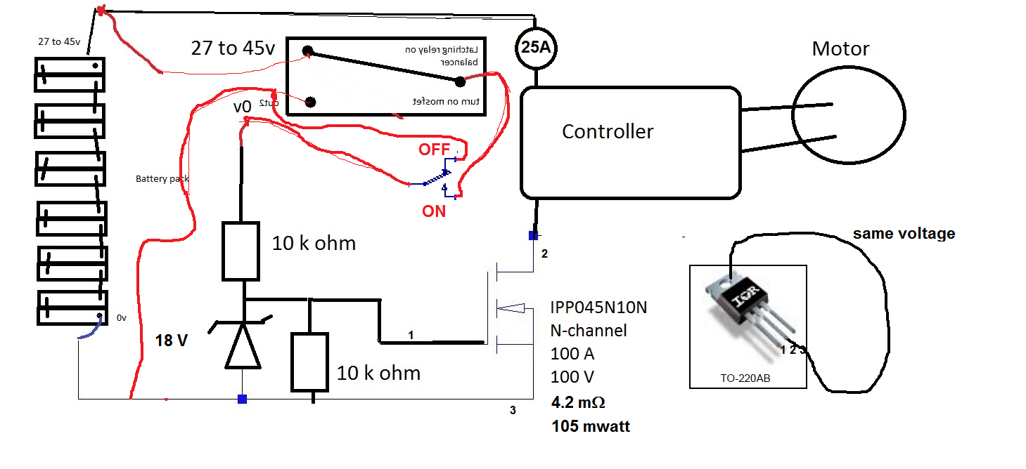

I will add a gate stopper thank you.
I come to think. The circuit that Kinarfi has made, with the pull down to 0v through latch relay and an eventual switch that also connect to 0v. Wouldnt the "newly added" 10k resistor in parallel with the zener diode pull down any float current before the gate? So that I dont actually need the 0v through latch relay and switch.
I ask this only because the wiring is simpler.
Thank you
Just happened to come across this module from Bangood, which will accept 48V maximum input, looks like it would meet all your needs?.
That would work well also, just forgot to dump it after Specs suggestion, still not sure I (PO)(personal opinion) agree with 18 v zener, I'd stay with 12V, your choice, of course, and only use this in May, June, July, and August! NO Rs
