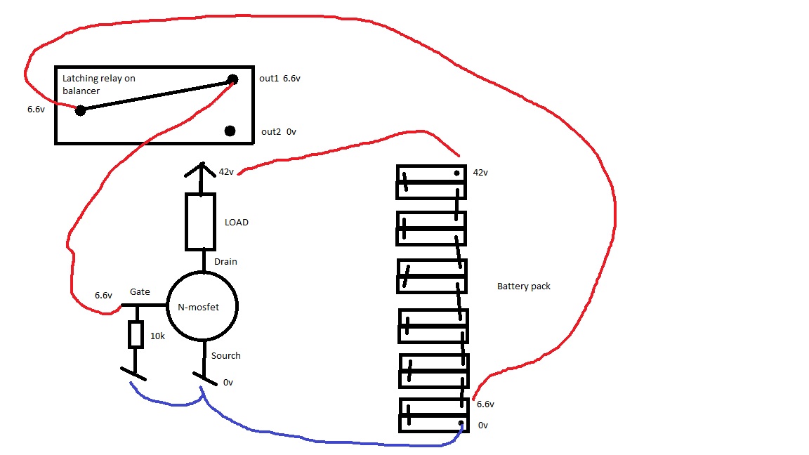

The voltage is 42 yes. It has to acces the load from the batterypack (42v charged), it does that through the relay, that switch on as soon as all the cell´s are above minimum voltage.
The idea you come up with, if understood correct. I can use an N channel mosfet with 42v connectet to drain, minus on batterypack to source, and then 1-2 cell´s (3,3-6,6v) to turn on the mosfet on the gate? Ive never ever used a mosfet before. Is it this simple? And it cost so little power so using a single cell, wont "damage" the balancing?
I dont need no latch circuit. I allready have a latching relay on the balancer, that switches state for Open/closed to a potential load. This relay can handle 2 amp´s tus why I need it to switch on something that can handle atleast 50 amps.
I tried to paint the circuit :)

That's pretty much it. I would increase the battery tap for the gate from 6.6 V to something between 12 V and 18 V. This will increase the efficiency of the MOSFET as a switch and reduce the heat it has to dissipate. I recommend a MOSFET with an 80 V rating for Vds, a current rating at least greater than the peak current it will have to handle, and use two FETs in a simple parallel arrangement: gate to gate, source to source, drain to drain. The FETs will figure out the load sharing.

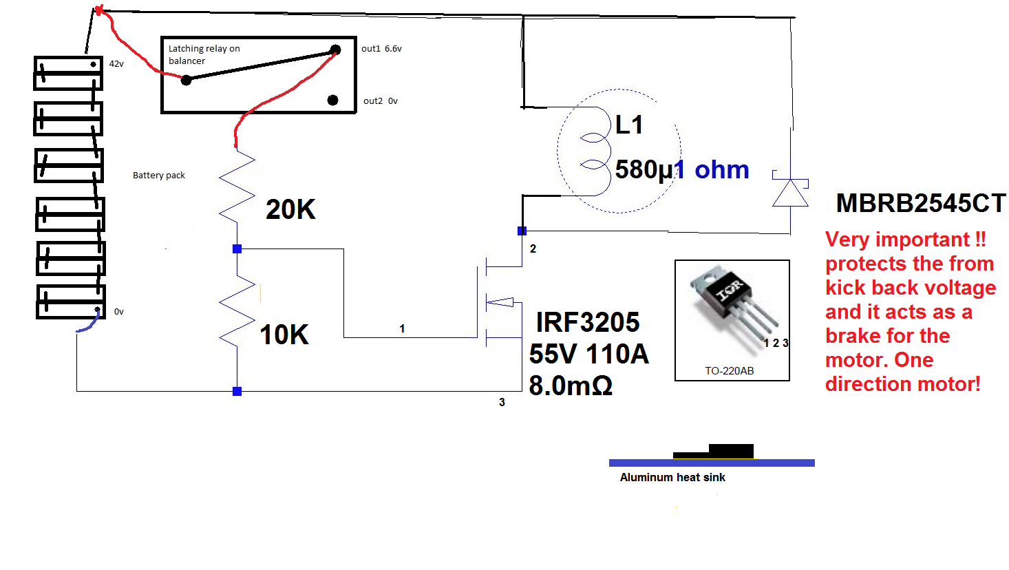

added to your schematic, one IRF3205 110 amp 55 volt FET should handle your load, voltage divider will spread the load over the whole battery stack. If your equipment has an adequate piece of metal to be a heat sink, you can mount the FET to that and insulate it if needed or mount to FET to a store bought heat sink or use piece of aluminum plate, I use alum channel fairly often.IMG_20160102_135310.jpg here's an example of using a piece of alum channel as heat sink and conductor that is isolated from the body of my vehicle.
the diode across the motor is for transient voltages
you will also need this or similar

Other bikes I've played with free wheel when power is off and rely and mechanical brakes to stop. Is this the same? The transient voltage diode will stop the motor, assuming the motor is permanent magnet with brushes.
What type of speed control does this bike have, can you post a photo?
On my drawing, it would be wise to use a STPS20M60S 60 volt 20 amp diode

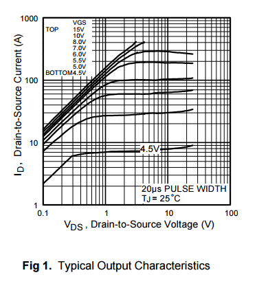

If you look at the datasheet for the IRF3205 you will see that it will start to conduct with a gate voltage between 2 and 4 volts. It will be fully on at 8-10V. At 5V (2nd line from bottom) it will have a high resistance and at 30A will have 10V across SD. Therefore it will dissipate 300W and will melt. The circuit above is putting 2.2V on the gate which may turn it on but it will be in ohmic region and will not work.
Here's the table to consult.

Hi Mike
It seems that the circuit above was using some from my schematic. The out1 6.6v was something I have written, at Kinarfi's circuit, this voltage is 42v, not 6.6v.
I think this is where we have a misunderstanding?
Do you believe his circuit would work, if it had the correct voltage input on gate?

Thank you for the very specific circuit diagram. The motor has to run free when power is not given to the motor. Will the diode prevent this, and then brake instead? I do believe the motor is brushless, since it had 3 wires in, but I cant guarantee this, but it probably am.
