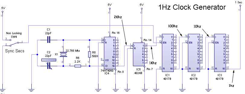

I am building a digital clock using 7 segment displays with various slave outputs.
I have used a 32.768Mhz crystal as the time standard. This is fed into a 74HC4026 using the Q14 O/P to divide by 16384 to give 2Khz.
This then goes into a 4024 O/P through Q1 to divide by 2 giving 1Khz.
I then use 3 4017s to to divide by 10 each stage to give 100, 10 and finally 1hz O/P.
My problem is the 1hz O/P is 4 secs out every min and small adjustments of the trimmer capcitor cause quite large changes in the O/P.
I would have thought the trimmer would only change the crystal frequency by a few PPM.
The values for R5 & R6 were 10M & 470k as per topics on this forum and a previous project I had built using 32.268Khx crystal.
I have tried changing the values to 500K and 2k2 as per 4060 data sheet although as the cct was oscillating this was prob not the problem.
The sheet for the crystal says the cap value should be 22pF.
Can anyone see an error in the cct design I have missed?
Is it worth trying a smaller Cap as I think the O/P is in parrallel to the crystal so the value would never actually be 22pF?
I do not have anything smaller but I could put a 47pF in series with C1 and see what happens.
Thanks.
Brett.

In general, ensure the power supplies are bypassed at the ICs, 0.1uf ceramics are good for this.
Is the oscillator running fast or slow?
If it is fast, you will need to add capacitance to the oscillator circuit, if it is slow, reduce the capacitance.

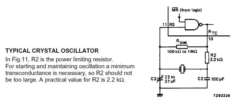

You say: "The sheet for the crystal says the cap value should be 22pF".
This is a rather vague statement, what does the crystal (data)sheet say exactly?
You have a 22pF fixed and a 22pf variable capacitor in series, that is a load of 11pF on the crystal (plus the wiring strays), this sounds too low to me.
Try increasing your 22pF fixed to 100pF as shown on the Phillips data sheet for the 74HCT4060.
The crystal Cap value is from here under Tech Data **broken link removed**

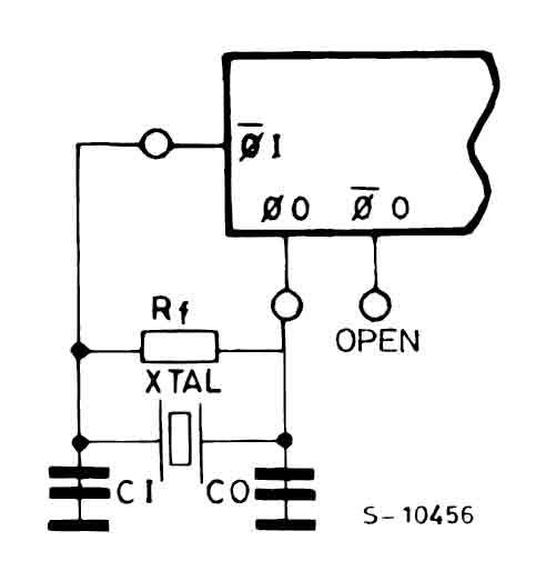

I have played around with various cap values for the fixed capacitor but not as high as 100pF as per the Phillips sheet. I think I will try a larger variable capacitor as well as some sheets say 39pF variable.
My device is made by ST their datasheet does not show any values for components and in fact omits the power limiting resistor.
I presume these devices are identicle?

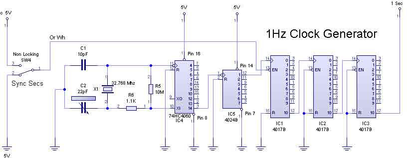

I have managed to get the cct working at last!
See corrected diagram.
It seems the power limiting resistor was too high. It worked fine for a 10MHz crystal but I found I had to reduce it to 1.1K to get the cct to oscillator correctly with a 32.768MHz crystal.
I presume this was why I was unable to get a stable reading.
I will have to run the thing for a while to make sure the capcitor values allow me to adjust the fequency faster and slower than 1Hz.
I will update this post if I have to change anything.
Thanks for all your comments.
Brett.
