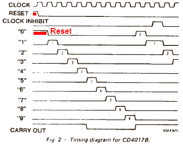

Hi all I want to know when a CLOCK pulse giving to the 4017, the outputs begin to switch ON one by one. After reaching to 10th output its again comes to the first output.
My question is let say now the 5th output is turned ON. Now I’m removing the clock pulse. What will happen to the 5th output? Is it still remains ON?
At this stage I will reset the 4017 & not giving a clock pulse. Will the first output turned ON or OFF?
Thanks a lot.
The datasheet shows the minimum duration for each clock pulse depending on supply voltage. If the clock pulse is too short then the counter will not count it.
When it is reset then the first output is high.

No.
The datasheet shows that one output is always high. When it is reset then the "0" output goes high.

The clock pin must be made high or low. If you disconnect the clock input then use a resistor to ground to make the clock input low.
If there is clock pulse it will go HIGH after reset. But if there is no pulse it will stay OFF after reset.
Which output stays OFF after reset? The "0" output is the first output and it goes high for reset. The "1" output is the second output and it goes low for reset, then it goes high for the next clock pulse.

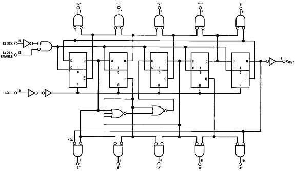

audioguru said:
The CD4017 has outputs from 0 to 9. But the internal counters are binary that count from 0 to 15. So at power-up, it randomly starts at a count which might be from 10 to 15 so no outputs are high. A few clock pulses will reset it.
The details are slightly different. The CD4017 is a Johnson counter, and has 5 flip-flops, so it can power up in any state in the range 0 to 31. If it comes up in an illegal state, there is an internal gate which will force it into one of the legal states after a few clock cycles, after which it will continue in the Johnson counter sequence:
00000
10000
11000
11100
11110
11111
01111
00111
00011
00001
00000
etc.

No, one output is on. When it is reset then the "0" output at pin3 should be high.
