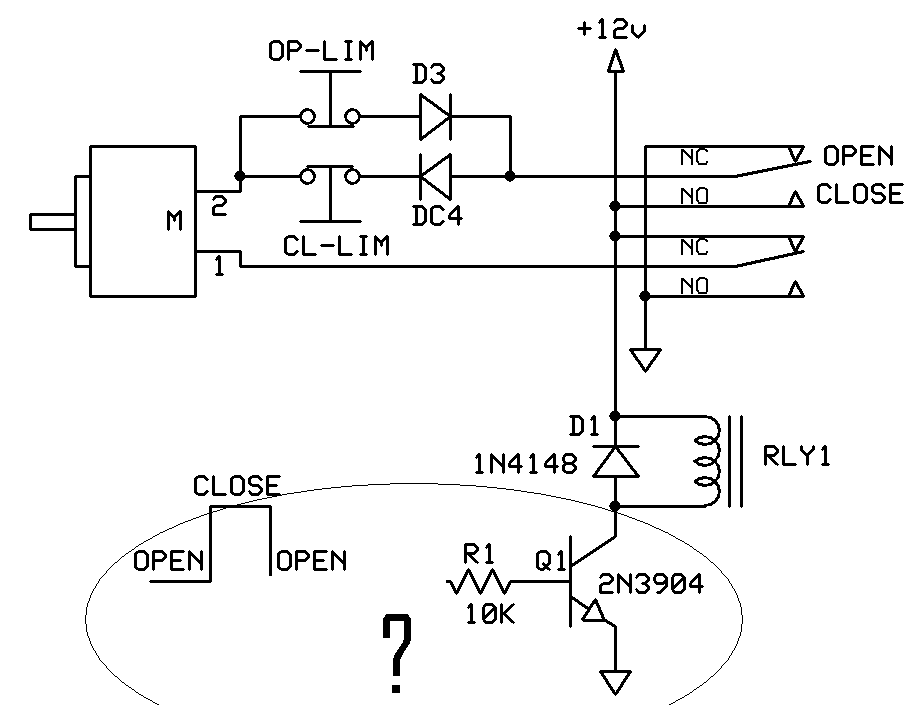

4 pole relay to reverse polarity in steps
Nate,
In my schematics, the relay coil will be unpowered during the OPENING phase(1) and remain unpowered through the OPEN phase(2). It will be powered during the CLOSING phase(3) and the CLOSED phase(4).
When you find a possible dawn/dusk detector post it. Happy hunting.
Ken
Hi Ken,
whats the point of the diode across the relay coil?
Nate,
It's called a "freewheeling" or "flyback" diode. It's there the protect the transistor. When you turn off a relay it produces a large, opposite-polarity voltage across the coil terminals. The diode shorts it out so it doesn't damage the transistor. It's not always necessary, but is a "best practices" design. For very small relays the 1N4148 is OK. For bigger relays, use a 1N400X series diode.
Ken
Ken,
As the circuit looks now I'm going to have to supply current to the coil the whole time in the close phase (I'm not concerned about the power consumption) I'm worried about the noise the relay might produce (I can live with noise for the breif time that the motor is working but if it has to stay powered all night... well :(
you think we can make this work with a DPDT "latching" relay? So that power (if I find a way to do it)only has to be applied momentarily to the coil.
Nate,
Is this speculation or are you experiencing noise from a relay? A normal DC relay should not make any sound, other than the click as it switches on and off. If it's buzzing when powered, there's probably a problem with the power supply.
Ken

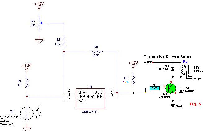

I think It's actualy going to work!!! :) :D
can you just explain to me what this part of the circuit is?
I understand is has to do with my light sensor but can you please give me a better understanding of what this exact part(s) does?
see attached,
thanks,
Nate,
The resistor and transistor are used as an amplifier to help the light sensor circuit drive the relay. A positive voltaged applied to the left end of the resistor (R1) will turn the transistor on, which turns the relay on. Zero volts on the resistor holds the transistor off, which holds the relay off.
If you look at that part of my circuit, and the right part of the circuit in: https://www.electro-tech-online.com/attachments/lightsensor-png.6712/ you will see that they are the same. (Ignoring the differences in our graphics). The added diode, D2, in that circuit is just more protection for the transistor. I don't think it's necessary.
Ken
Ken
Ken,
don't you think I should wire it so that the relay receives power in the opening phase and remains powered in the open phase and unpowered in the closed phase?
because if I use a LDR then it will allow power to pass only during the day when it's light out (when light shines onto the LDR its resistance falls)
Nate,
Just had another look at the the photo sensor circuit. Its relay is turned on when the LDR is lit. The input on my motor control was drawn before I saw that circuit. Just swap the "OPEN/"CLOSE" labels on the input signal and relay contacts, and "OP-LIM"/"CL-LIM" labels on the limit switches in my schematic. Of course the polarity to the motor will depend on the direction of rotation needed in your mechanical setup.
Ken

Looks like the relay, a 2N3904, 1N4003's, and the Microswitches should work. One of those motors should do the job...but it depends how much torque it will be required to open and close the shade.
Since you mentioned Radio Shack, they have a Cds photocell variety pack. One of these should work. CdS Photoresistors (5-Pack) - RadioShack.com
What problem occurred with the diode?
Ken
