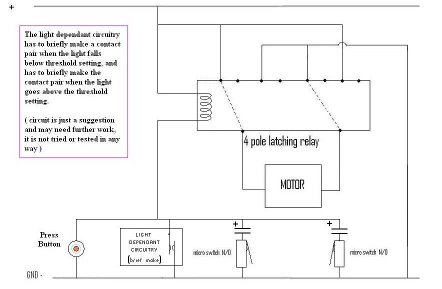

hi there all, :)

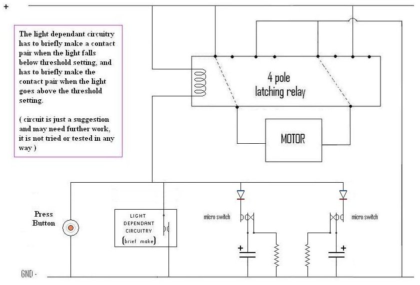

I am building a motor that has to turn a window shade, and am trying to make it automatic so that it opens when it turns light outside and closes when it turns dark.
https://i440.photobucket.com/albums/qq129/nate4548/4polerelay.jpg

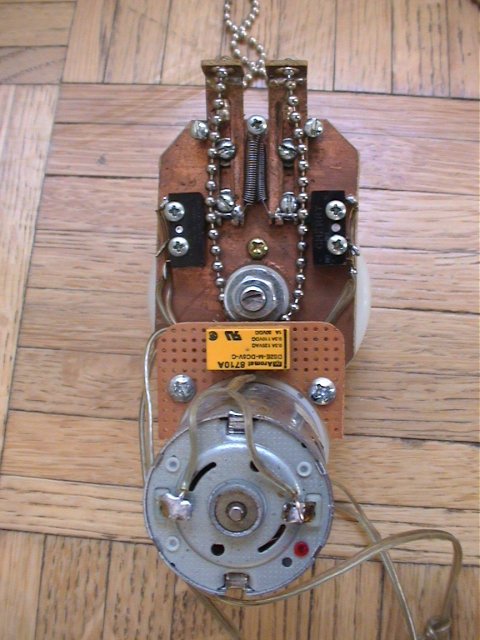

now because it has to turn only until the shade closes I had this idea of using a latching relay and microswitches
using ball chain to open and close the shade. With stops that trigger the microswitches. the stops will hit this lock with springs that moves enough to allow the stop to hit the switch but then pull it back thereby reengaging the switch.
so here's the idea I use a 4 pole latching relay, when the light sensor activates it applys positive power to the relay starting in phase 1 will turn the motor clockwise and when the microswitch disconects momentarily and then reconects, it throws the relay into phase 2 shuting off power to the motor, when power is reapplied to the relay again the relay kicks into phase 3 throwing the motor in reverse (counter clockwise) until it hits the microswitch (momentarily shuting off and suppling power again) throwing the relay into phase 4 turning it off and so on...
now I know there are alot of things that are not going to work here because I'm kind of a noobee and was just using my imagination, but... I really want this to work. and because I'm not sure of all the exact concepts.
can anbody help me out here please??
I've uploaded a picture basically of what i'm trying to do.
please see my diagram at this link

John1,
Assuming that the latching relay is a standard 4-pole/2-throw (4PDT), there is nothing to stop the motor from running. As soon as it hits one microswitch, it trips the relay and reverses the motor. The motor then travels in the opposite direction until it hits the other microswitch. It again trips the relay, it reverses direction and continues to repeat the cycle of open>close>open>close>....never stopping.
Or is there something about the relay the is unusual?
Ken
Hi Ken,
Nice to see you're still taking an interest, i will have to up my game now.
Ive tried to use the OP's diagram as much as possible, it is not the way i would have approached this circuit at all, but he says he wants to use a latching relay as shown.
And micro switches, as shown.
This latching relay as drawn, would more correctly be descibed as 2 pole 4 throw, in that it has four positions and two moving contacts. However, i have left it as shown, it makes no difference to its action what its called.
You are quite correct in that the circuit i have drawn has a fundamental flaw.
Which is that each micro switch remains closed while the travelling part rests against it.
I had thought the cap would take care of that, but it wont while the microswitch remains closed.
That also prevents the over-ride button and the light driven contacts from being effective. So it wont work like that.
I'm still thinking this through.
I will leave that incorrect circuit in place, but i might put an edit to say that its not workable.
Cheers, John :)

see my idea was that positive power would be applied to ports 1 and 7 while -ground is applied to ports 3 and 5, so when the light dependent circuit contacts then it sents a pulse to the relay throwing it into phase 1 therby turning the motor (clockwise) and qhen the stop on the ball chain hits the microswitch momentarily it would trigger the relay to jump to phase 2 (remember there is no power hooked up to ports 2 and 6) and so on.
(the light dependent circuit triggers the relay again throwing it into phase 3 (turning the motor counter clockwise) and then the microswitch throws it into phase 4.
Am I correct?
ps. John you are right about the 2 pole 4 throw. My idea was that the traveling part would not rest against the switch only the stop would hit the switch at it's time.

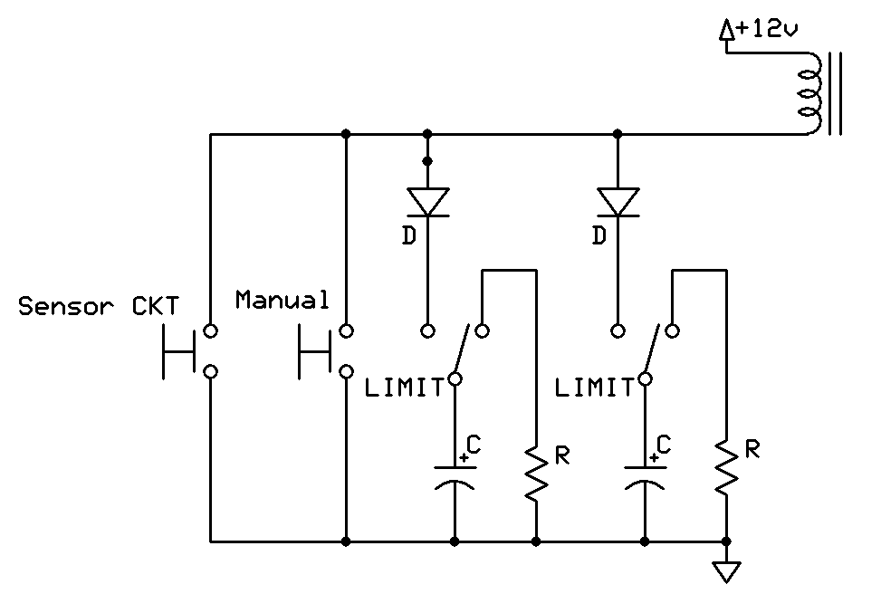

Well ive had a re-think, and this offering should be ok, so long as the caps are not too big. They have to be big enough to operate the four position relay, but not so big that they might damage the other contacts in the
event that the press button or the light driven contacts were to close. Maybe a bleed resistor would help, or maybe a low value in line with the button and light contacts.
Arrangements like this are almost certain to need some sort of over-ride button, cos curtains can get stuck, or jam very easily. Some kind of cut-out on the motor would be needed too.
I am wondering if the un-used contacts could be used to stop any over-run by wiring them as a motor short, but i dont think that over-run is likely to be a problem.
At a guess, i would say that a cap of about 1000 MFD (@ 12v) would be as big as i would care to short with ordinary contacts. In normal use, it would be unlikely to have to operate quickly enough for most electrolytics to retain much of a charge anyway. I would hope that two or three hundred MFDs would be enough to operate the four position relay.
If this assembly runs at a higher voltage then the caps would be lower values and definately want bleeds.
Better still, use a completely different approach to the relay circuitry, as shown earlier in this thread.
A four position latching relay is not how most people would make this arrangement.
Best of luck with it, John :)

Nate,
I have to agree with John:
Do you already have the 2P4T rotary relay. They are not common and are likely to be very expensive. I would recommend the cheap and easy 2P2T relay circuit.
But that said, the attached might help with John's solution. Since most microswitches are SPDT, the second contact could be used to assure the discharge of limit-switch capacitors. The resistors limit the current to an acceptable value. The diodes prevent the manual switch and the light-sensor's switch from having to pass large discharge currents from large capacitors.
Ken

I have one point to make, that the name 'latching relay' being used here is incorrect. A latching relay is one that has only two states, set and reset. A latching relay may have two coils, where the relay is set or reset depending on which coil is energized last, or one coil where the polarity of the current last applied determines which of the two states if goes to.
What you have drawn up, a relay with four mechanical states that steps with each activation of the coil is called a stepping relay. Some stepping relays have two coils, one to step one state with each application of current and a second overriding 'reset' coil that forces the coil back to the first position.
So while using the correct name for the relay doesn't help make the circuit work or not work correctly, however it should be stated anyway for the record. ;)

Hi Ken,
Again you surprise me with your ability to spot a neat solution.
I had briefly thought about the un-used contact on the micro switches, but i did not think of that. The arrangement you suggest means that it is not necessary to find the minimum capacitor that would work the coil of the four position switching relay, just any reasonable couple of caps.
We have both assumed that 12v is the most likely supply, but i dont think the OP has mentioned the power supply at all.
The light sensor has not really been addressed yet, i think that small opto-relay units are available which might just fit the bill.
Hope you dont mind me re-drawing the unit, with the diodes and discharge resistors included.
Regards, John :)
