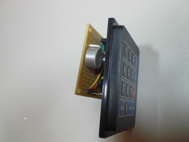

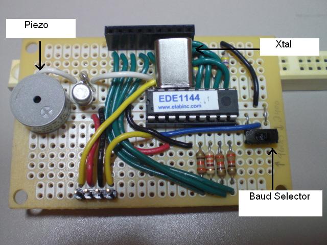

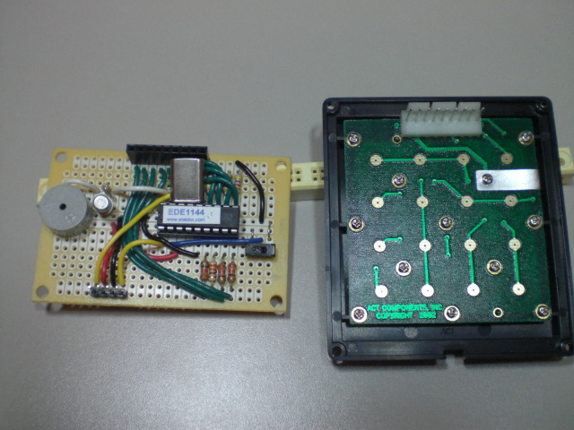

Hi
I am having trouble designing a 4 by 4 key pad circuit with an 8 bit output. I am using a straight ring counter as the shift register and either a 74LS273 or 74C922 latch for the outputs. I am having trouble connecting my logic gates (andor) to the columns for the key press detect. Any help would be grateful even just a point in the right direction.
I put together a 4X4 keypad encoder not to long ago. Here is how I did it...

With the solution I gave you could have either serial or parallel output.
Mike used a uC, the OP doesnt want to use one and is therefore rudely saying that Mike has no manners because he showed the OP a diagram using a uC
It's a 4X4 matrix decoder chip. There is no uC involved with that project. You could feed the serial data into a uC or have parallel output.
