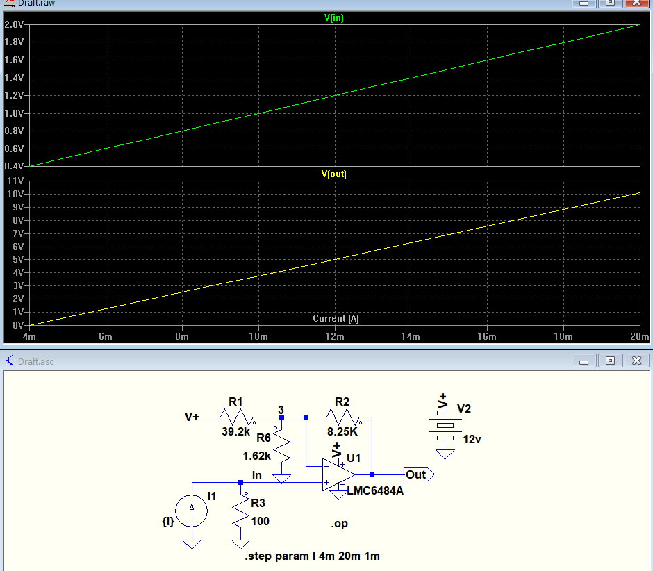

4/20mA Sensorsignal to a 0-10V Signal
Below is the LTspice simulation of a one opamp circuit to convert the 4-20mA to 0-10V:
It uses a CMOS rail-rail type op amp.
It has a 100 ohm resistor (R3) to generate a 0.4V to 2V signal (green trace) from the sensor current, to minimize the voltage required from the sensor.
This is amplified with a gain of +6.25 by the op amp while removing the offset to get the 0-10V signal (yellow trace).
