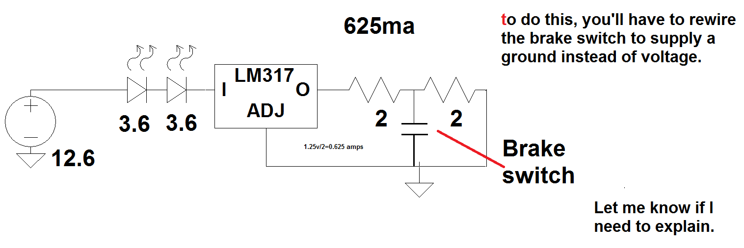

I plan on putting 2 3w led's in series and use your diagram. With that, I still only need the 1w 2 ohm resistor, correct????

Yes, 1W 2 ohm, FYI: with a LM317, it always wants 1.25 volts from output to adj and works to maintain that. With 1.25v, 2 ohms, you get .625ma*1.25v=0.78125 watts in the resistor, regardless of applied voltage as long as it is enough, however, the power dissipated by the LM317 will equal the applied voltage14.2 minus the load(7.2)(2 LEDs) times the current(.625a), so if you have 2 LEDs, the LM317 will be dissipating ~ 7v*.625a = 4.375 W.
if you have 3 LEDs(3.6v*3)or(10.8v), the LM317 will be dissipating ~ 3.4v*.625a = 2.125 W. Thus less heat from the LM317, the heat dissipation is transferred to the LED. With 3 LEDs, If the voltage dips some, the LED brightness will be slightly less, but probably not noticeable. If you stay with 2, just up you heat sink a little. 1 4X2X1/4' piece of aluminum should be sufficient, but check it to how hot it gets after it's been on for a while. for dimming for tail lites, you'll have to experiment, possibly 2 2ohm resistors in series. -- got an idea for you-- see drawing

Since your using 3 watt LEDs, My thoughts are that you will run them dimly for you tail lites and then go full on for the brake lites, full bright would be the 2 ohm, the tail lites will have a higher value that will get shorted out by the brake or turn signal. not sure how you're gonna handle the turn signals, maybe use a relay to short the resistor for the tail light when brake light and or signal is supposed to be on.------?????????

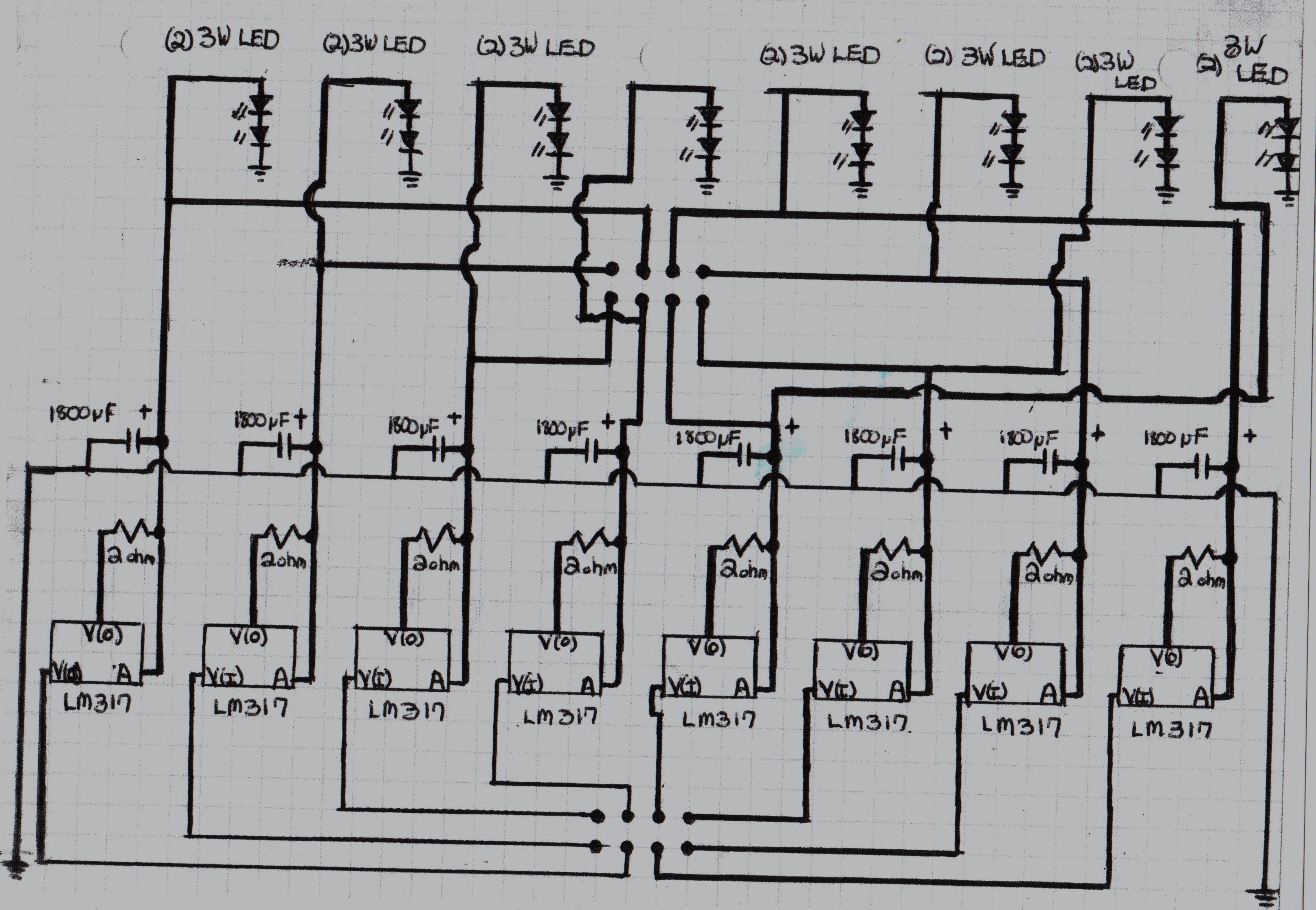

OK, so I am ready to buy my components. I made a schematic (the first one I ever drew), and I want to make sure that it will work:
The caps are there to make the output led's slowly come on and off.
The bottom section is where it will connect to my control box.
build one leg & try it
