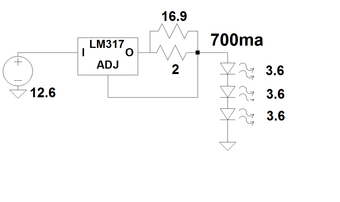

Hello all,
I am making a chaser light unit for my car and I am planning on using a 3w led. To be more specific it's a "knight rider" type of construction. The 3w led's are going to be used on the light bar only and not the control unit.
I have used a website called ledz.com which has an automatic resistor calculator.
I typed all the info: 14v, 2.2 voltage drop with 700 mA and it gave me a resistance
calculation of 16.857 ohms.
Is this correct??????

Hi gizmo13, I'm kind of dealing with the same thing, except I'm using a 10 W 12.6 v 800 ma LED, the trouble you will probably run into is that the voltage on cars varies, you have ~ 12.6 without the engine, ~ 13+ after you start the engine and ~14.4 with the engine revved up. What I would suggest is use a current regulator made form a LM317, you can probably series 3 or 4 per LM317. Take a look at my post, you'll how I limited the current, trouble is, I had to have a higher voltage to make the regulator work, but I got it.

Craig, the resistance is correct. You maybe should allow for 14.4 V, which takes the resistance to 17.4 ohms, or just use an 18 ohm resistor which actually exists. You need a resistor rating of at least 10 W.
I would use one of these:-
WELWYN|WH25 18R JI|RESISTOR, 25W 5% 18R | Farnell United Kingdom
and bolt it down to a flat area of metal on the car.
Using a resistor is a very simple way of controlling the LED current. It has the advantage of simplicity and it is robust. There will be a small variation in current as the voltage varies from 12 V to 14.4, but that is not likely to be noticeable.
The downsides of using a resistor are that the current can't easily be adjusted, but it will vary a bit with voltage. It is also very inefficient, with only 16% of the power taken from the supply going to the LED, and 84% going to the resistor.
A buck current regulator will be far more efficient, the current will not vary, and you can adjust it if you want. However, it is much more complicated and expensive.

With my 10 watt LEDs, they need 800 ma at 12.6 volt and the LM317s need about 2 volts head space to operate, so I had to up my voltage to 18+ and I am using 1 LM317 per LED. How ever, using the 3 watt LED 3.6 volt/LED at 700ma and assuming 12.6 automotive when the engine is off and 14+ when the engine is running, You can series 3 LEDs and 1 LM317 with a 1W 2 ohm resistor paralleled with a 1/4 or 1/8 W 16.9 ohm resistor to obtain the rated 700ma.

I think you're going to be surprised how bright these are, I would suggest you use the drawing I supplied, but just use the 2 ohm resistor and don't bother with the 16.9 ohm, you'll still get plenty of light and be operating a bit below max. Don't know which LEDs you ordered, but reds would be best, but whites will work with the red lense. Got another drawing coming to cover the dimmer tail light and the brighter stop light.

The LM317 that I'm using is a TO220 case, You may get away with no or small heat sink if you don't have to much extra voltage

Yes, they should be wired in series.
No, the current you want would be 700 mA. The voltage across the two LEDs would be twice as large when they are in series, but the current would be 700 mA though both.
