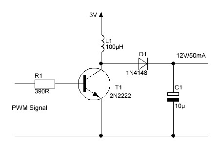

I want to boost 3V battery to 12V/50mA. Attached a sketch. No need feedback loop much.Because the boosted voltage will apply for a very limited time like 5mS then after I turn off the boost driver. If it really really needed then I can add that too.PWM driven from a PIC micro.
Need to confirm what frequency & what component values needed to make it boost to 12V/50mA from a 3V cell ?

The output voltage can not get below 2.4V. Power will flow from 3V through D1 and charge up C1. (even if T1 is removed)
When T1=on, current ramps up in L1.
I=3V X time/100uH. 3V is actually 2.8V because T1 will have some loss.
When T1 first opens up, energy stored on L1 will push up into C1. (C1 voltage can get too high with out a load)
3V will charge up 100uH slowly. Lets say 3 clocks of the micro.
12-3=9V. With 9V across L1, it will discharge quickly. About 1 clock.
What is the fastest PWM signal you can make?

Hi. Actually I'm going to use the inbuilt hardware module.
Pwm period=(PR2+1)*Tosc*Pre scale
By loading pr2=9, Tosc =1/4,Prescale=1:1 can get 100Khz.
An output current of 50 mA with a 4:1 voltage boost means that the transistor collector current will be at least 200 mA. For hard, fast saturation you will need to supply around 15-20 mA of base current.

Actually I don't know how to get to the desired voltage, What frequency to drive etc....!! To change voltage do I need to adjust duty cycle?

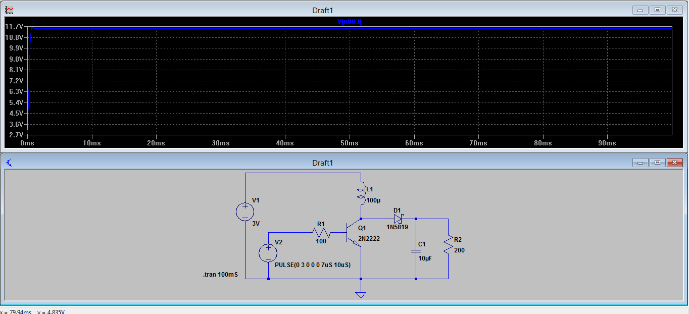

I simulated the circuit.Feeding a 100Khz PWM pulse width a 70% duty I managed to get closer to 12V. Without that load resister the voltage is rising. Is there any method to eliminate?

This supply is very dependent on load.
I would set the PWM to 1 count on and 255 off. See what happens.
Then set the PWM to 2 counts on, 3 on, 4 on etc.
At some point you will hit 12 volts.
Depending on what mode you are in it might take 3/4 on.

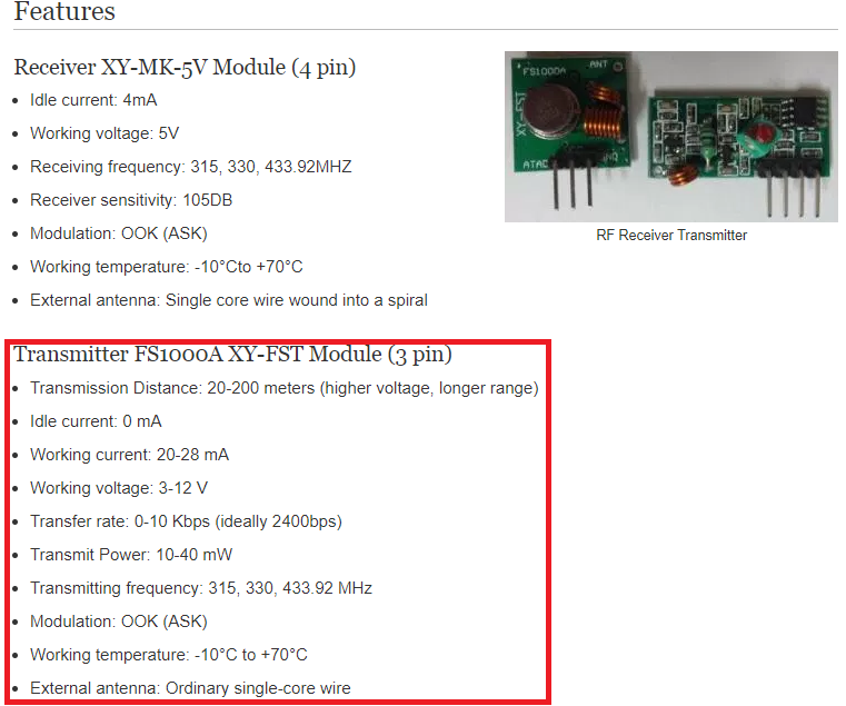

The attached RF transmitter is my load. In standby mode it does not take any currents according to its datasheet...!!!
This is my only problem.
If I connect this to my boost converter will the output voltage rise above 12V? Any precaution to avoid that?
From post #10.
You need to measure the 12 volt supply many times a second and adjust the duty cycle. If you can not do that use a IC some thing like a LM27313. Just makes 12V. You can use /SHDN to stop the part. If not used, short R3 (remove).
