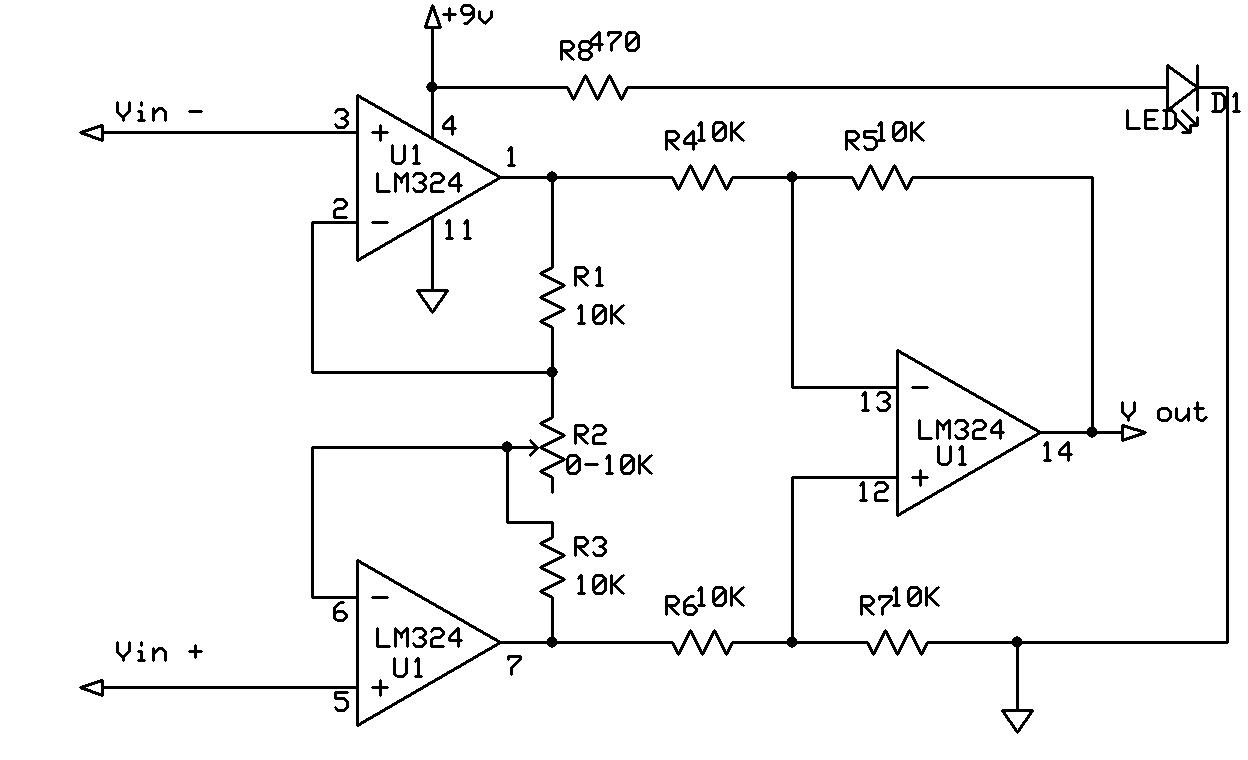

The only adjustment I have is on the gain. I put a 15 turn pot in the place of the gain resistor and adjusted it untill I got 1 volt. I have no idea if that is wrong but it appears to be working just fine.
I'll do some looking into the zero and span adjustments. That sounds neet and I could see the need for it.

Here is the schematic for what I have minus the cap (I was told I didn't need it). Can anyone tell me if I have the pot wired wrong? It seems to do the job I wanted it to do but for some reason not having part of it wired just doesn't look right.
John
John
It's correct. Wired as a two wire device it would be called a variable resistor (just two terminals required). When using all three leads, then it's used as a potentiometer (requiring 3 terminals).
Lefty

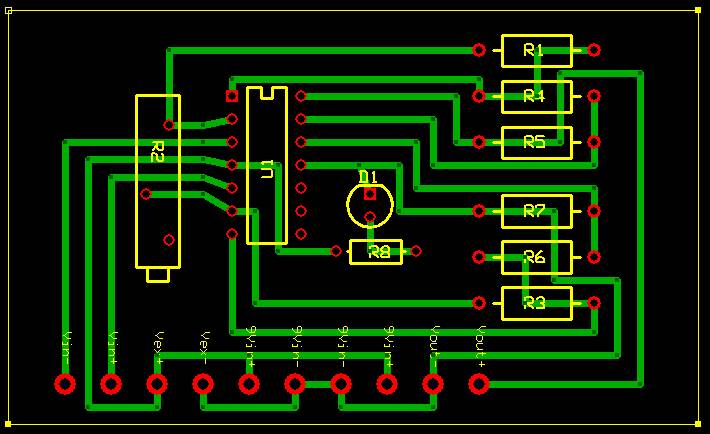

I've been playing around with the span and zero options but in the mean time I'm going to make a board with the setup I have now.
I downloaded the free expressPCB software and played around with some designs. The first one was way to compact so I streached it out a bit and I came up with something I like and I think I can work with a little bit easier.
Here is the picture of the design from the software.

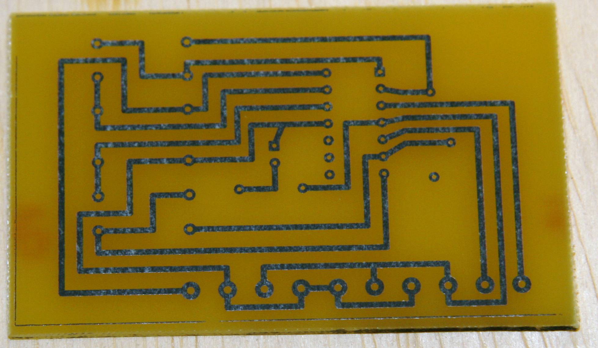

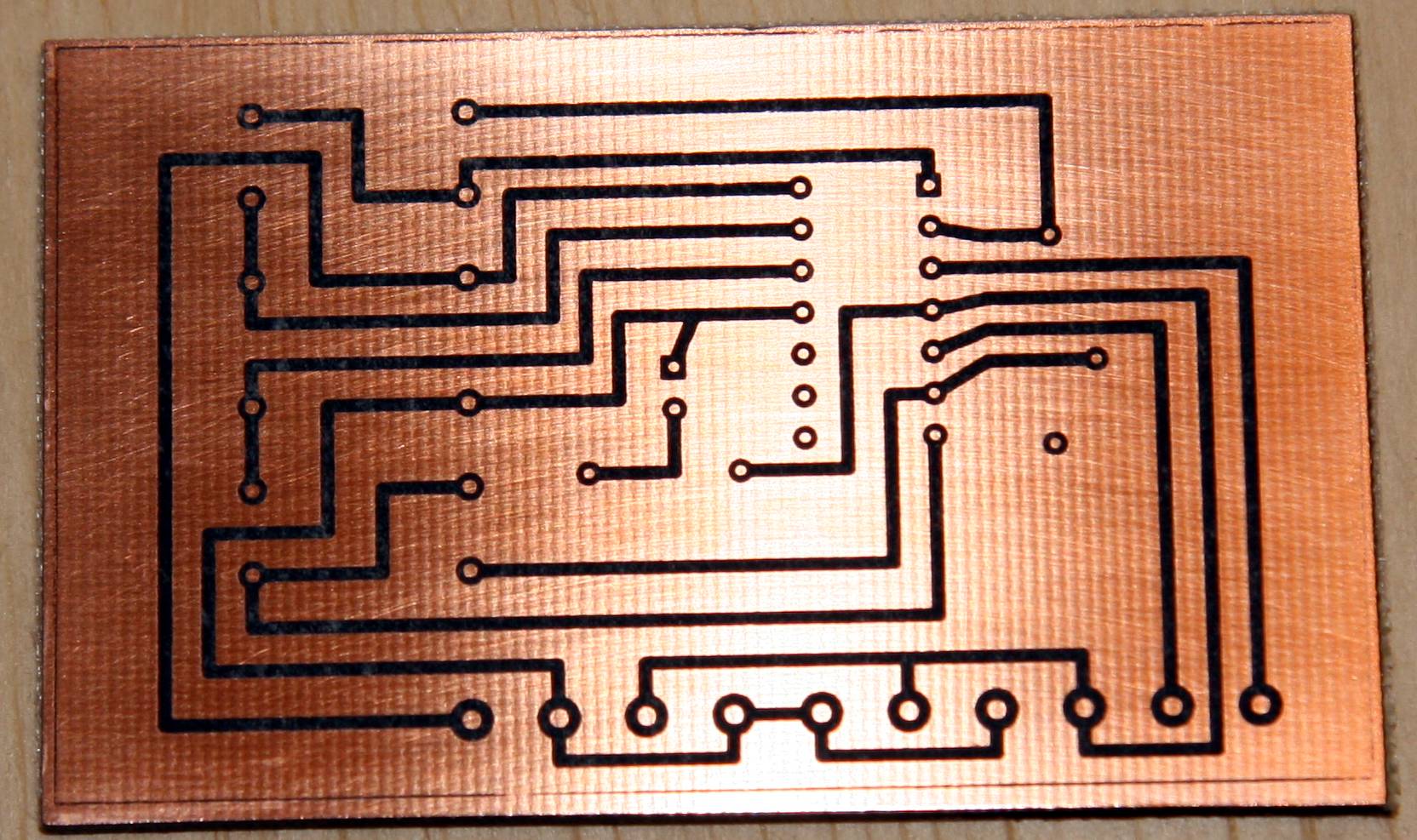

I've also been working on making that design into a board. So I found a process that works good using a laser printer and some paper I bought from a local office supply store.
Here is the process I used.
1. Use Steel wool #000 to clean the board.
2. Print the circuit design on a laser printer using office Depot Premium gloss presentation paper. (it worked good for me)
3. Tape the design onto the board. (I used Scotch magic tape, the semi-clear stuff)
4. Use a cloths iron to apply heat to the board to transfer the laser printed image. I set my iron on high and pressed hard for 3 minutes.
5. Let the board cool.
6. Mix up a batch of warm soapy water and place the board in the solution for about 20 minutes.
7. when the paper is fully soaked rub the paper off and then use your fingernail (lightly) to scrape off the paper from around the lines and inside the holes.
When your done it should look someting like this.
Next i'm working on etching it. I'll post some pics when I'm done with that too.

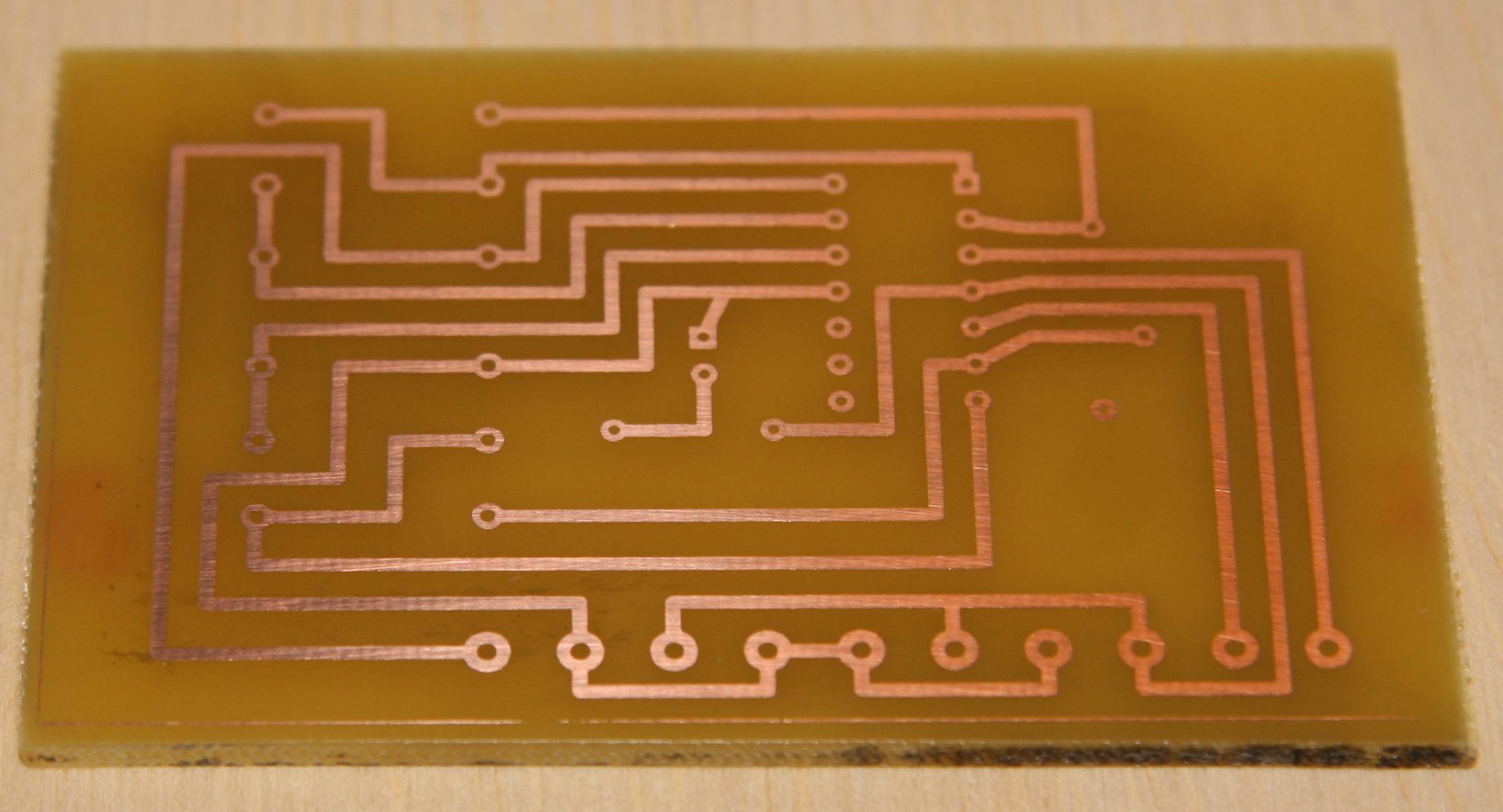

I finished the board tonight and I'm posting pictures of the board.

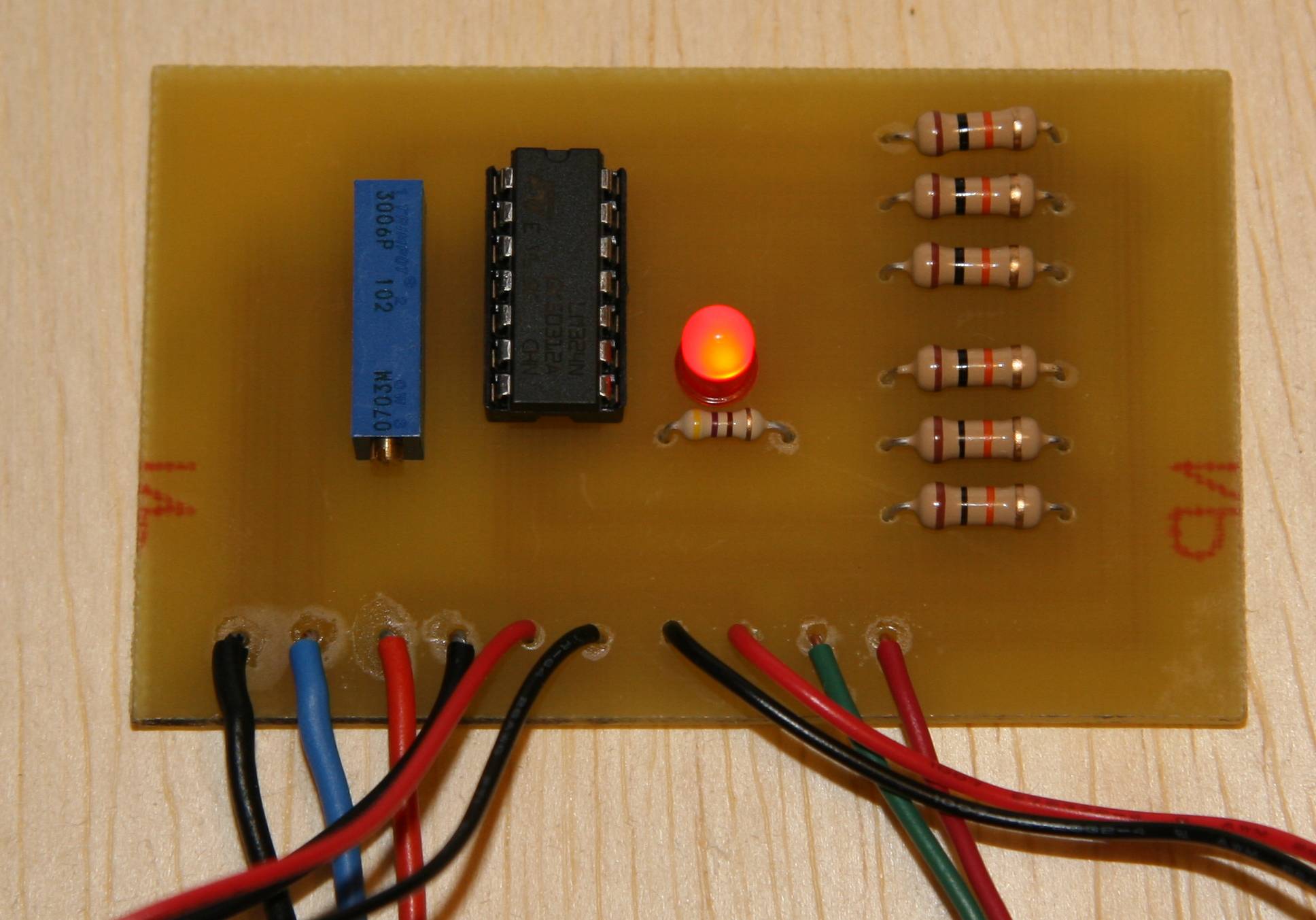

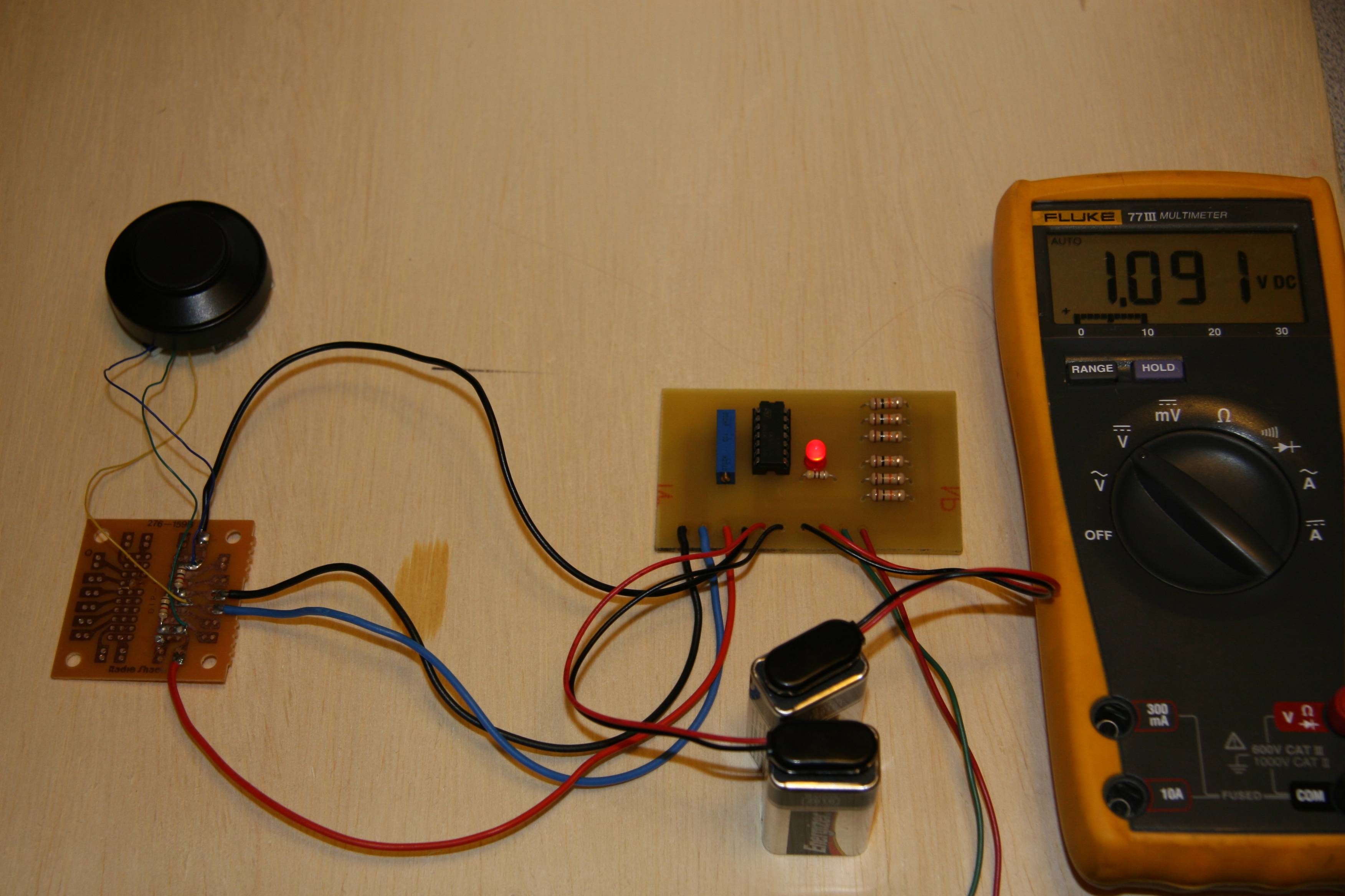

Well, Its all finished and wired up and some how it works.
Here are some more pics of the completed board.
So the next step is to make an analog to digital converter to process the analog voltage and send it to the computer.
