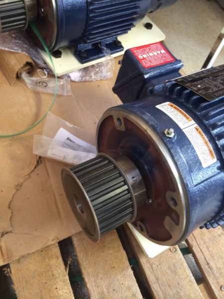

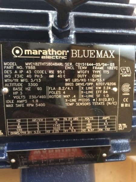

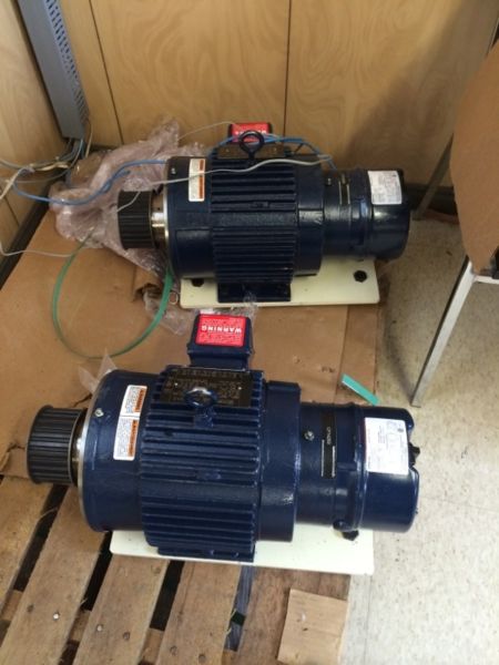

Anyways... Check out the motors I just picked up. 80$ for 2 of them brand new... One of the reasons I chose to work with a SCIM and not a permanent magnet or wound rotor motor.. these can be found extremely cheap! They won't be powerful enough for a full size electric vehicle, but they are big enough that I can build a VFD to run some tests with, get some data, and learn from for when I scale up to a larger motor.
